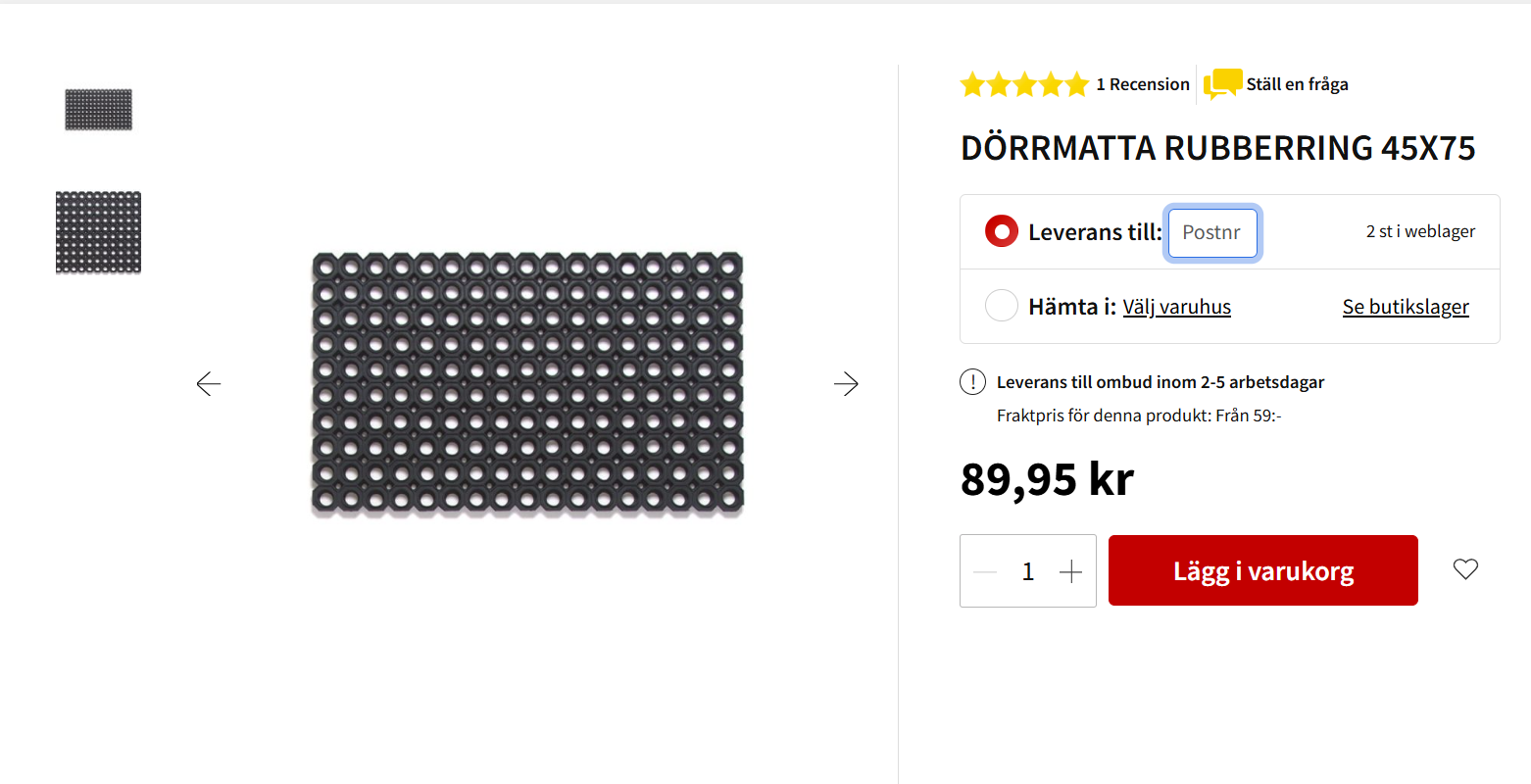

A Cheap and Huge Upgrade of my ATC 150: A €10 Rubber Door Mat Transformed My Speaker Sound  (co-author: ChatGPT)
I just had one of the most unexpected and rewarding upgrades in my audio journey — not from cables, amps, or DACs — but from a €10 rubber door mat designed for entrances.
Yes, a door mat made my system sound cleaner, tighter, and more focused. Previously I was amazed by low volume performance of my speakers, now the same feeling with very very loud as well.
What I Did
I bought this rubber mat from a local store (see image below). It’s heavy-duty, textured, and designed for outdoor use.
I cut it into two long strips per speaker.
Each speaker (75 kg each!) was tilted slightly by placing:
Front edge: raised by 2 cm
Rear edge: raised by 1 cm
This means the speaker base contacts only the rubber strips at the front and back — not the whole surface.
Source: Bauhaus.se - Rubber Ring Door Mat 45x75cm
What Changed in the Sound?
Immediately noticeable improvements:
Bass became tighter and cleaner — no more low-end smearing.
Mid and high frequencies opened up and smoother — more clarity in vocals and cymbals, and I want to listen very very very loud.
Imaging and soundstage became more focused.
The overall presentation felt more “locked in” and effortless.
Why This Works (Not Snake Oil!)
Vibration Isolation
Rubber has natural damping. It isolates cabinet vibrations from the floor and vice versa.
Reduced Coupling
Only two narrow contact points (front and rear) reduce energy transfer. Similar to what €500 isolation feet aim to do.
Surface Texture for Micro-Diffusion
The honeycomb and bump pattern helps diffuse some boundary reflections, subtly improving upper frequencies.
Slight Tilt for Acoustic Alignment
Raising the front tilts the tweeter axis closer to ear level, often improving high-frequency clarity and coherence.
Final Thoughts
I was honestly shocked. A door mat — meant for wiping shoes — gave me a more satisfying improvement than some €400 DACs or cables.
This tweak is:
Cheap
Reversible
Physics-based, not voodoo
So if you're running floorstanding speakers on wood, tile, or concrete floors — give this a try. You might get one of the best price-to-performance upgrades you’ve ever heard.
DIY Tip Recap
Use dense, textured rubber, not foam.
Cut into long strips, don’t cover the full base.
Aim for two-point contact: front and back.
Try a slight tilt to adjust your tweeter axis.
Another name for that rubber matting is "anti-fatigue matting" they are 7/8 inch thick and used in all sorts of settings. Interesting outcomes putting it under your ATC loudspeakers.
Cheers
