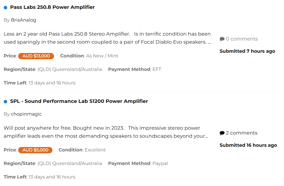

However, you are lucky - either of these power amps currently in the SNA classifieds would do a great job:
However, as Chris pointed out ... you will need a preamp with either of these power amps.

I would suggest neither of the two amps I listed, will fall short in getting your Gales to give their best.

However, the power amps in the SNA Classifieds will do a better job, IMO.
