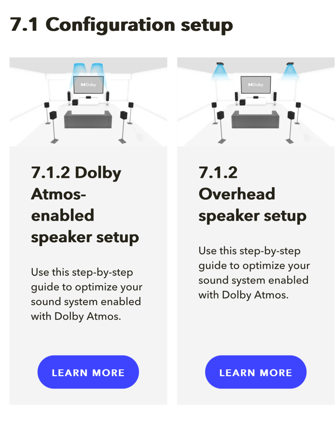

Getting down to it - my question is am I better off having the rears and heights as the .4 in a 5.2.4 setup, or just the (blue) heights as atmos and leaving the orange ones as the rears and surrounds in a 7.2.2 setup?
Or perhaps something else? I'll be running these off an Anthem AVM60 if that helps.
I've read a lot of mixed recommendations for non-perfect rooms, and the Dolby guides aren't that helpful in my instance.
I mean if Dolby can recommend upfiring speakers bouncing of the ceiling, then I don't get why in-ceiling directional speakers are all that bad - and better than no speakers!

Exactly this! I did use the words “very compromised space” in the post title.
I understand what’s best practice —well I TRY to as even though the Dolby guides (https://www.dolby.com/about/support/guide/speaker-setup-guides) show 33(!!!!) different Atmos configurations — they show down firing speakers in a 3D image but not in the more detailed 2D one with explanatory wording As seen in these example images:
And for the above, they don’t explain the difference even though they both still mention Atmos in the smaller print but only in one heading.
Here’s what I mean:
in that image I count 8 speakers including the sub. But 5+1+4 adds up to 10. And in the explanatory wording below the image it only talks about 8 speakers as well. No mention of heights.
Plus, WTF is this and how would this sound better than my proposed install given that every pen of the .4 speakers are firing at the ceiling and reflecting back??
Given people don Atmos with wall and ceiling bouncing, sound bars (!!) etc I was trying to ascertain if it’s all or nothing. Absolutely no middle ground like Betty Boop and all the purists on AVS say.
eg Would compromising by including heights muddy the sound, create confusion, or sound just plain awful?
Here’s hoping it will be all good. The biggest takeaway I have from this discussion is to have the rears directed at MLP rather than firing forward (which was Dolby’s recommendation).

what that is .. is top firing modules, or speakers with top firing speakers ... yes they exist for folks that cant ceiling mount.. but can do floor standing speakers...
the bouncing sound around place is pretty hit and miss ... it requires ceiling and sound bouncing off angles to end up in your ears somehow .. in my experience of exploring as much 3D audio as i could .. thats what i worked out it doesnt really work,
things like sounds bars trying to fire sound around room dont actually work either .. not when you have heard what 3D audio is trying to achieve with height speakers....
