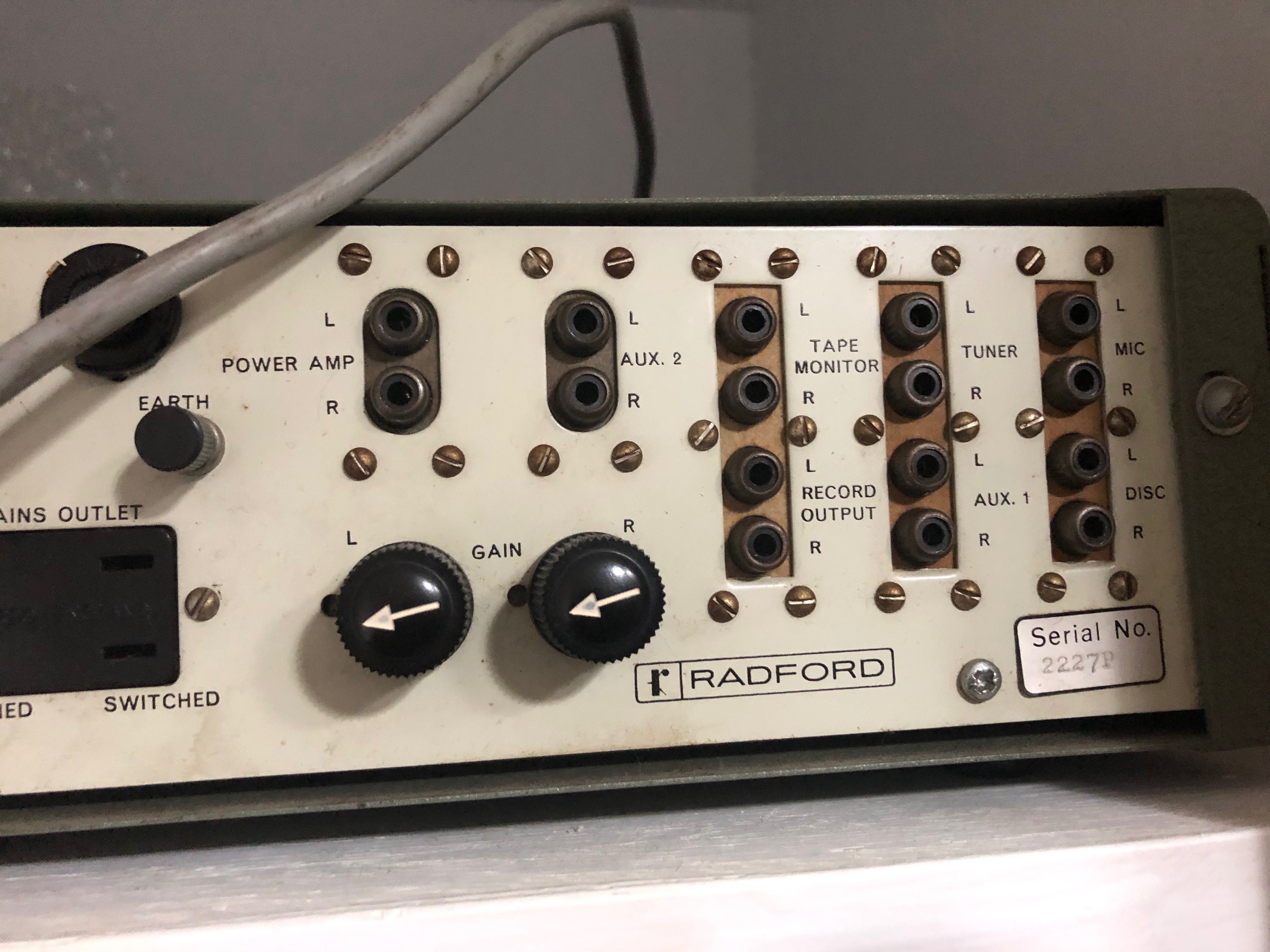

muon* Posted November 30, 2024 Posted November 30, 2024 (edited) 11 minutes ago, RockRolley said: Any sonic preference between the polymer or metal body version? Is the metal version slimmer than polymer? For one project (Radford SC22P) the rca inputs are incredibly close together and so far have only managed to get cheapo standard plastic ones in there. Wider is fine for other purposes. I think they are about the same, I ordered the polymer ones normally but got sent those metal ones from an ebay seller. The Polymer ones would be better if there is a chance they will contact each other with the Radford. even though if terminated correctly without the earth touching the barrels it should not matter. Just means if you use the metal barrel ones you need to cover the earth connection inside them with heat shrink. Should be no sonic difference given the barrel is not part of the connection. Edited November 30, 2024 by muon*
RockRolley Posted November 30, 2024 Author Posted November 30, 2024 16 hours ago, muon* said: https://www.audiophonics.fr/en/rca-connectors/elecaudio-te-rc85s-rca-plugs-tellurium-copper-gold-plated-o85mm-pair-p-9045.html Probably from the same supplier, (AECO is a major supplier of connectors to the industry) Sleeve is cotton/nylon, I used the 12mm size, but then I had the bulk of the two cotton tubes to cater for. https://www.aliexpress.com/item/1005002904909707.html Thanks, I’ve bought audiophonics gear before and been VERY happy
