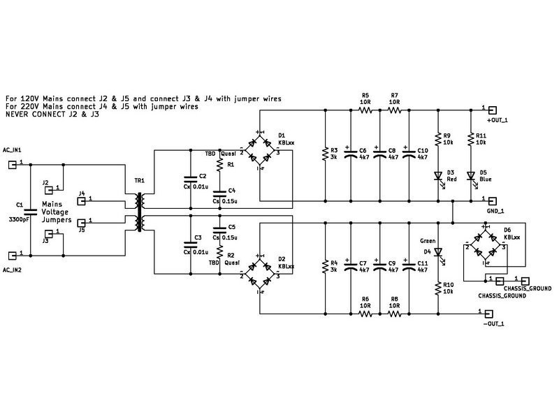

Preferring to buy local.. can anyone suggest an Oz biz that sells quality components please, someone with plenty of ready stock? I'm after some 3k, 1w metal oxcide resistors for a PSU

3k is out there but not quite run of the mill like 3.3. The rail voltage may differ
Prefer the project stays on spec.. thanks all the same
Ele 14, Rockby noted 👍. Tried RS but that was RS
Edited by Allan
Sorry about that - the on;ly 3kR resistor on the circuit diagram is the R3 and R4 and they are just drain resistors before the first filter caps C6 and C7 - won't make any different at all if they're 3k0, 3k3, etc metal film, metal ixide, 2 x 6k0 in parallel, etc - an entirely 'non-critical' comnponent but the big question is "why does it need replacing, eh"?   What circumstance/demand caused this resistor to fail?

Ok just capacitor drains. Good pickup, my bad... these bloody new glasses of mine!
Anyway i found some 3k MOX on fleabay and have some being shipped now.
No not replacements, it's a new build psu for the Pass Pearl 3 phono
