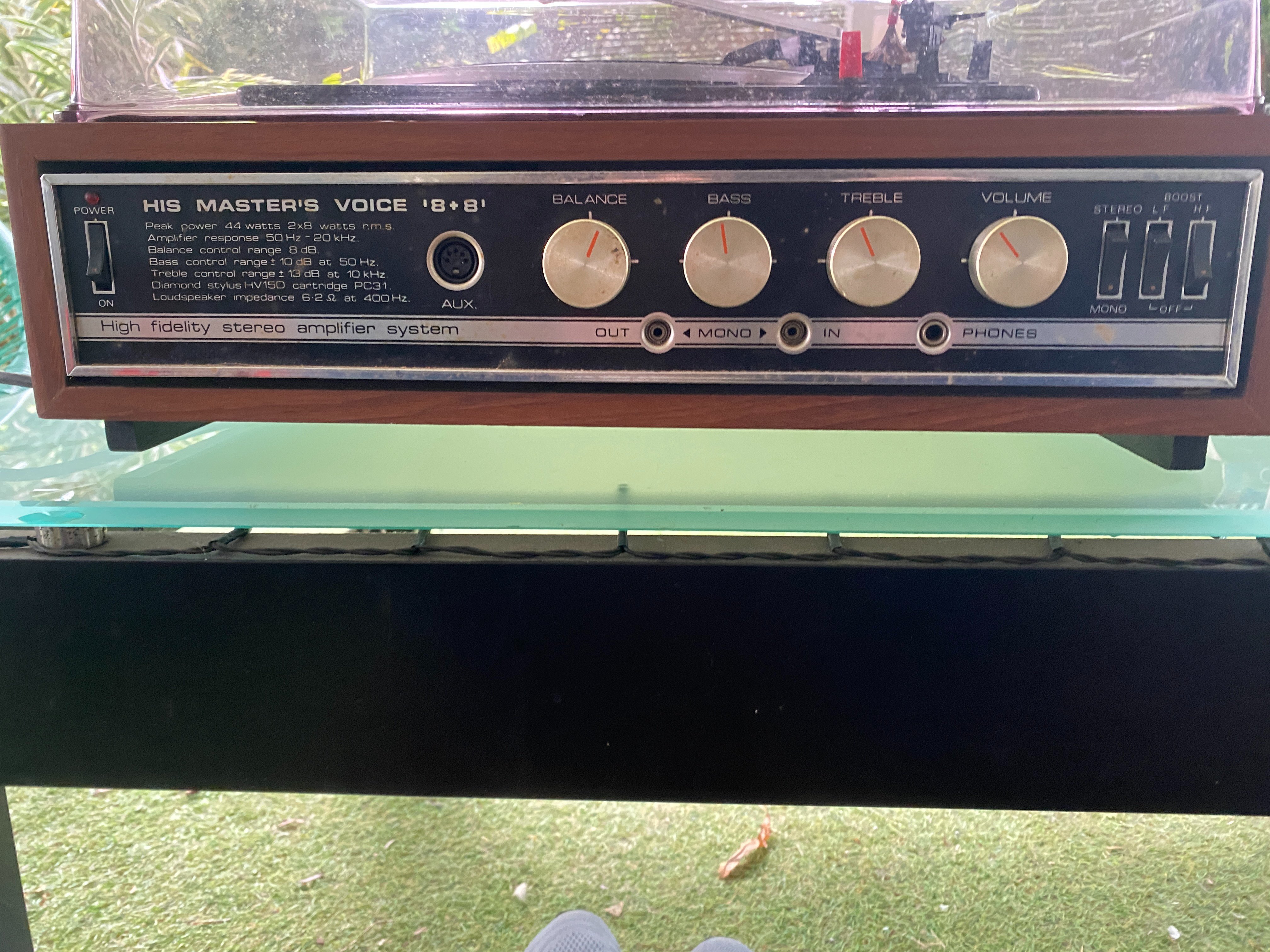

hmv88 Posted August 1, 2024 Author Posted August 1, 2024 I have purchased a HMV 8+8 turntable with a Gerrard 2025 TC turntable. All is going well so far. Have some original speakers arriving and have sourced a new diamond tip stylus. Sounds awesome with the speakers I have, though the auto switch off and return is not working I have the diagrams to service that and have learned how to lift the platter off. What I can't find, and not from the lack of looking, is how to get inside the body of the cabinet. I need to access the 'guts' of it to tighten the wires to the back of the volume control, as I have had to put a rubber bung behind the volume control to pull it out slightly to play lower volume. My question is; how to I pull the main body, or access the main body of the player? It is a 1970/1975 circa model. Any help would be greatly appreciated.

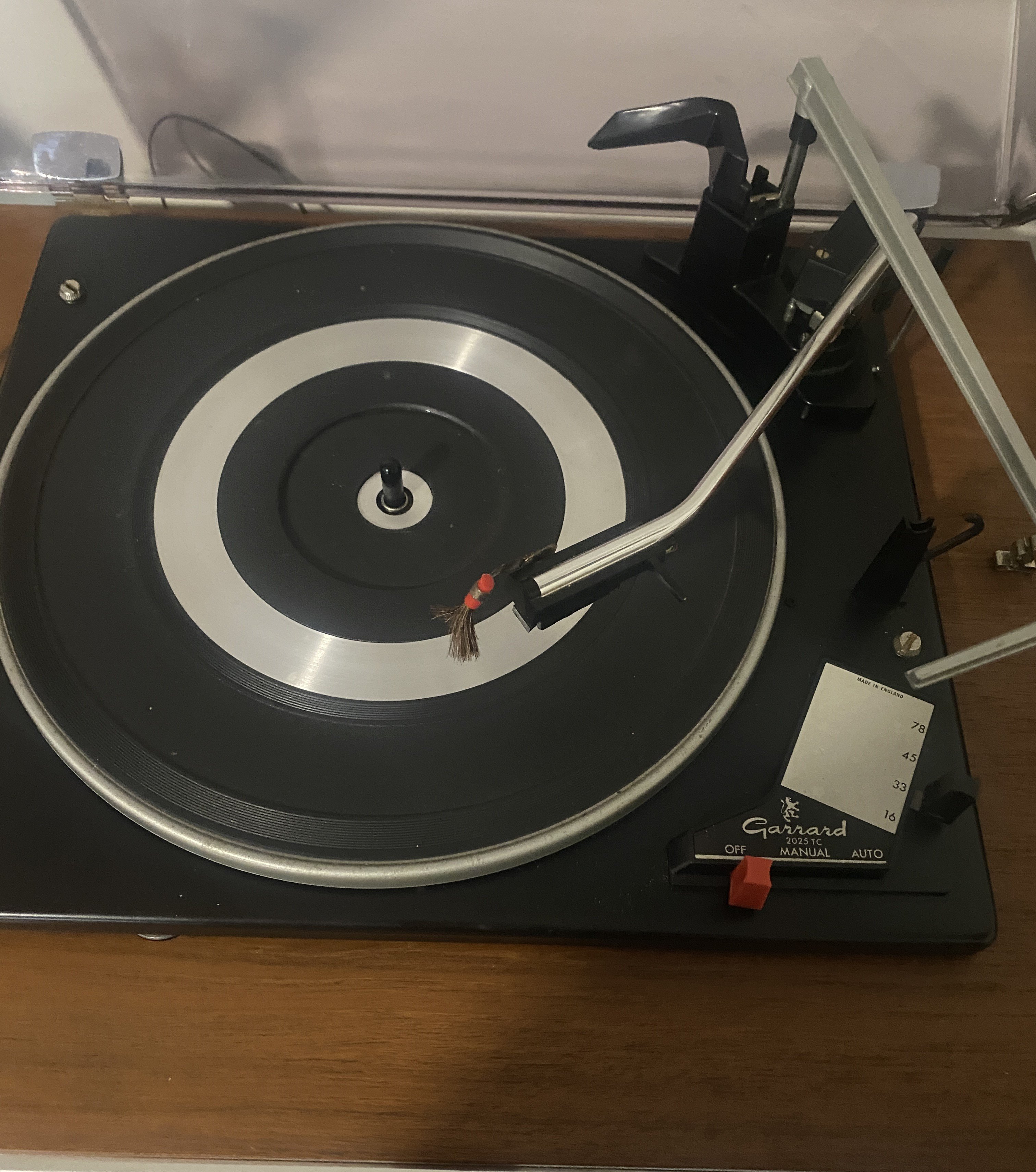

hmv88 Posted August 2, 2024 Author Posted August 2, 2024 Thanks for your help so far and your patience. Here are some pic's of the model I have. The transport screws (2) can be seen. I can't see any clips when I pull the turntable up as far as it will go and they refuse to screw out any further. Hopefully the pic's will give a better idea. I love the sound and look of my HMV, so I am committed to getting it working 100%. Is there anyone you can recommend near me, if all else fails, that can repair and service my HMV. I am between Brisbane and the Sunshine Coast QLD.
aussievintage Posted August 2, 2024 Posted August 2, 2024 (edited) They are at the bottom of the screws. In the picture below, the clip has been flipped to vertical ready for removal. When vertical it will fit through the hole in the wood. Edited August 2, 2024 by aussievintage
hmv88 Posted August 3, 2024 Author Posted August 3, 2024 Okay, I can pull the deck up as far as it will go and get a small screw driver in to try to flip the clip but not having much luck. I understand what needs to be done, but can't seem to get it to flip. Slightly frustrating. If you give me one more pointer as to how to flip the clip, that would be great. Otherwise I think I will have to 'retire' defeated.
wartman Posted August 3, 2024 Posted August 3, 2024 You normally access the clips from the rear, or the bottom of the box the turntable sits in. You may need to remove the rear or bottom cover.
hmv88 Posted August 3, 2024 Author Posted August 3, 2024 Unfortunately there is no way to do that on this model.
audiofeline Posted August 3, 2024 Posted August 3, 2024 I don't think the transport screws are used to secure the turntable to the plinth. The transport screws are used to lock the platter for transportation to protect the bearing. So they lock the platter or free the platter, and the screws remain on the turntable. Servicing of the turntable would be via the underside of the plinth, probably after the amp is removed.
aussievintage Posted August 3, 2024 Posted August 3, 2024 46 minutes ago, hmv88 said: Okay, I can pull the deck up as far as it will go and get a small screw driver in to try to flip the clip but not having much luck. I understand what needs to be done, but can't seem to get it to flip. Slightly frustrating. If you give me one more pointer as to how to flip the clip, that would be great. Otherwise I think I will have to 'retire' defeated. Lift the opposite side of the deck and push down on the screw with the clip. There needs to be room for it to pivot. Also note that they only flip one way.
aussievintage Posted August 3, 2024 Posted August 3, 2024 2 minutes ago, audiofeline said: I don't think the transport screws are used to secure the turntable to the plinth. The transport screws are used to lock the platter for transportation to protect the bearing. So they lock the platter or free the platter, and the screws remain on the turntable. Servicing of the turntable would be via the underside of the plinth, probably after the amp is removed. No these screws lock the whole turntable chassis down but also secure it when it is sitting on the springs. To remove it you need to do what we are saying. 1
hmv88 Posted August 3, 2024 Author Posted August 3, 2024 Okay, will give it a last shot. Thanks everyone.
audiofeline Posted August 3, 2024 Posted August 3, 2024 13 minutes ago, aussievintage said: No these screws lock the whole turntable chassis down but also secure it when it is sitting on the springs. To remove it you need to do what we are saying. OK, thanks for clarifying, it's important to get the facts correct! 1
