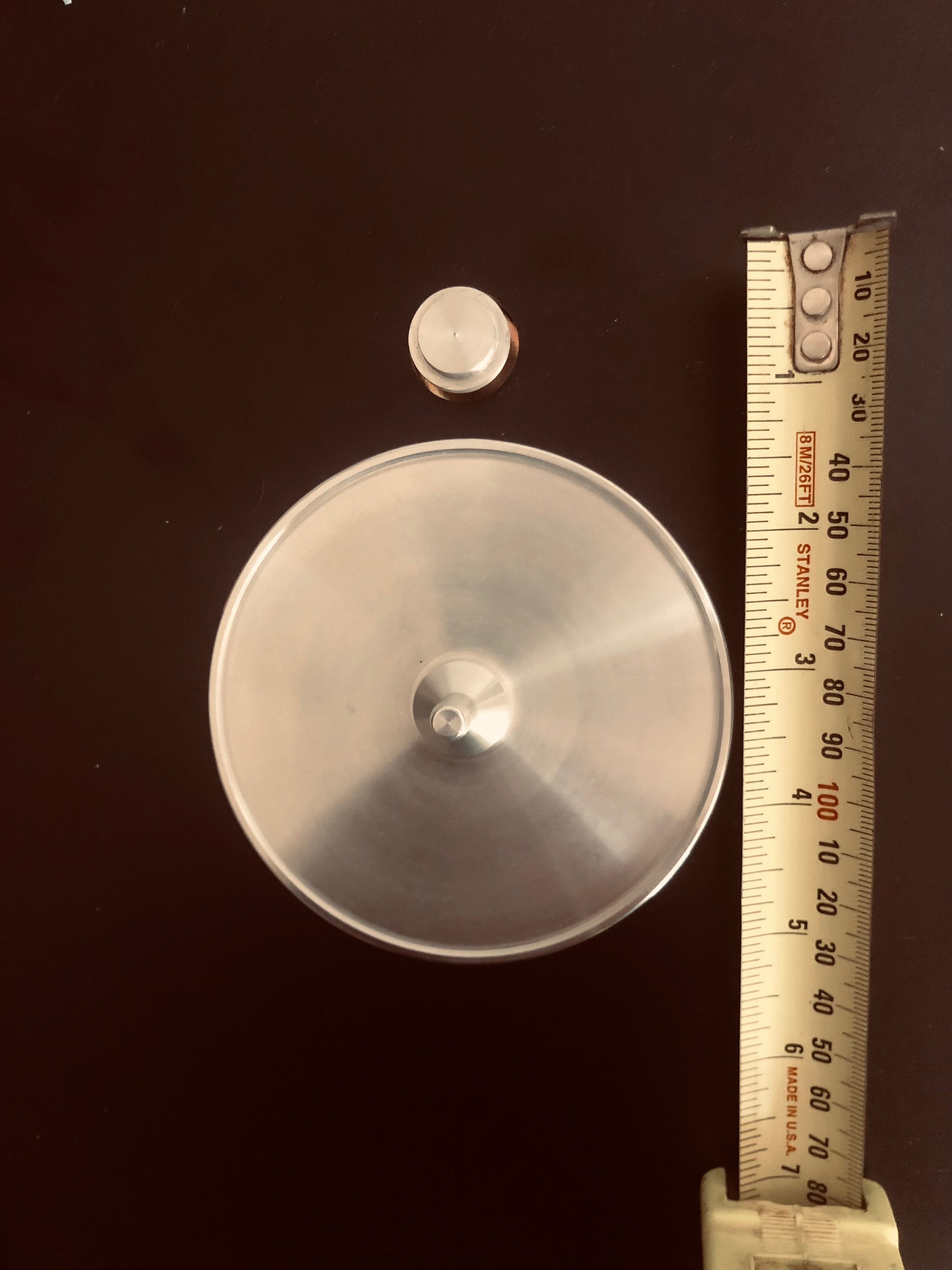

The broken belt is 320mm long, not allowing for any stretch over time, and is 2mm in diameter

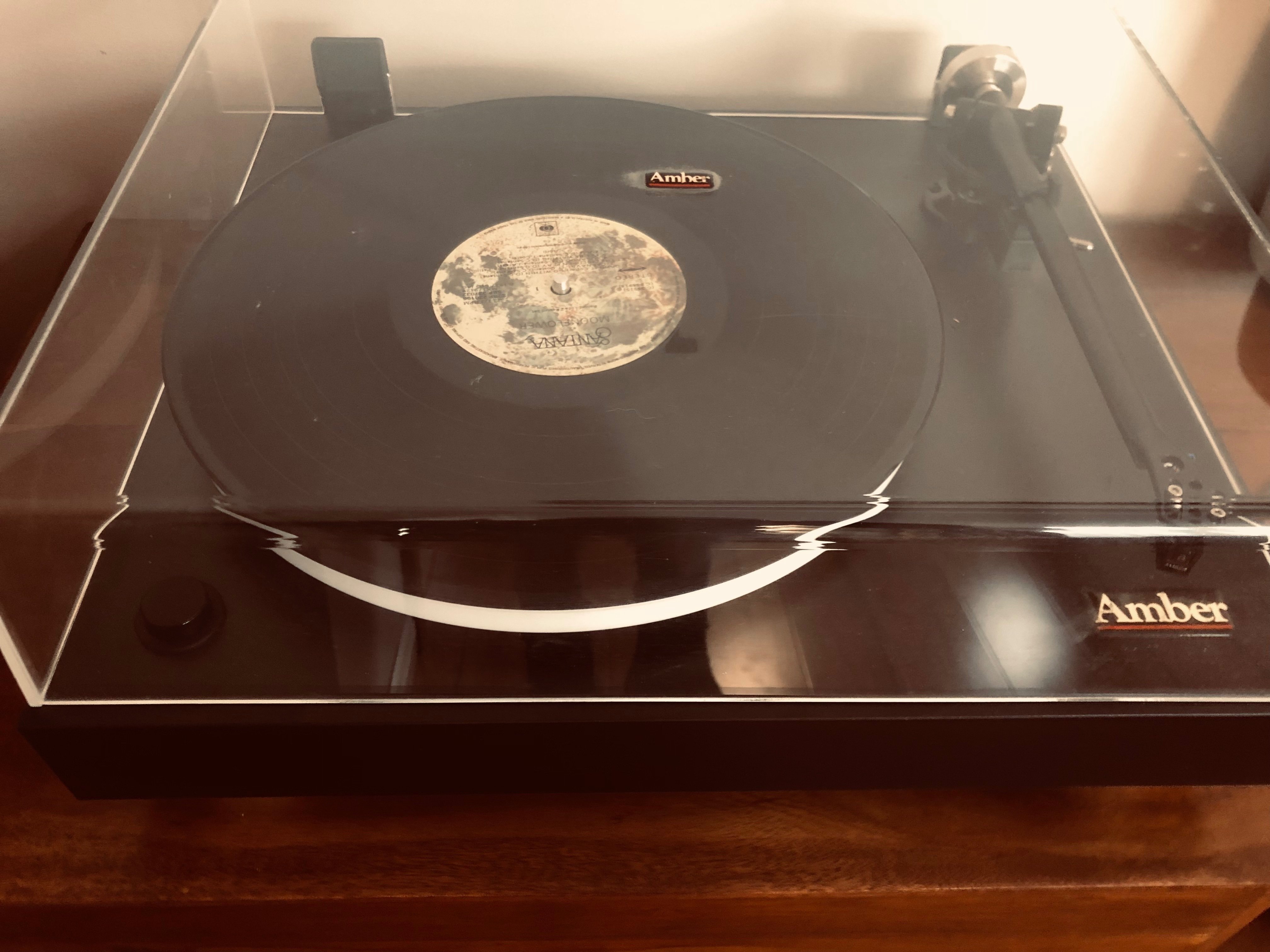

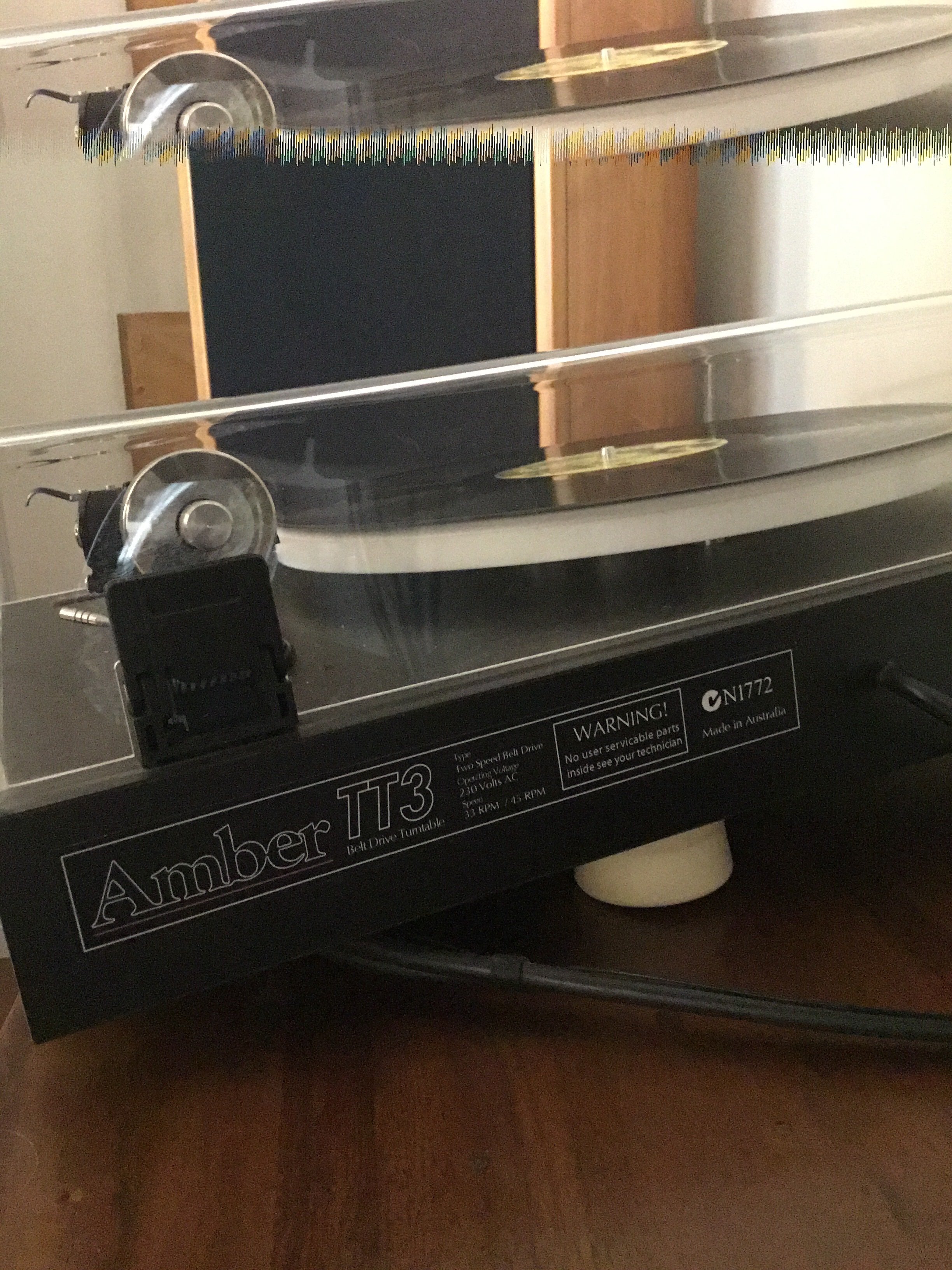

Amber were never well known turntables,  I think they were something Nick did in low numbers.  Pretty sure he used rega RB250 and RB300 arms, yours looks like it could be an RB300. I would suggest you take clear photos of the table from the top and at angles,  and remove the platter and take a photo,  will be much easier to identify it.

Thanks for your advice, do these photos help ?
OK:
1 hour ago, Paulj1959 said:
The belt is round
and
320mm long = a diameter of 102mm.
You might like to contact Renseal, in Dandenong.  They have round, silicone 'O rings' of various diameters - I use two on my TT (two motors).
Their no. is 9794-5711.
going to go out on a limb and say it looks like a rega drive to me! I will check my Red Devil rega belts tomorrow,  have a feeling they are the same length.
