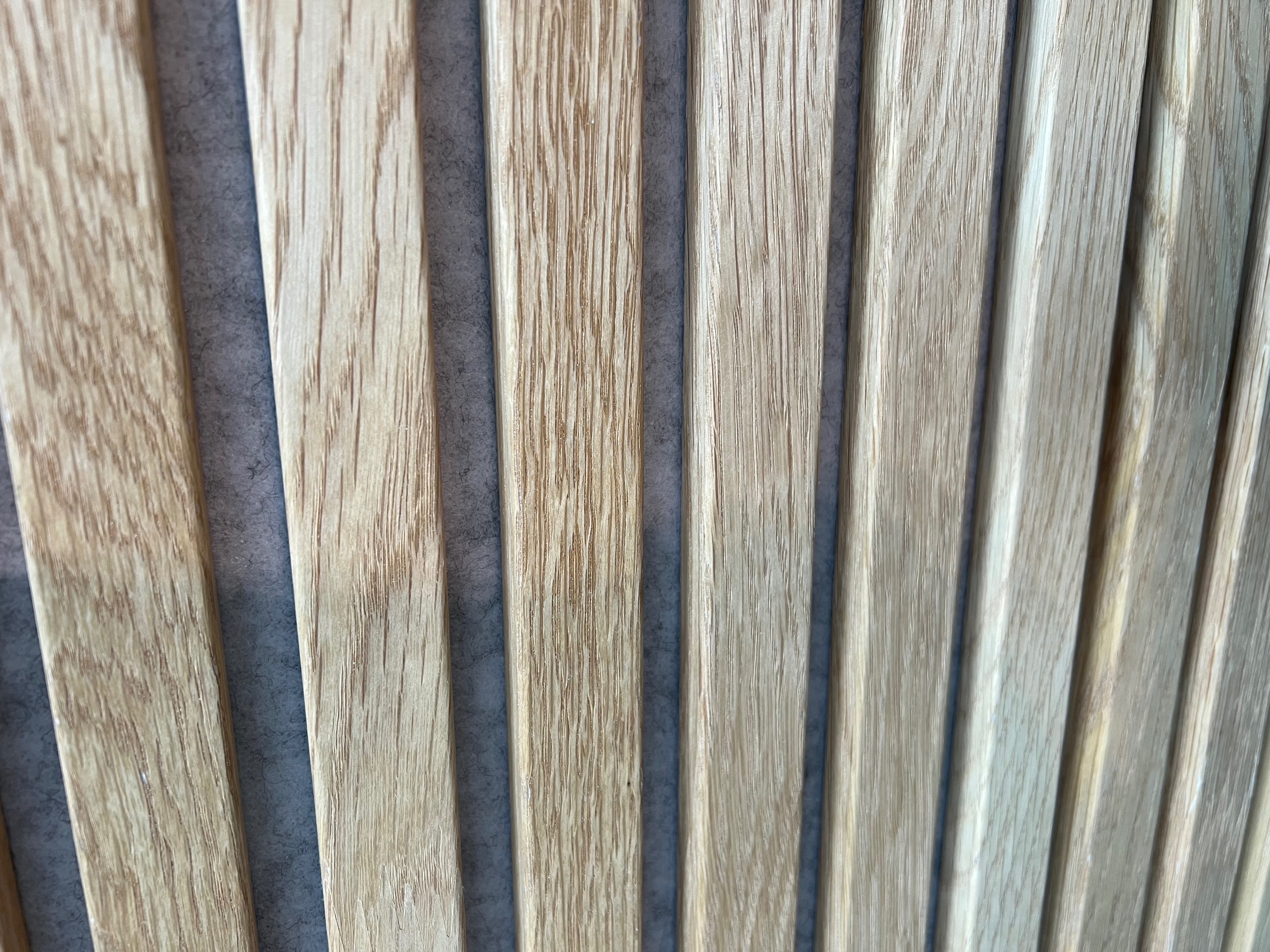

Andythiing Posted July 12, 2024 Posted July 12, 2024 Waste of money or possible useful diffuser on first reflections ? Any advice welcomed.

Andythiing Posted July 12, 2024 Author Posted July 12, 2024 55 minutes ago, rocky500 said: I want to buy something like this for my Kitchen. There is some cracks around the door frame, that when ever I patch them, they come back pretty quickly. Cracked through the brickwork. Also the family drops around for dinner regularly and the noise when we all start talking is a bit wild. Hoping to put some of this acoustic paneling on the one wall and tame the noise when a few people are in the kitchen to make it more audible. I was just looking at these ones https://www.bunnings.com.au/prempanel-2700-x-600-x-21mm-oak-timber-acoustic-panel_p0455959 Same product I think
Volunteer sir sanders zingmore Posted July 12, 2024 Volunteer Posted July 12, 2024 Gets some pretty poor customer reviews 1
Andythiing Posted July 12, 2024 Author Posted July 12, 2024 2 hours ago, sir sanders zingmore said: Gets some pretty poor customer reviews Yes I noted that - poor manufacturing with limited staples holding them together - appears to be an issue when cutting boards in particular- Bunnings response is they have had the issue addressed - I think I’ll have to at least check that’s been done - but at least with these ones being smaller squares I wouldn’t cut them - probably just place 2 together strategically?

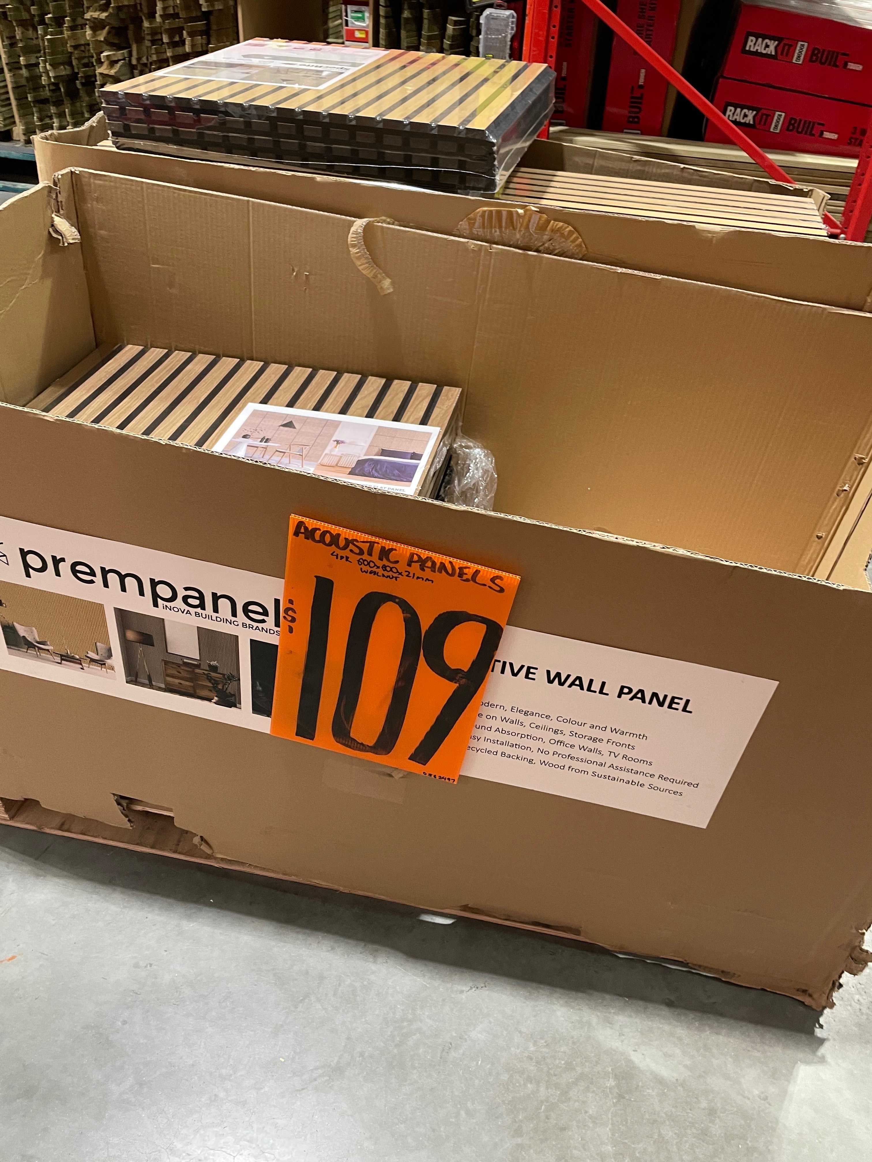

THOMO Posted August 2, 2024 Posted August 2, 2024 My Bunnings had two of these panels at half price so I bought them and will do some experimenting and try to work out the best mounting method.Which is not so easy with textured plastered brick walls.My initial thought is that they probably should have a rigid backing like 4mm ply.The battens are just stapled on through the felt. The other annoying thing is that at 2700mm they are about 100mm shorter than my ceiling height in the room in which I was wanting to use them.So to look decent I probably need to install 120 mm by say 32mm skirting board with a rebate into which the panels will sit. The battens are also just raw sawn MDF on the edges and a bit concerned about having that much raw MDF in my living space because it does have urea formaldehyde glue in it which is not the healthiest of substances. 2
Andythiing Posted August 3, 2024 Author Posted August 3, 2024 2 hours ago, THOMO said: My Bunnings had two of these panels at half price so I bought them and will do some experimenting and try to work out the best mounting method.Which is not so easy with textured plastered brick walls.My initial thought is that they probably should have a rigid backing like 4mm ply.The battens are just stapled on through the felt. The other annoying thing is that at 2700mm they are about 100mm shorter than my ceiling height in the room in which I was wanting to use them.So to look decent I probably need to install 120 mm by say 32mm skirting board with a rebate into which the panels will sit. The battens are also just raw sawn MDF on the edges and a bit concerned about having that much raw MDF in my living space because it does have urea formaldehyde glue in it which is not the healthiest of substances. If you can work out the LD50 on the product we’d all appreciate it 1
THOMO Posted August 3, 2024 Posted August 3, 2024 20 minutes ago, Andythiing said: If you can work out the LD50 on the product we’d all appreciate it It seems that cured MDF has a very low toxicity level but when it is freshly cut it is much higher.If these are plastic wrapped soon after production those levels in the wrapping could be high.Might be safest to remove the wrapping using a mask and leave them outside for a week or so. 1
