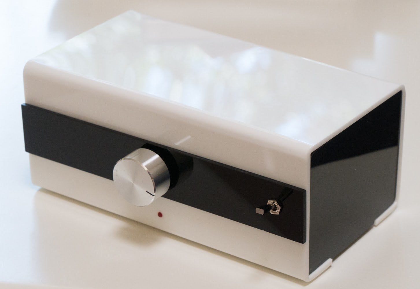

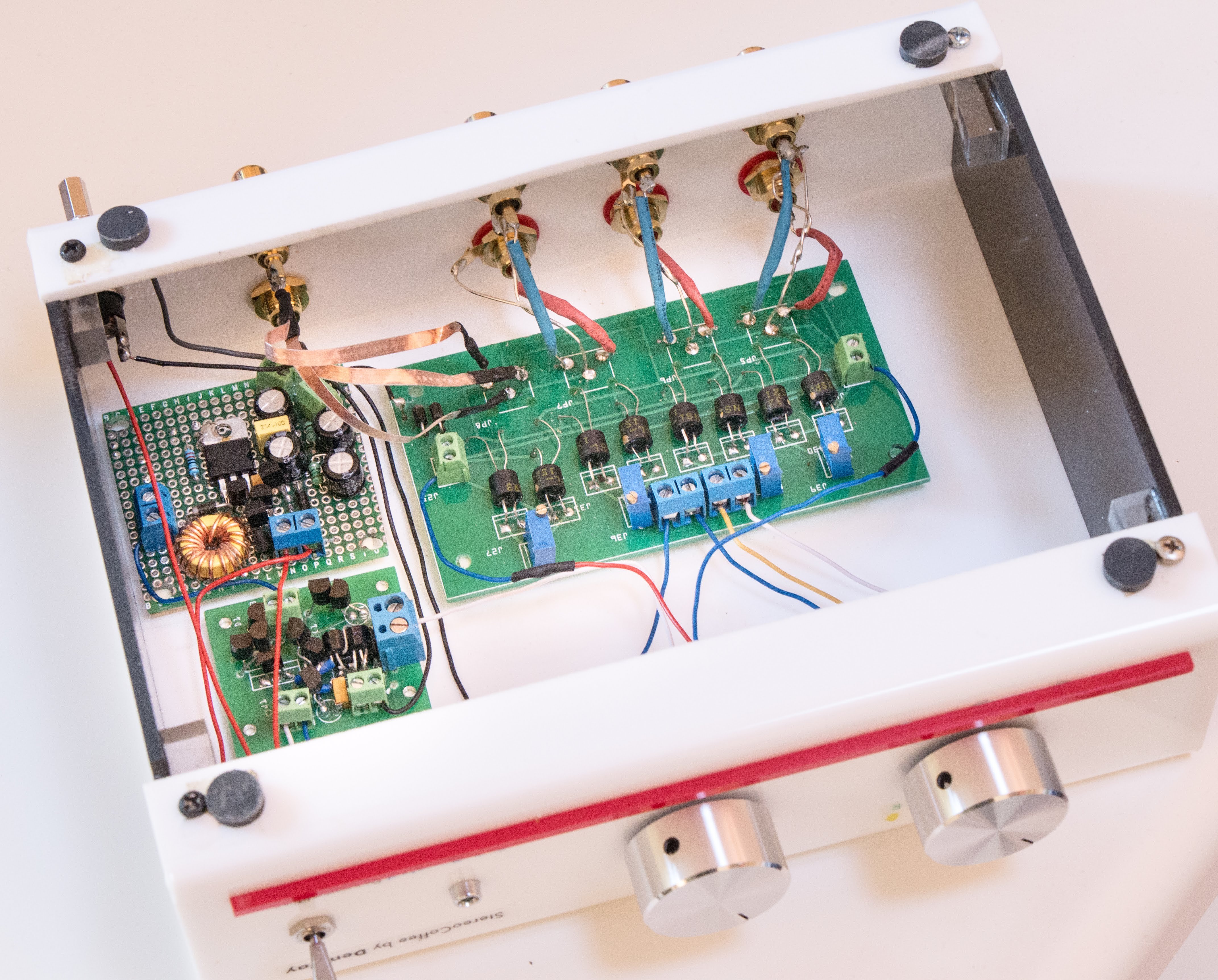

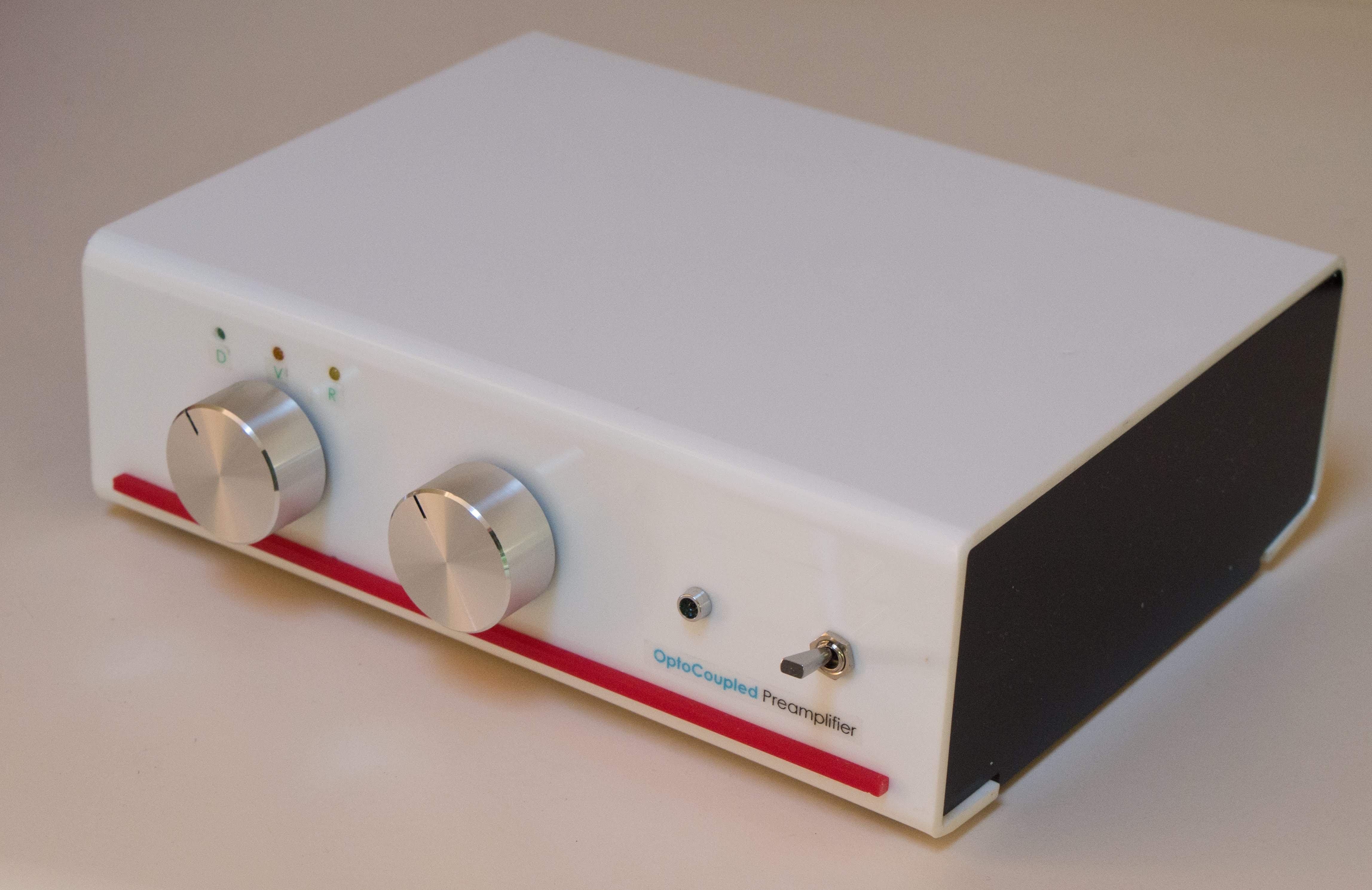

Because I'm always on a budget, I've found that timber from Bunnings and 4mm perspex are cheap ways to make and enhance my personal audio projects.
Perspex was bent with a high resistance hot wire from Jaycar mounted on top of a hinged chip board. It's powered by a battery charger but a  car battery would be more effective. It was slow, but it did the job.

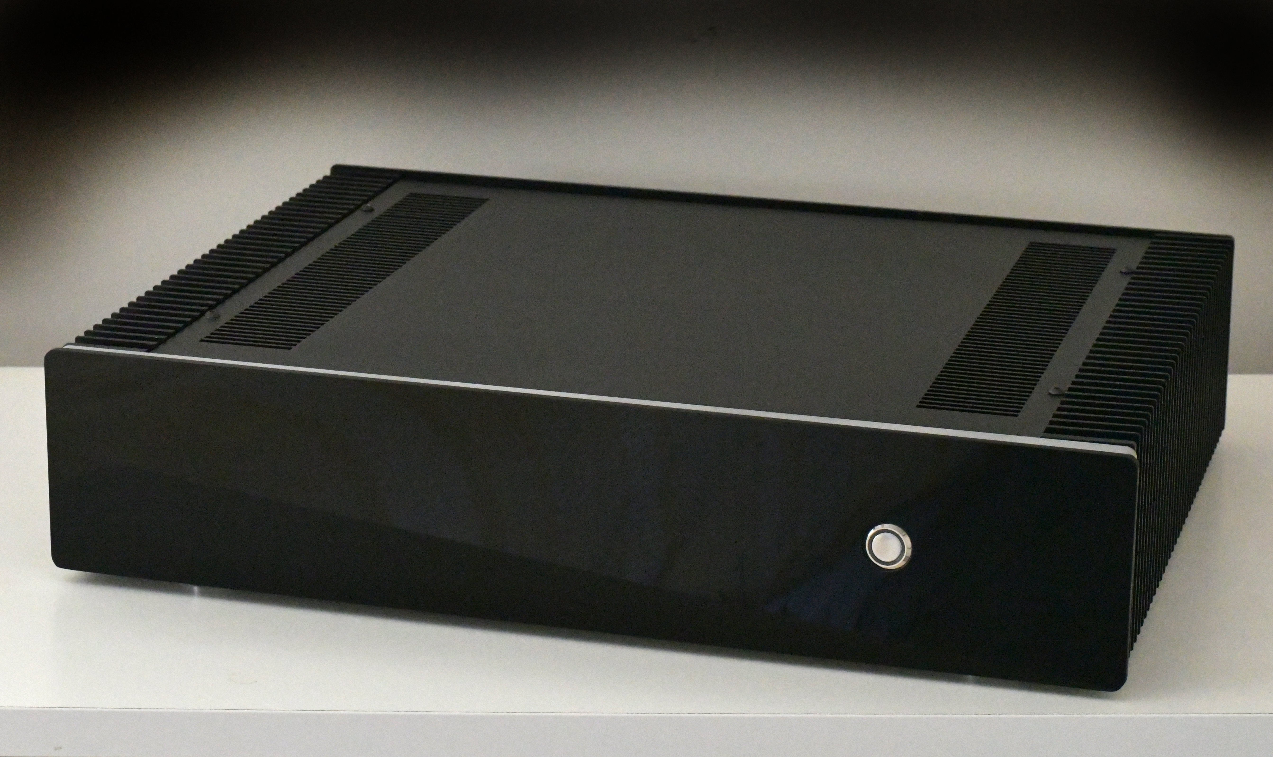

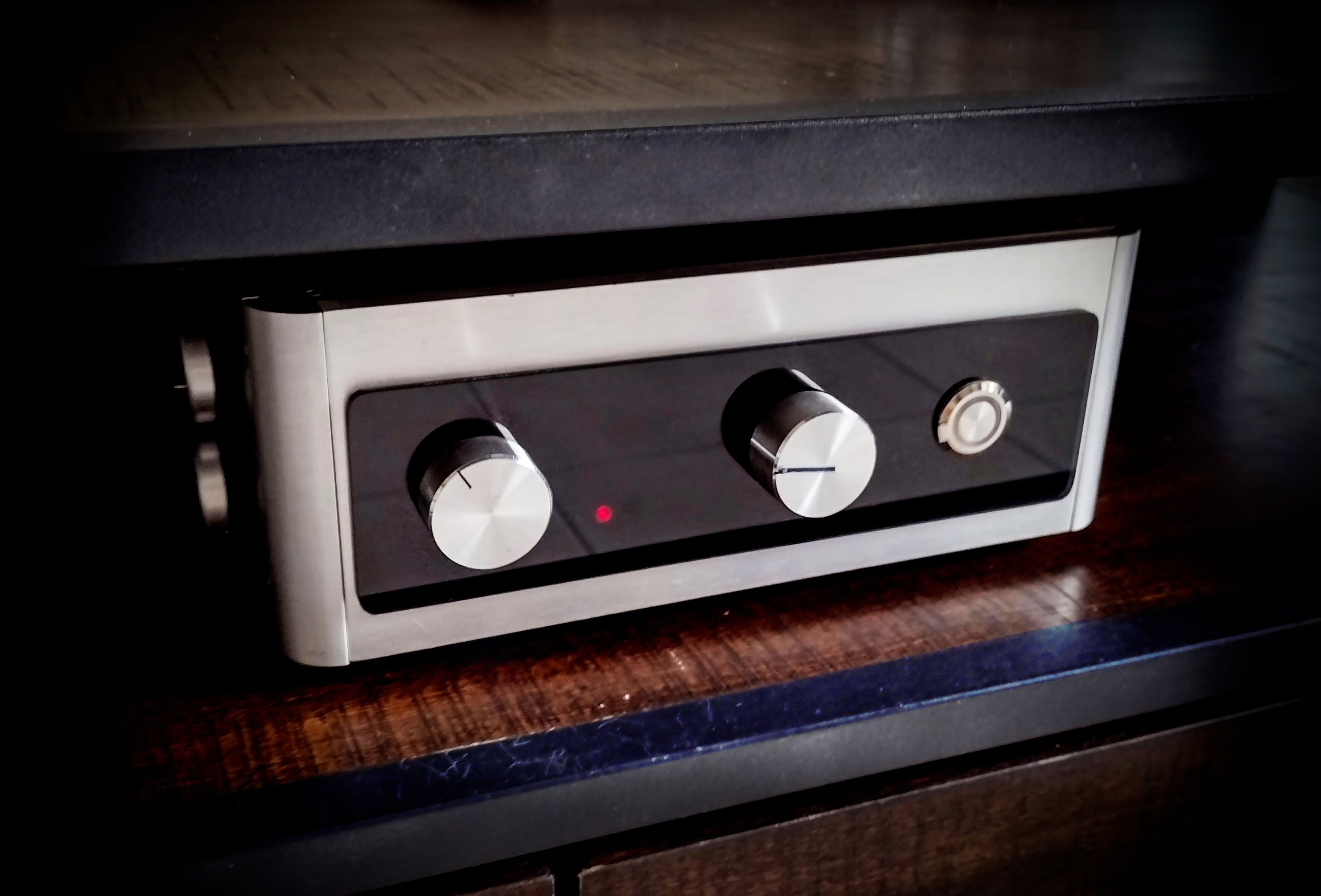

My current 2024 integrated StereoCoffee/Hypex uses a beautifully engineered, heavy aluminium enclosure, obtainable from Douk on Bay for under $200 and delivered in a couple of days.
The perspex panel was added to provide WAF by making it less shiny and noticeable. It is held in place by the push button.

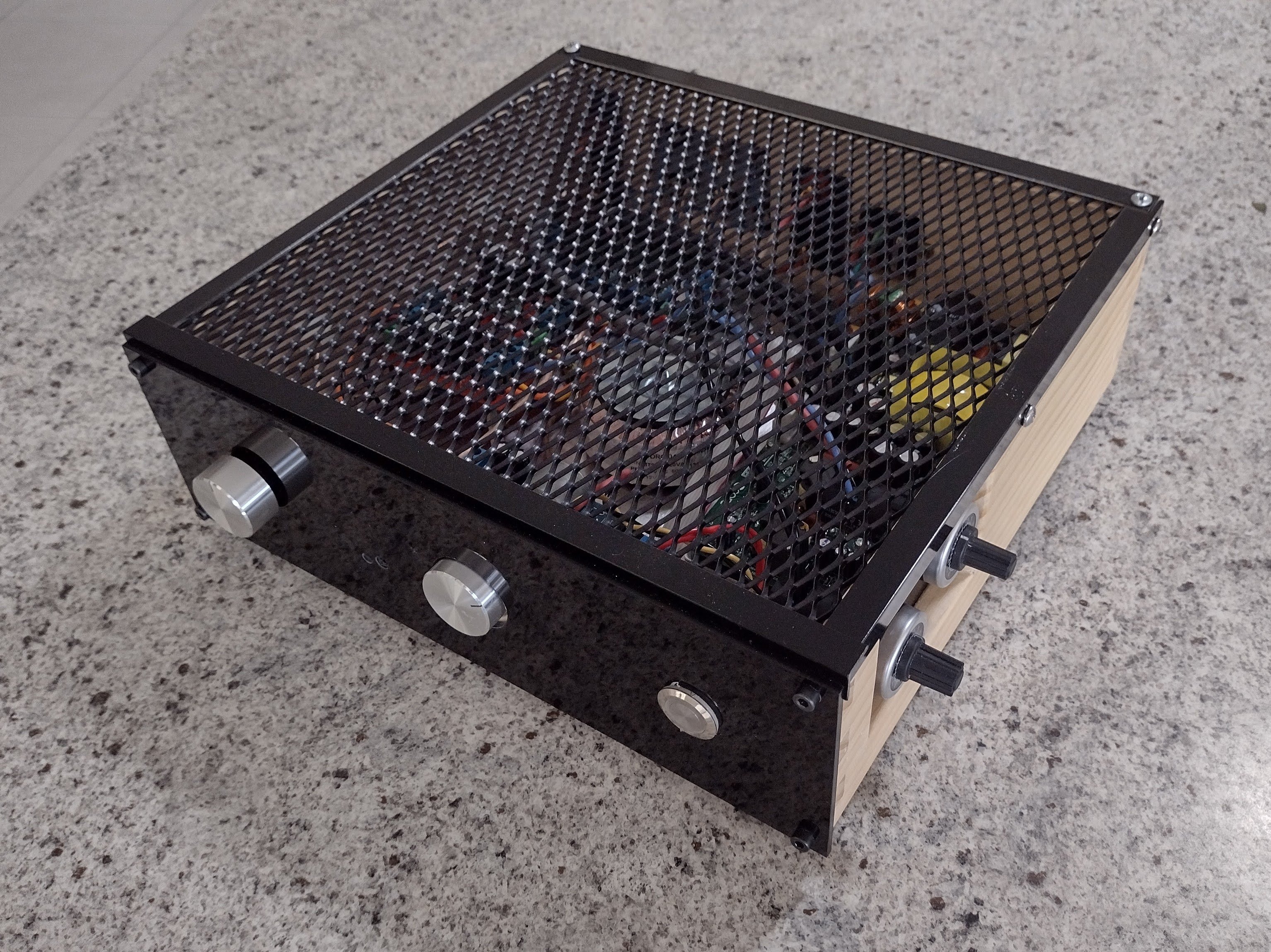

These early StereoCoffee enclosures cost around  $10 each for A4 4mm cut sheets bought from Bay.
2017StereoCoffeestriped.thumb.jpg.f25434da5eb2e0ca78a998e0a180ee37.jpg 2017StereoCoffeeinterior.thumb.jpg.492c2d244207b70b2d0e0669fc2197a4.jpg Perspexfront.jpg.33b7af3245a49335245e07638b02750d.jpg

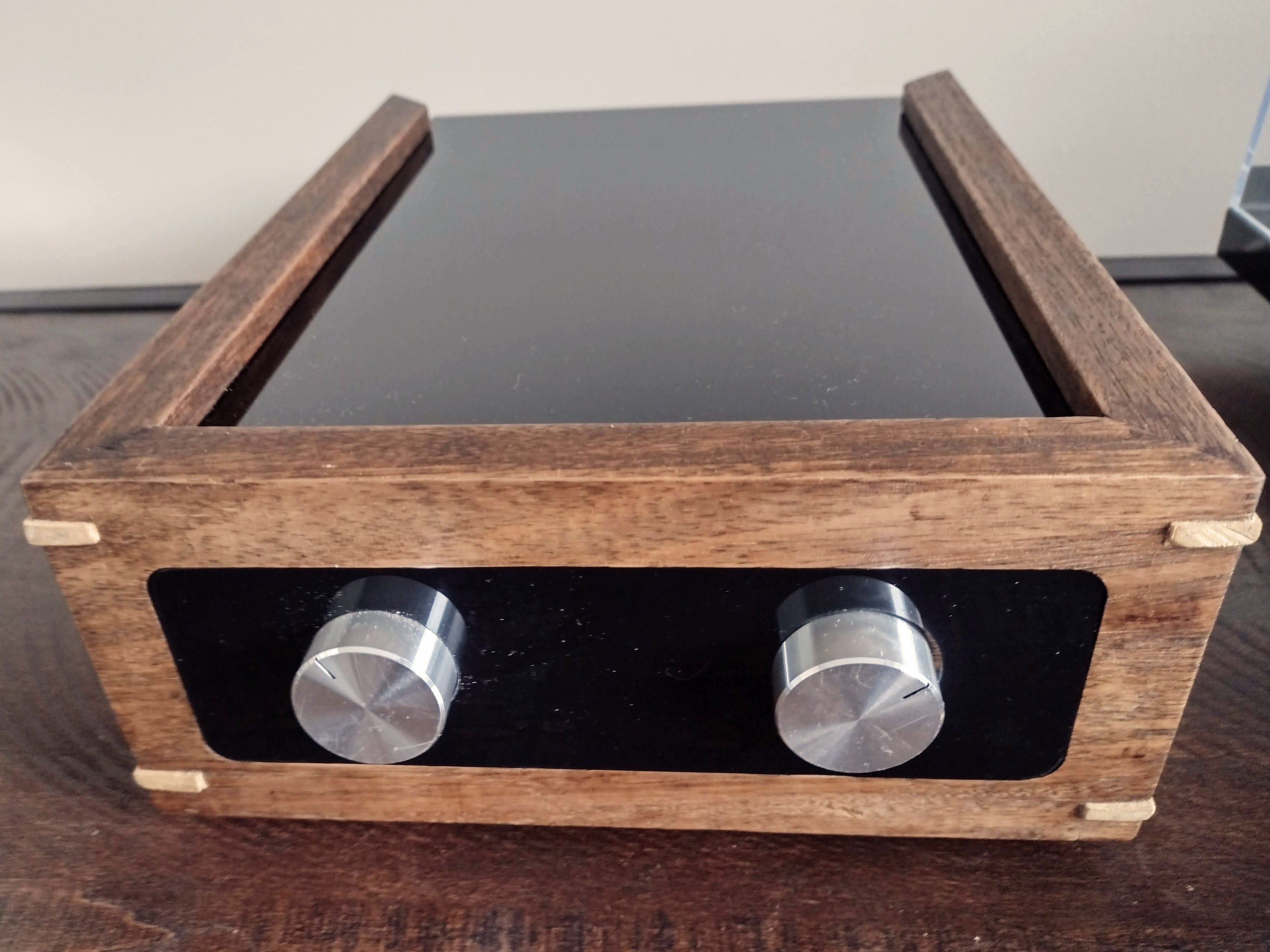

The Pine and Tassie Oak enclosures cost under $10 each to make plus some perspex offcuts. (if you don't count tools 😉)

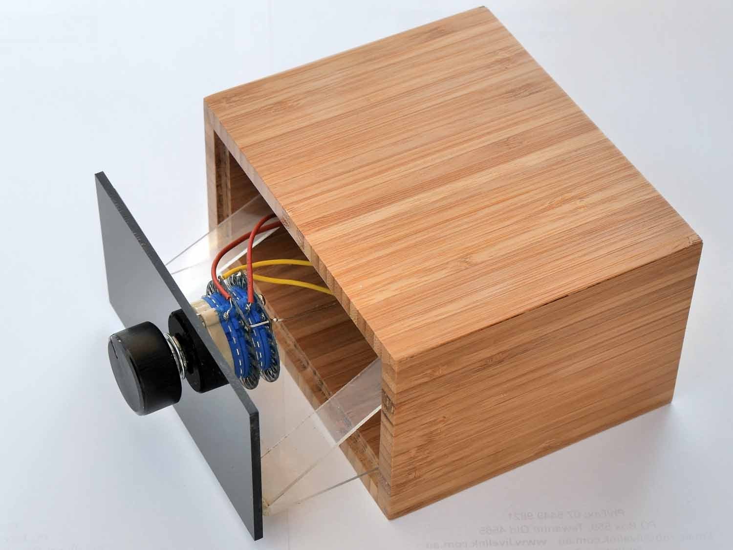

The switched attenuator enclosure with mitred sides was originally a cheap bamboo cutting board from Kmart before I discovered the benefits of LDR attenuators..

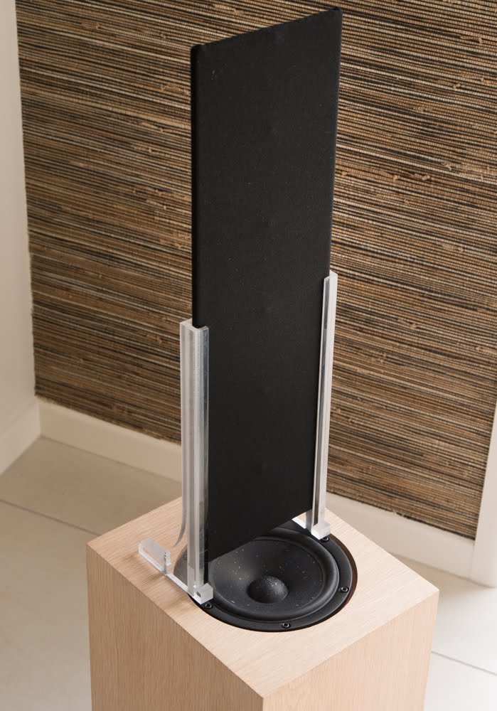

The DIY ESLs from ER Audio were mounted between 12mm perspex supports.
