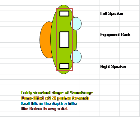

Cafad Posted January 21, 2014 Author Share Posted January 21, 2014 I thought I'd play around a little in excel to try to illustrate some of the differences in the shape of the sound stage of each of the cd players. You have to use a bit of imagination and transpose the colored shapes a little to the right so that the speakers are under the green egg. The orange of the cd120 is the forward mids in picture form and the blue is where the Krell places some of its bass. Does that help at all? 1 Link to comment Share on other sites More sharing options...

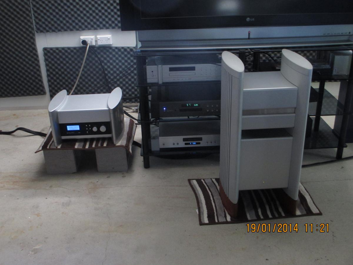

georgehifi Posted January 21, 2014 Share Posted January 21, 2014 Having the equipment rack in-between the speakers like that can show off the system like it's on display at a hifi show, but it's absolutely not doing any favours for imagining or depth presentation. I was amazed at just how much it effects when I shifted all my gear to the side and left nothing between the speakers and 6ft behind. Cheers george Link to comment Share on other sites More sharing options...

Cafad Posted January 21, 2014 Author Share Posted January 21, 2014 Having the equipment rack in-between the speakers like that can show off the system like it's on display at a hifi show, but it's absolutely not doing any favours for imagining or depth presentation. I was amazed at just how much it effects when I shifted all my gear to the side and left nothing between the speakers and 6ft behind. Cheers george I like the idea George, I also like the idea of putting all the gear in a separate room and just leaving the speakers in the listening room, but I don't think it's very practical. I mean if I had the perfect set up and could wring every bit of imaging and 3D performance out of a piece of gear then that would be great but it wouldn't mean too much to someone who is interested in buying said gear and has no choice but to set it up in the traditional "lounge room" way. Also, do you have the power amp nearby and run long ICs or is the power amp off to the side too so you have to run long speaker cables? I can see potential issues with both of those options, I've already come across two amps that can't handle the load of a regular length of Ribbontek or cat 5 based speaker cable (and another 1 or 2 that can but run very hot on high capacitance cables), if I have to go from a 2.5m length of speaker cable to a 6m length then I may just let the smoke out of the next $500 integrated amp that I line up to test. Everything is a compromise in this game. You have got me thinking though... Nice to see a discussion about soundstage shape. Of course there is soundstage height as well. A while back when I was playing with DACs I borrowed a Micromega Mydac which had a very peculiar soundstage presentation.It had no image height at all.Most CD players/DACS do lack a bit of image height but the Mydac was an extreme example of it.And yet Absolute Sound gave it a rave review! The Krell has pretty good soundstage depth and height-normally a weak area for multi-bit players in my experience. I have noticed one or two pieces of gear that do interesting things with the height of the sound stage THOMO but nothing about the Krell, cd120 or Halcro stands out as higher or lower than average. I am hoping one of the other players will do something a bit more interesting with height or depth but we'll just have to wait and see. Link to comment Share on other sites More sharing options...
georgehifi Posted January 21, 2014 Share Posted January 21, 2014 I like the idea George, I also like the idea of putting all the gear in a separate room and just leaving the speakers in the listening room, but I don't think it's very practical. I mean if I had the perfect set up and could wring every bit of imaging and 3D performance out of a piece of gear then that would be great but it wouldn't mean too much to someone who is interested in buying said gear and has no choice but to set it up in the traditional "lounge room" way. Also, do you have the power amp nearby and run long ICs or is the power amp off to the side too so you have to run long speaker cables? I can see potential issues with both of those options, I've already come across two amps that can't handle the load of a regular length of Ribbontek or cat 5 based speaker cable (and another 1 or 2 that can but run very hot on high capacitance cables), if I have to go from a 2.5m length of speaker cable to a 6m length then I may just let the smoke out of the next $500 integrated amp that I line up to test. Everything is a compromise in this game. You have got me thinking though... It depends on your system. If your poweramps (most tube) are not very low output impedance (low damping factor), then short speaker wires would be prefered. If your poweramp (most solid state) are low output impedance (high damping factor) longer speaker wires can be used. If your preamp output impedance is high/ish say (most tube) over a couple of hundred ohms, then short interconnects are the way to go. If your preamp output impedance is lower (most solid state) than say <50ohms, then long interconnects can be used. You see, it depends on what you've got, wether you use long speaker wires or long interconnects. What is your preamp and what is your poweramp/s I will try and find out which is the best way to go. Cheers George Link to comment Share on other sites More sharing options...
Cafad Posted January 22, 2014 Author Share Posted January 22, 2014 Well the preamp I use tends to change 2 or 3 times a month, and the power amp weekly. And what would I do with the TV? Hang on, I've got an idea. What say we shift this part of the discussion over to my 'Showcase Your System' thread so I can keep this one more about the cd players. http://www.stereo.net.au/forums/index.php?/topic/46732-my-room-of-audio/page-3 Give me a little time here George, I'm going to have to take a few pics and have a good, long think, there'll be at least 375ml of bubbly caffeinated beverage involved and probably a fair amount of chin scratching as well. Link to comment Share on other sites More sharing options...
georgehifi Posted January 22, 2014 Share Posted January 22, 2014 (edited) And what would I do with the TV? Two things could be done, a fold up bracket so it's flush with the roof, when your listening to your stereo system. And then fold down for 5.1 rubbish. Or do what I did, satisfy the family and have separate TV room with a good s/h 5.1 system set up around the tv. A keep this dedicated hi-end stereo room as YOUR man cave. Entrance only by invitation and must be accomapied by a good red. Cheers George Edited January 22, 2014 by georgehifi Link to comment Share on other sites More sharing options...
Cafad Posted January 22, 2014 Author Share Posted January 22, 2014 The Halcro EC800 is an interesting player. It is right up there with accuracy and detail, it doesn't give anything away to the Krell in the area of bass or treble extension and it has an iron grip on the sound stage. Check out the pic below. The music is only allowed to go where it is told to go and it will not stray outside the bounds of the box (which I am sure had its dimensions defined by a surveyor with a masters degree in mathematics). As far as the sound personality goes, the Halcro is more bland, more 'technically correct' in character and just a touch drier. Which fits with the Halcro sound, clear, clean and technical. The big difference that is pretty easy to spot is in the vocals, the Krell has vocals that sound more like the people singing them while the Halcro has vocals that sound clear, clean and technical but still electronically reproduced. The smaller difference is that the Krell sounds just a bit more polished, it gleams a little more. I guess you could also call it a little-less-technical and just that bit more emotive. Both excellent players. And of course the Halcro can be used to play my legacy DVD collection, a definite plus, but I think I'd be using the Krell to listen to cds on. 1 Link to comment Share on other sites More sharing options...

Cafad Posted January 23, 2014 Author Share Posted January 23, 2014 I'm not quite out of players yet, next in line is the Myryad Z114. This player is in many ways an opposite of the cd100. The cd100 has all that 'incidental noise' that makes brushes on drums sound a bit harsh and lets any and all strings 'twang' and hum on through to a long decay, the Z114 allows none of that. No incidental noise, no hash or brightness, at all, ever! Now that could make things seem a bit dark and damp on some players but the Myryad still manages to sound rather good. Vocals don't seem to be affected by this 'war on incidentals' and the bass performance is very strong and tight, though it lacks a little of the Krells depth and alot of the Krells naturalness. The sound stage also starts further back, I would call the Z114 strong and, grey (as in has both dark and deep aspects but neither is overly so) sounding with just a little too much control on the bass. In this equipment configuration I prefer the Z114 to the unmodified cd120, the modified cd120 however is definitely a cut above the Z114. Now the Z114 also contains opamp chips which means it could be modified in the same manner as the cd120 but Myryad have soldered these chips directly to the PCBs (where as the cd120 opamps are pressed into sockets) so modding the Z114 is more difficult. Maybe one of these days I'll get around to it, maybe? It is starting to look a bit crowded isn't it? 1 Link to comment Share on other sites More sharing options...
Telecine Posted January 23, 2014 Share Posted January 23, 2014 Really like your diagram illustrating the soundstage and imaging delivered by the different spinners. It is very innovative and helpful, keep up the good work. Do any of them produce a soundstage that stretches the full width of the room or to the back wall behind the speakers? Any difference in soundstage height? Link to comment Share on other sites More sharing options...
Cafad Posted January 23, 2014 Author Share Posted January 23, 2014 (edited) Hi Tele, yeah, the sound stage pic idea seemed like an interesting one at the time. It also seemed to be an easier way of displaying the differences I could hear without mincing even more words (and it made me remember how to use Excel, always a good thing). Nothing I've heard in this line up of cd players has done anything fancy that stands out above or below the height of the speakers (no more than the usual 6 to 12 inches anyway). I have heard an amp or two that seem to give the sound stage added height but that's a pretty rare thing. My ceiling height is only about 7 and a half feet so that may keep a lid (pun intended) on too much sound stage height being displayed. Only one more spinner to go after the Thule Spirit 100, and a good thing I think, my enthusiasm for this particular project has started to wain a little. That compilation cd that I just loved to bits at the beginning of the thread has started to get a bit old. Edited January 23, 2014 by Cafad Link to comment Share on other sites More sharing options...
