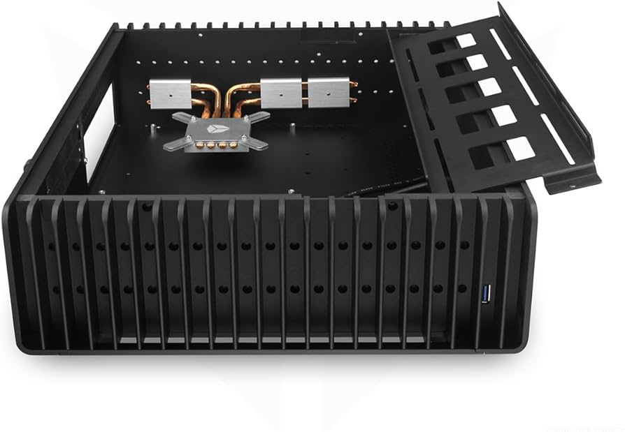

The Streacom has a built-in CPU cooler, so you do not need to buy a third party cooler.
This is how it is supplied (all the parts are individually bagged of course). That CPU cooler comes apart and comes in 2-3 parts. The first part is the CPU plate, which you attach to your CPU. It has grooves machined into it to accept the heatpipes. There is an optional second part which is a heatblock riser to accommodate shorter CPU's. I ordered one of these just in case, but I have never used mine. Then you install your motherboard, run the heatpipes into the grooves, and screw down the third part to fasten the heatpipes in place.
In practice it is a little fiddly because those heatpipes have a mind of their own and do not seem to like the idea of being imprisoned by the CPU heat sink and try to escape! But with a bit of persistence you can get it to stay.

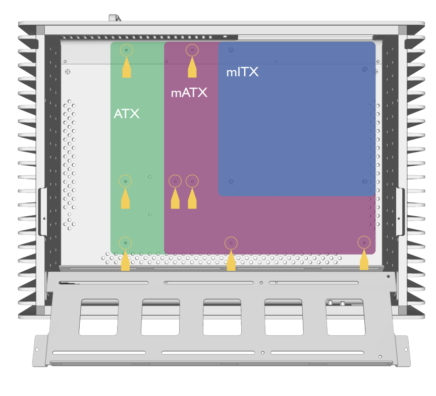

Click this link to download a copy of the FC10 assembly manual. If you go to Page 5, you will see that ATX, mATX, and mITX motherboards are supported. However, if you choose a larger motherboard, you will no longer have space inside the case to fit a power supply, and you will need to use an external power supply.
