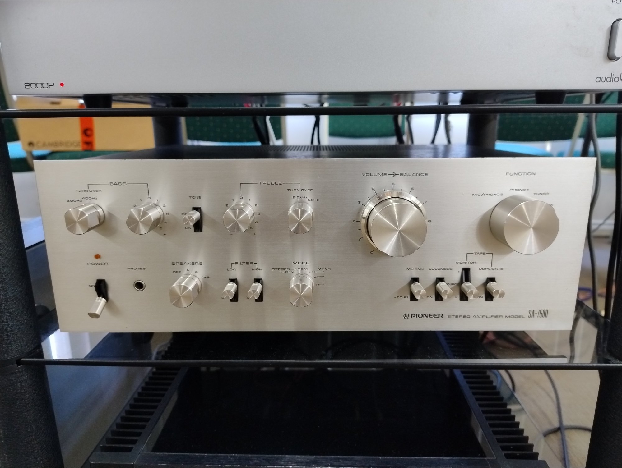

Pioneer SA-7500 Amplifier
Power output: 45 watts RMS per channel into 8Ω (stereo)
The Power Amplifier section uses 1-stage differential amplifiers direct coupled OCL
Outputs: A, B and A + B
The Preamplifier section Equalizer is 3-stage direct-coupled and the Control amplifier is 2-stage direct-coupled with 1 FET, NFB type.
Total harmonic distortion: 20Hz – 20kHz no more than 0.05%
This amplifier has independent Bass and Treble controls with Loudness, Hum and Noise filters – remember those !!

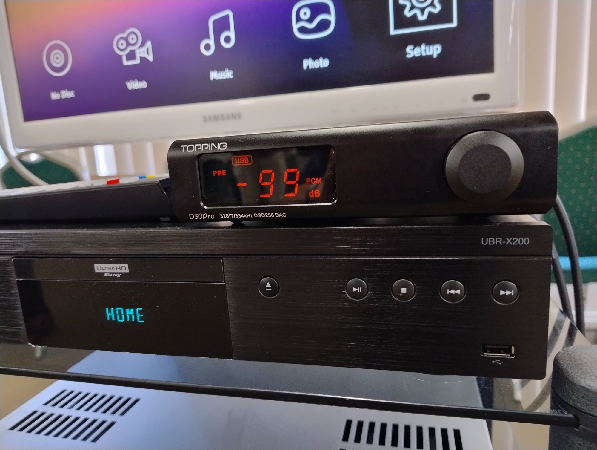

DAC:
Topping D30Pro Pre-Amp DAC
The Topping D30 Pro is a quad-CS43198 chipset desktop DAC with preamp capability offering up to DSD256 and PCM 32BIT/386kHz decoding
USB support DSD256 & PCM384kHz high resolution audio
D30Pro uses 2nd generation 8 core XMOS XU208, USB supports up to PCM32bit 384kHz and DSD256 native.
Universal Blu-Ray Player
 Reavon UBR-X200 UHD Universal Blu-Ray Player purchased by our club with the generous assistance of Len Wallis Audio.

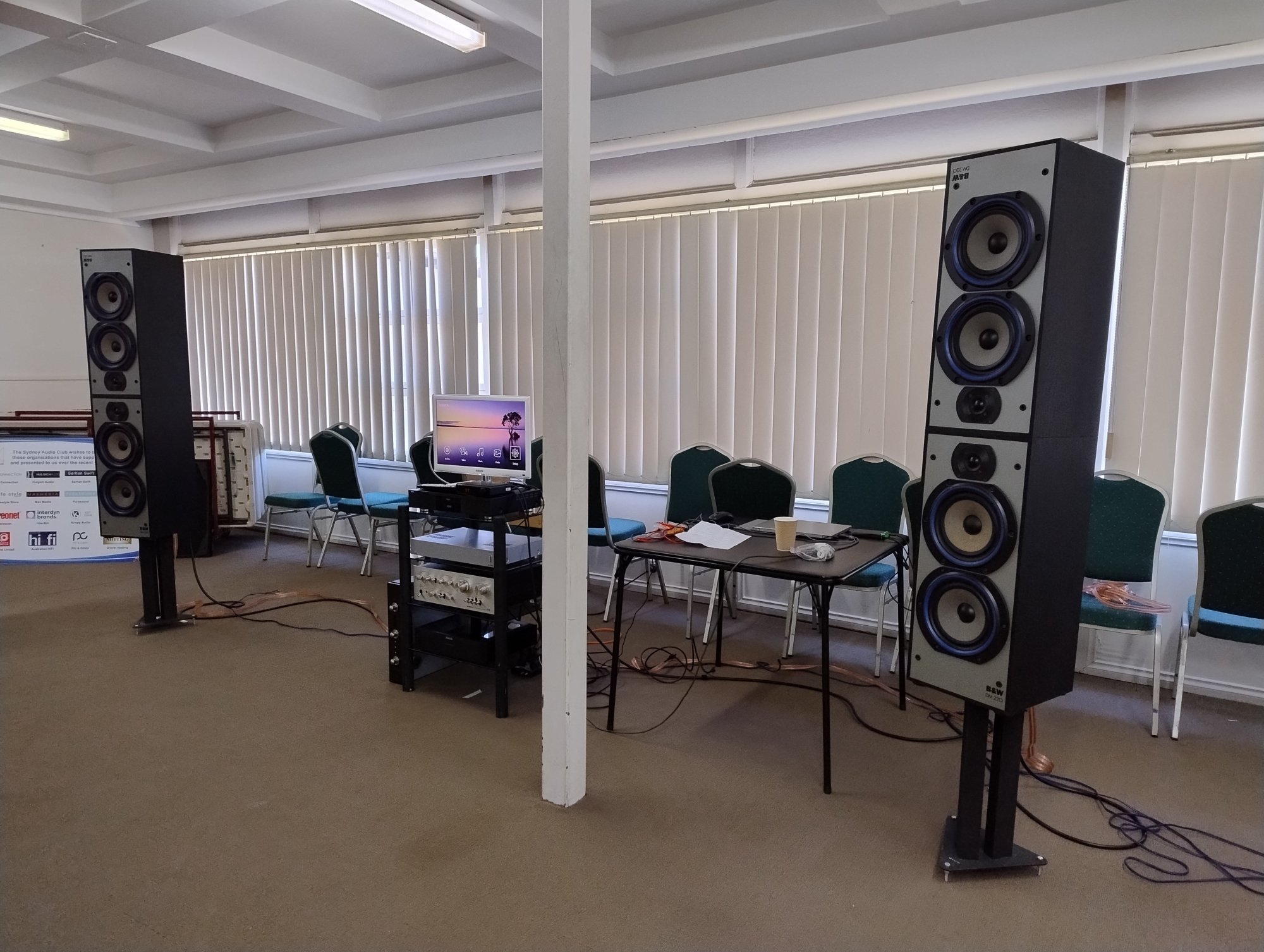

A very well attended meeting (for January) and,  we were pleased to see / meet four new guests,  very encouraging!

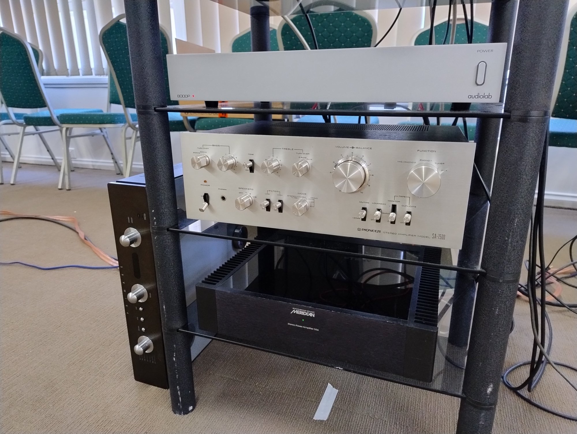

In the first half we were hosted by James who presented music through his pride and joy, the Pioneer SA-7500, a 'gem' and very sought out integrated amplifier from times gone by.
It can still hold its own, against modern amplification as it became evident after listening to it.

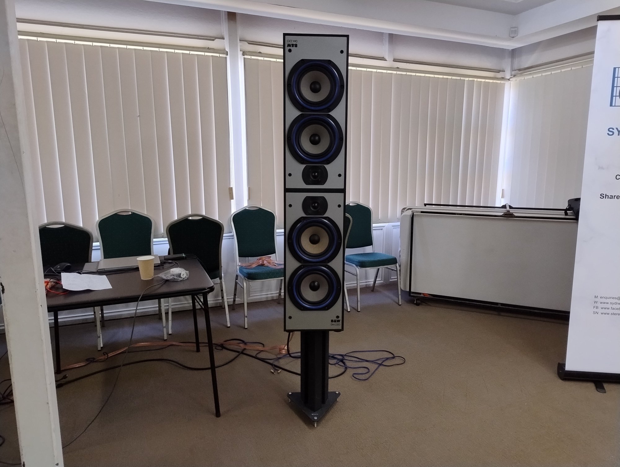

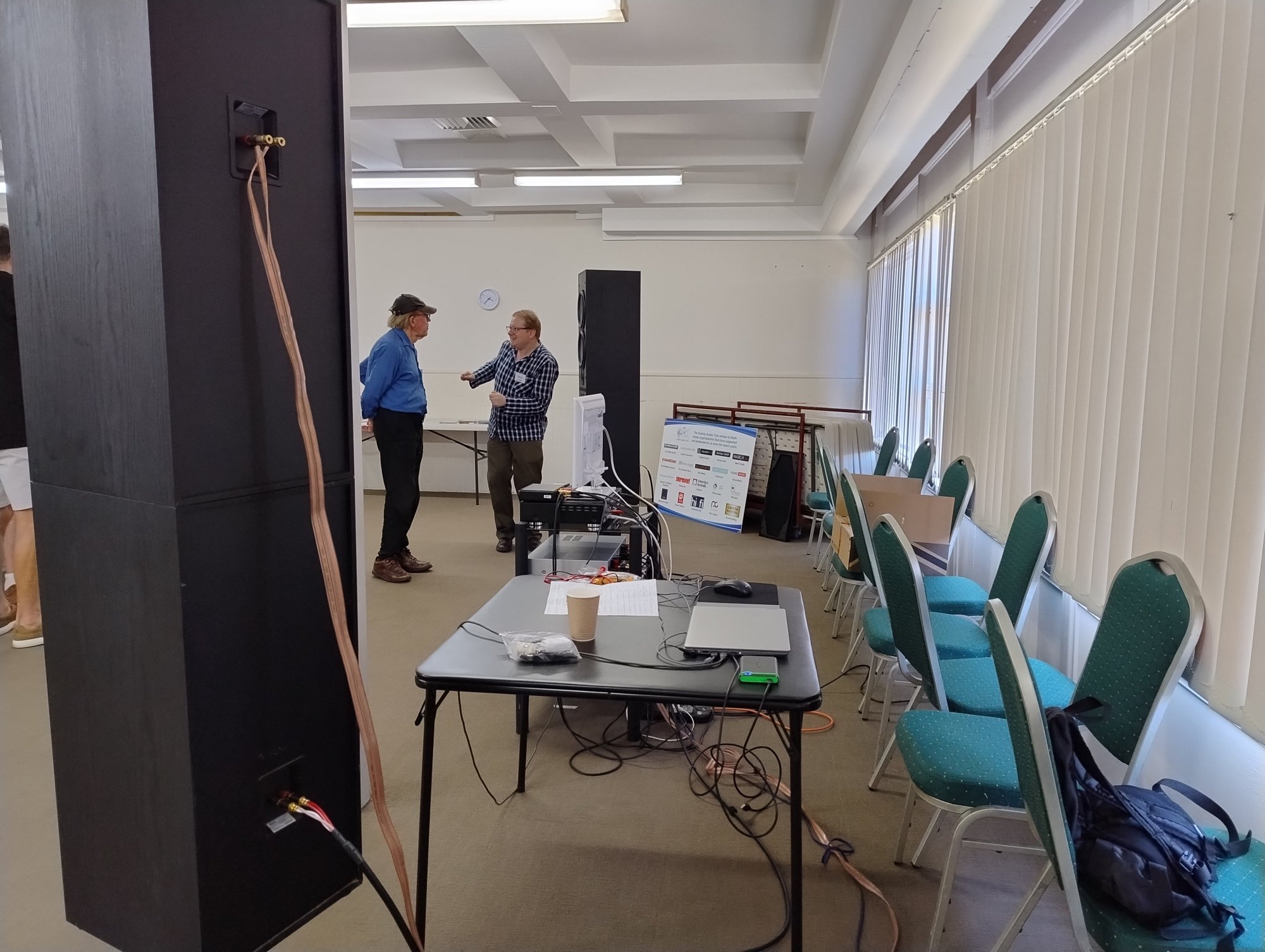

The four B & W DM220 Speakers were stacked in a column, the top one in an upside down manner, in order to simulate the D'appolito configuration used in many designs, where the twitter(s) are positioned between the midrange drivers for a more coherent sound.

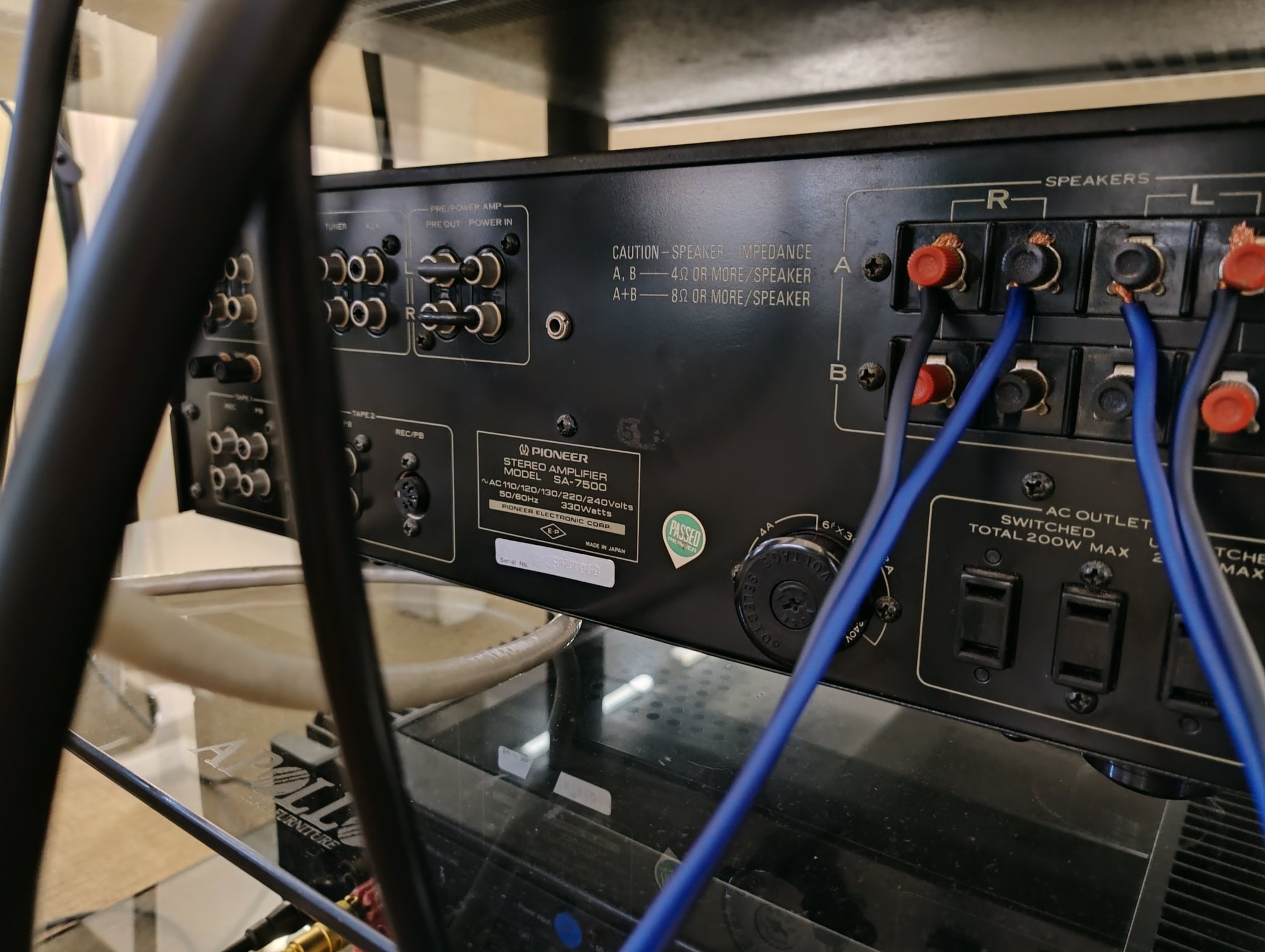

James had them working in parallel top and bottom, ( a brave man!..) which had the amplifier "seeing" a 4 Ohm load at best, which could drop as low as 2 Ohm (or lower) at some frequencies!
Yet, the session went well without any incidents and the Pioneer proved to be more than capable in such configuration, despite its modest power output, and at sensible levels.

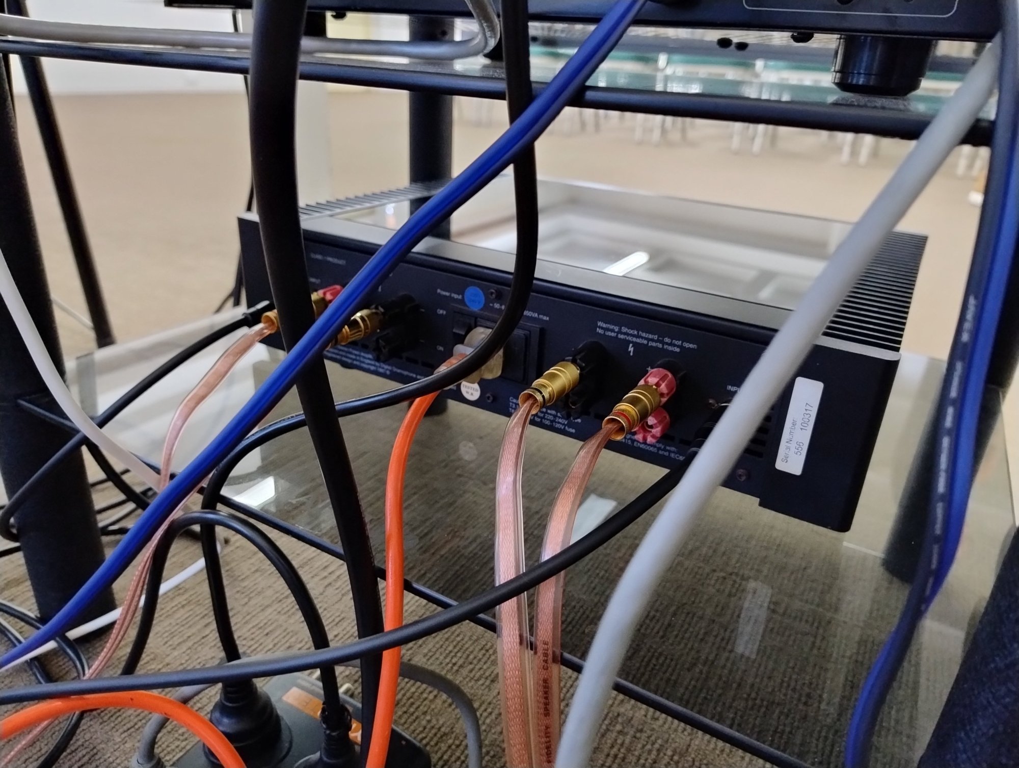

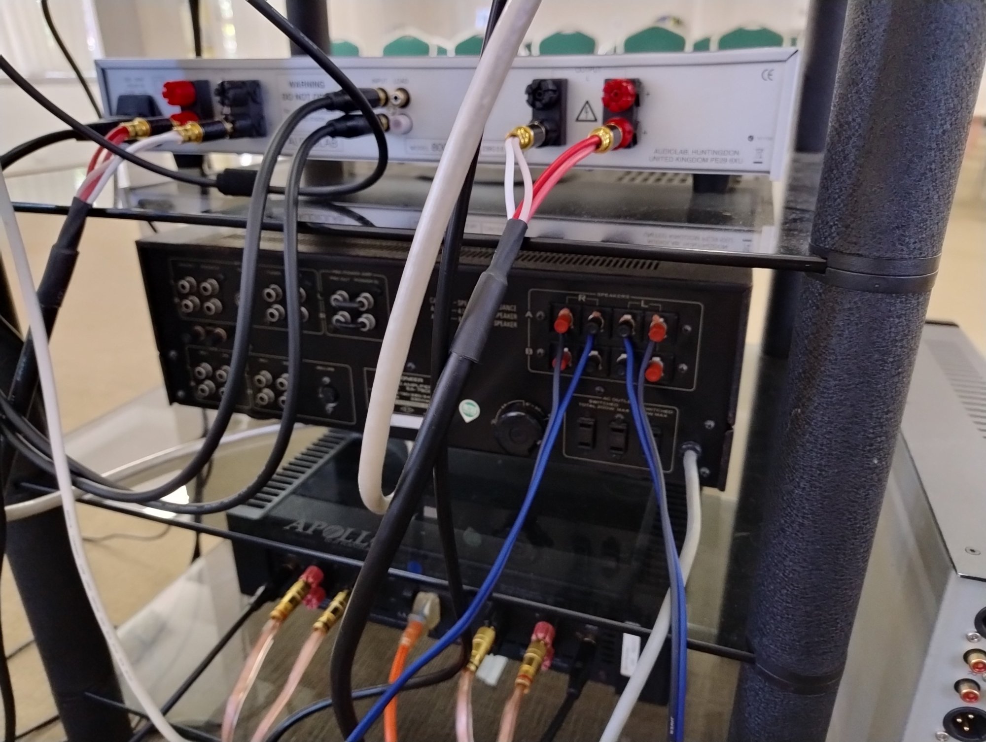

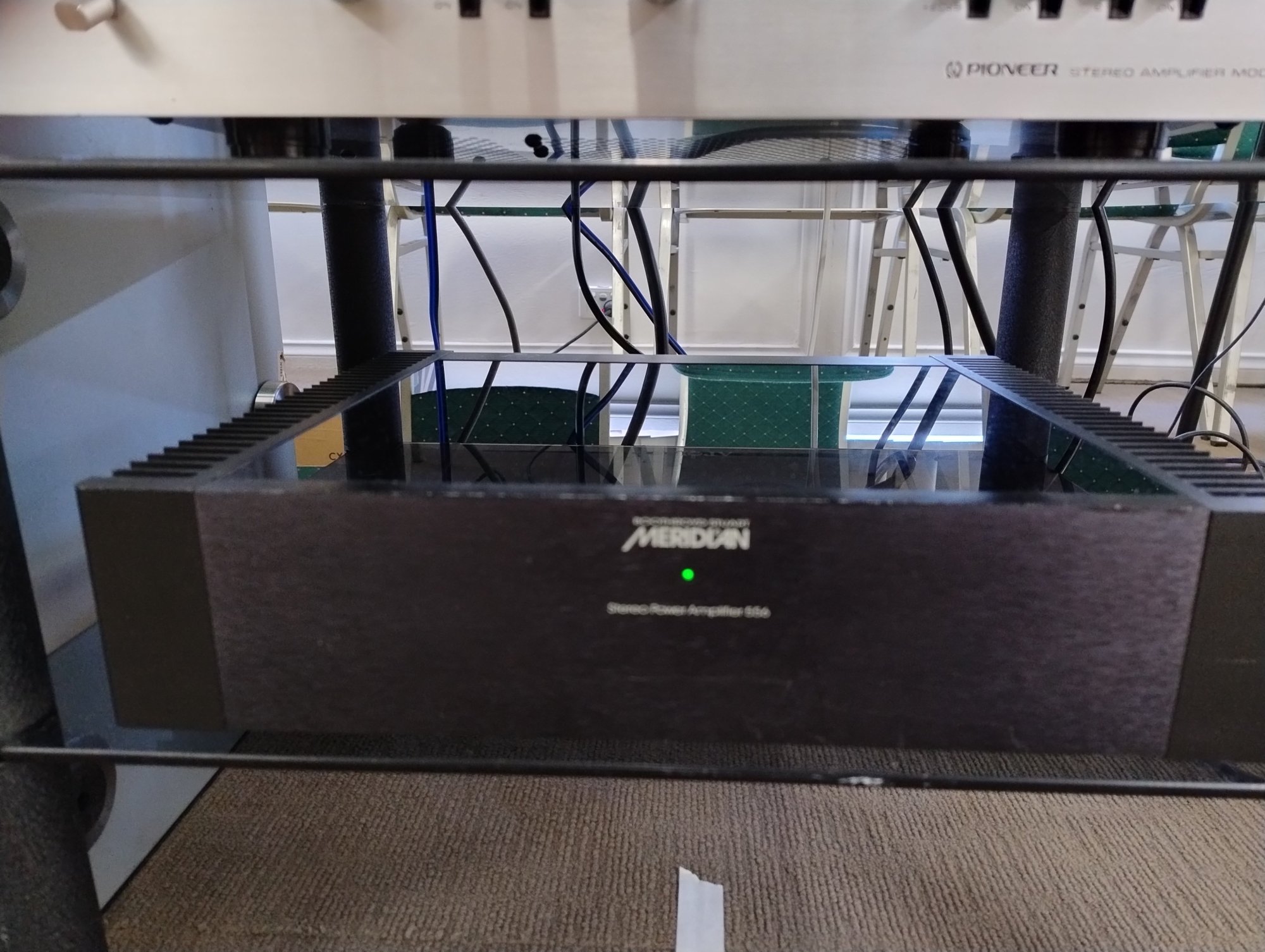

After the coffee brake, the system changed to a Bi-Amping configuration, with two power amplifiers available.
The Audiolab 8000 P (https://audio-database.com/AUDIOLAB/amp/8000p.html),  and a Meridian 556, (http://www.meridian-audio.info/public/556[78].pdf), both at 100 w / 8 Ohm per channel.
The Audiolab drove the two bottom speakers while the Meridian was connected to the stacked top ones.
This configuration allowed the speakers to operate (mostly) at their 8 Ohm nominal impedance, each having access to 100 watts (if required) from the two separate amplifiers.
James was kind enough to continue presenting the "brink your own" session of the meeting.
The sound now was  (understandably) more effortless and somewhat more dynamic although some of the sweetness of the Pioneer was lost.
Instead, a very clear, clean and detailed sound emerged as a result of the two large amplifiers working independently on each pair of speakers.
The Audiolab 8000 P and the Meridian 556  amps are known about giving an uncolored and 'matter of fact' sound.
Overall this combination offered a more punchy sound with well controlled bass notes and plenty of detail.
By the end of it, it became clear these B & W speakers are anything but 'obsolete'!
Perhaps we need to re-think about vintage components and their capabilities....

We can't always obtain the latest and greatest for every meeting, so occasionally we ask members to present equipment.
On Sunday 21st we had an opportunity to audition 'stacked speakers' for ourselves and see if the concept "stacks up".
This presents some technical problems.
Although the speakers were rated as 8 Ohm nominal impedance, some searching revealed that dual woofer systems may drop to 4 Ohms or less at some frequencies - typically between 100 ~ 1000 Hz - and where the most power is required.
For most competent amplifiers this is not a problem however wiring two of these speakers in parallel means impedance could drop to 2 Ohms or less.
For the first part of the meeting two speaker pairs were connected in parallel to the Pioneer amp.
The sound was both entertaining and wildly inaccurate.
We learned later that the amp was being run with the loudness switched on and bass boost on the tone control.

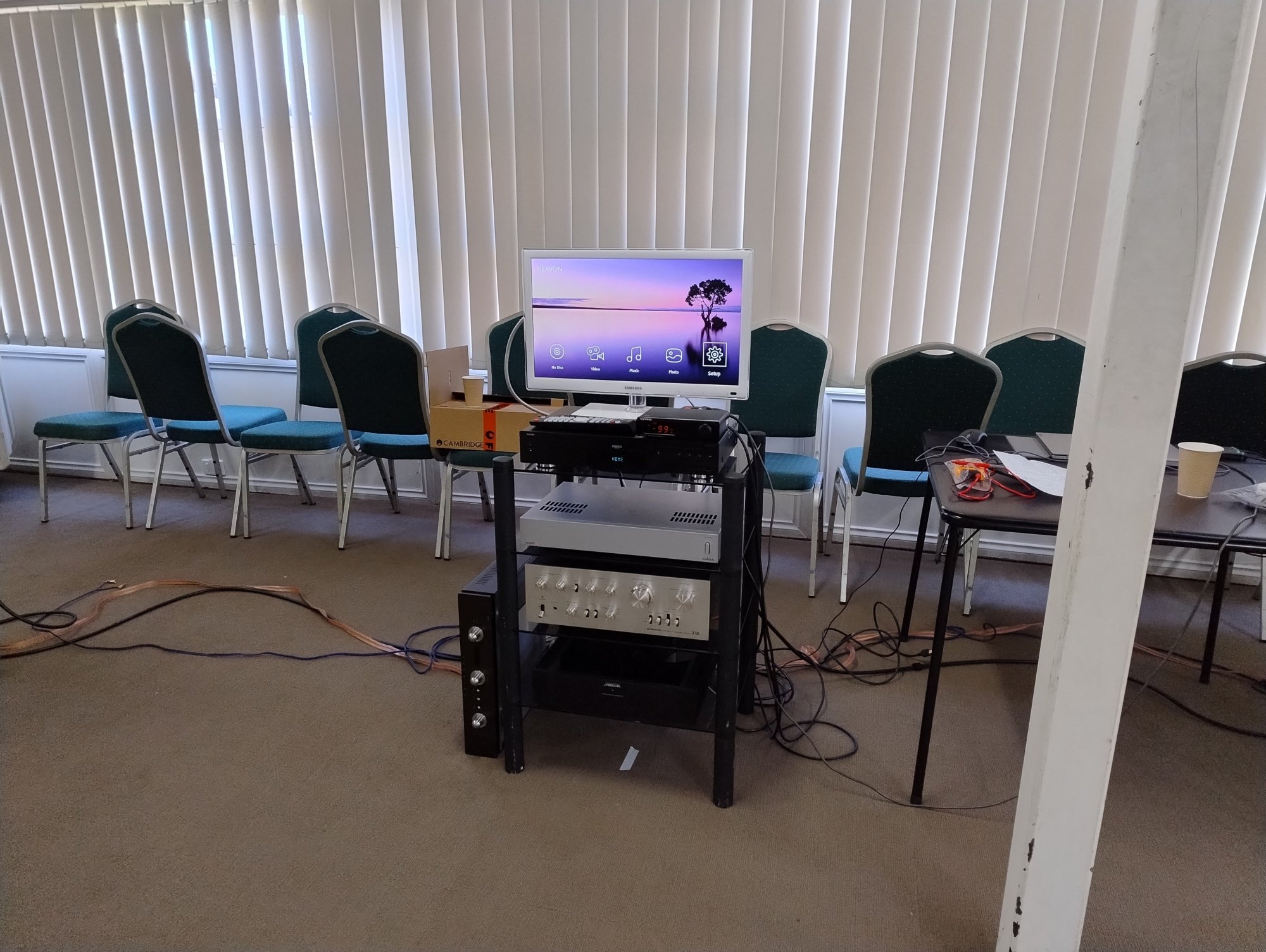

For the second half two power amps were used, one amp for each pair and fed directly from the Topping DAC.
Unfortunately it wasn't possible to find two identical power amps at short notice.
This presented a different issue as although the two amps had the same rated power and similar topology the input sensitivity was different by something like 3 ~ 4 dB.
Each amplifier was 100 WRMS PCh but somehow the Meridian 556 was the 'sweeter' of the two.
The USB source was somewhat gritty and harsh, the CD transport source was superior.
I suspect there was some interaction between the music software (Foobar 2000) and the Windows audio settings - see images below.
We did try one pair of speakers on their own and this had superior clarity to the stacked pairs.
There was speculation as to whether there was acoustic interference in the stacked configuration or differences in the amplifiers smearing the sound.
On the plus side the system filled the whole room effortlessly.

Since the meeting I have found out that the DM220s use 16 Ohm woofers wired in parallel, so no impedance issues running both pairs from a single source.
However Prof. JL had modified the crossovers in one pair and not the other which accounts for the different sound of one pair vs the other, as detected by a few of our more astute members.
LOL!  Well spotted  Paul..
Mods need to be equal to both sets of speakers, otherwise one enters a .... minefield (of sound).
Personally, I was tricked in believing that the two different amplifiers used (when bi-amped) were the cause as, the Audiolab 8000P  and the Meridian 556 are voiced quite differently.
Of course, when used working in parallel with different crossover specs, it could create an audio havoc.
