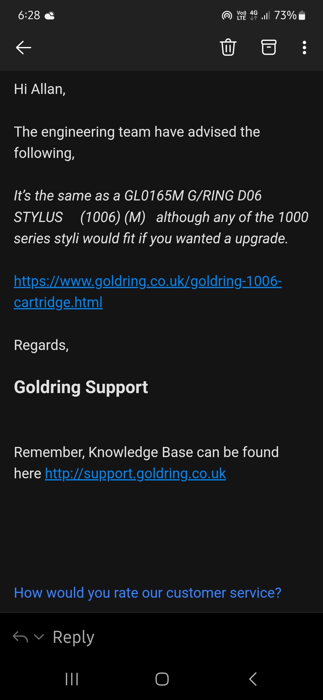

I've had this MM cart for probably 25 years, used for maybe 10hrs tops, it came with a Project 5.1 bought new back then but I changed out this cart soon after buying the table.
Anyway, decided to try it on a VPI classic this morning, wow man does this thing sing, it flawed me! Its right up there with a $2K LOMC, it just lacks a tad in dynamics and understandably so given its a MM however everything else is there in beautiful big gobs!
Anyone know what stylus it is? I know its a Goldring 1042 body but unsure of the stylus model. As you can see it has a Project logo on the Stylus body so obviously a joint thing between Project & Goldring back then. The current 1042 series has replaceable stylus model 1042-D42. Apparently Goldring upgraded the 1042 stylus several times over recent years so I'm lost as to what this Project labelled stylus may be.
I'm trying to ID it so I can make a decision if I should upgrade to the latest 1042-D42

5 minutes ago, Allan said:
thanks @Full Range, yes I read most of what your post states, but what I'm really after is what type of stylus the Project labelled one is that I have
It’s definitely a 1000 series cart as you mentioned a 1042
But this is an assumption and a quick deduction based on original price as Project had a choice of stylus from entry level to the standard Gyger S fitted to the 1042 body
My guess is the standard 1042 Gyger S
Happy to be proven correct or wrong by someone with more depth of knowledge

G'day Daz, I already checked the stylus for some ID, nothing on it but the cart body itself has "Made in England" pressed into it
Playing tunes with it now, its a mighty fine sounding cart indeed. I'm just hoping the stylus has been superseded with something worth upgrading too.. if only I can ID the stylus ?!?

My guess based on the 5.1 being a mid range turntable when it was new (I think they had 2.1 and 9.1 and probably others from memory) is that it's probably a 1006 or 1022.
I don't think they would have included the top 1000 series cartridge on the mid level turntable.
This is just a guess though so I could be completely wrong.

I have a Project 6.1 from that era and somewhere along the way I heard the Pro-Ject branded stylus was a 1006 on that cartridge body.
You’re not the only person to ask anyway! Unfortunately this thread is also inconclusive:

@RCAJack thanks, sadly that 2020 thread was inconclusive. I've emailed both Project and Goldring so hopefully this time they shed some light..
Its definitely a Goldring 1000 series body and I do know that Goldring revised the 1042 a few times, though I'm unsure of year for latest revision.
Hopefully as you say it is the 1006 cause plugging in the latest 1042 stylus should be a good upgrade, in any case as is it sure knows how to sing, it floored me yesterday!
