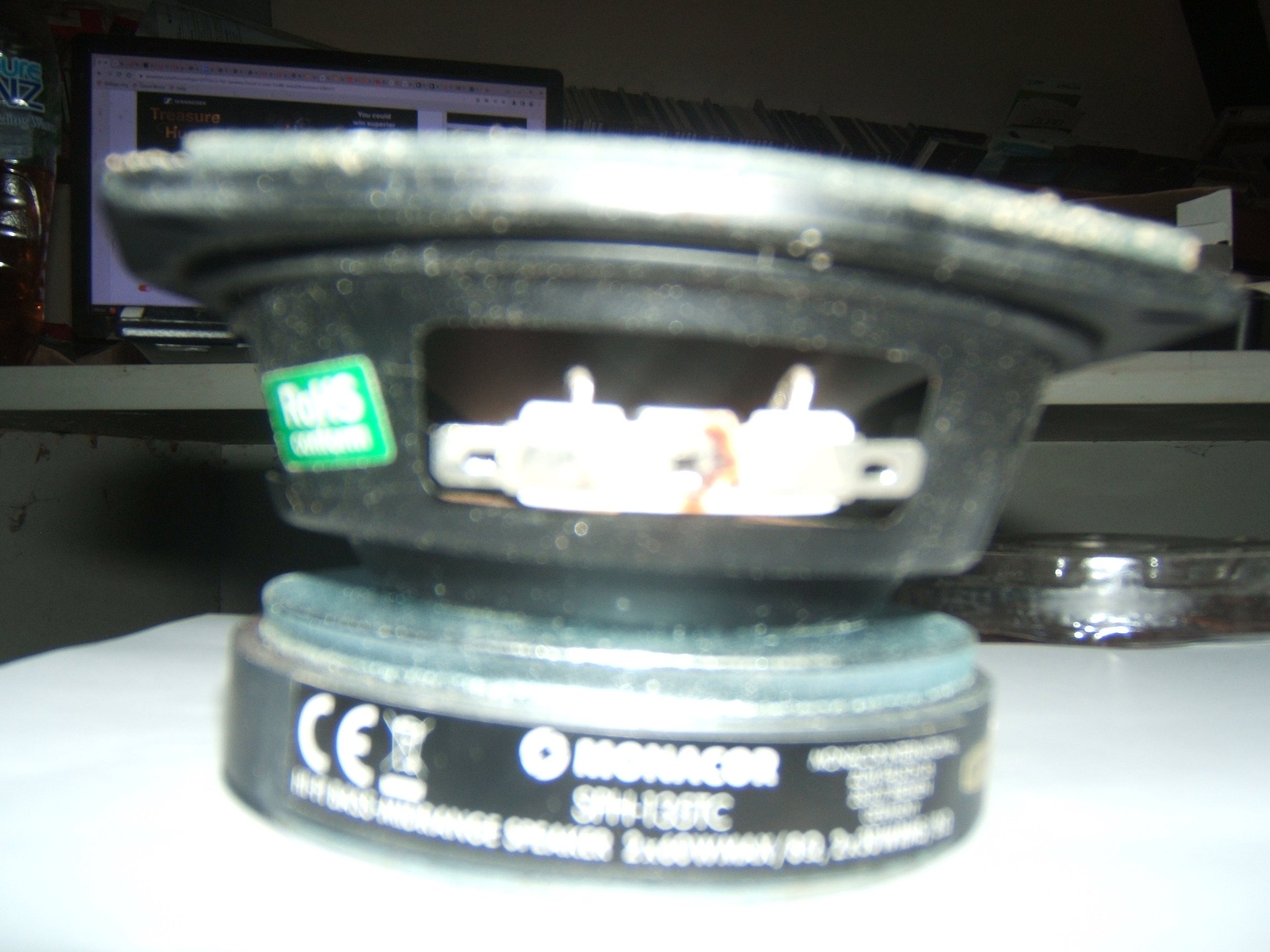

Monacors @ 16 ohm are a better driver than the Kef b110's IMO , having fitted a pair to JR149's - you have a bargain check dimensions first for fitting the Monacors  , but looks relatively straight forward

Thank you - good to know someone has had experience with doing basically the same thing. Did the bolt holes line up for your 149s, or did you have to rotate 45 degrees and drill new ones?
No bolt holes did not line up , and needed drilling new ones.  Might be different though for the Audax being replaced with Monacors  Mine are SPH 135TC
  • Thanks 1
Do you happen to know the bolt hole distance centre to centre? Monacor don't seem to list it. The Audax are 134mm across, +/- 0.5 ish
Posted (edited)
Monacors are 138mm centre of hole to centre of hole   but hole width in the frame  is 8mm , so  likely will be close to fit depending on bolt dimension and head width of the bolt. With a steady hand and a drill press another 3mm is possible inward to move inward the width of the frame hole , which might be the best option
and its all flat as well.
