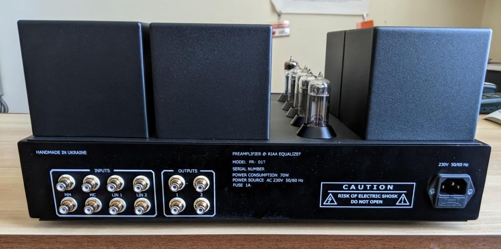

Ukrop Posted September 12 Share Posted September 12 Just now, Ukrop said: The passive preamp has several disadvantages that can be easily eliminated by introducing an amplification stage. But it will already be an active preamp. In the photo you can see several models of preamps that combine several options: an autotransformer volume control with 30 positions, a tube amplifier with an output transformer, two outputs, remote control. Options that the user can order are tone control, RIAA preamp, number of inputs, additional manual control and others. Link to comment Share on other sites More sharing options...
