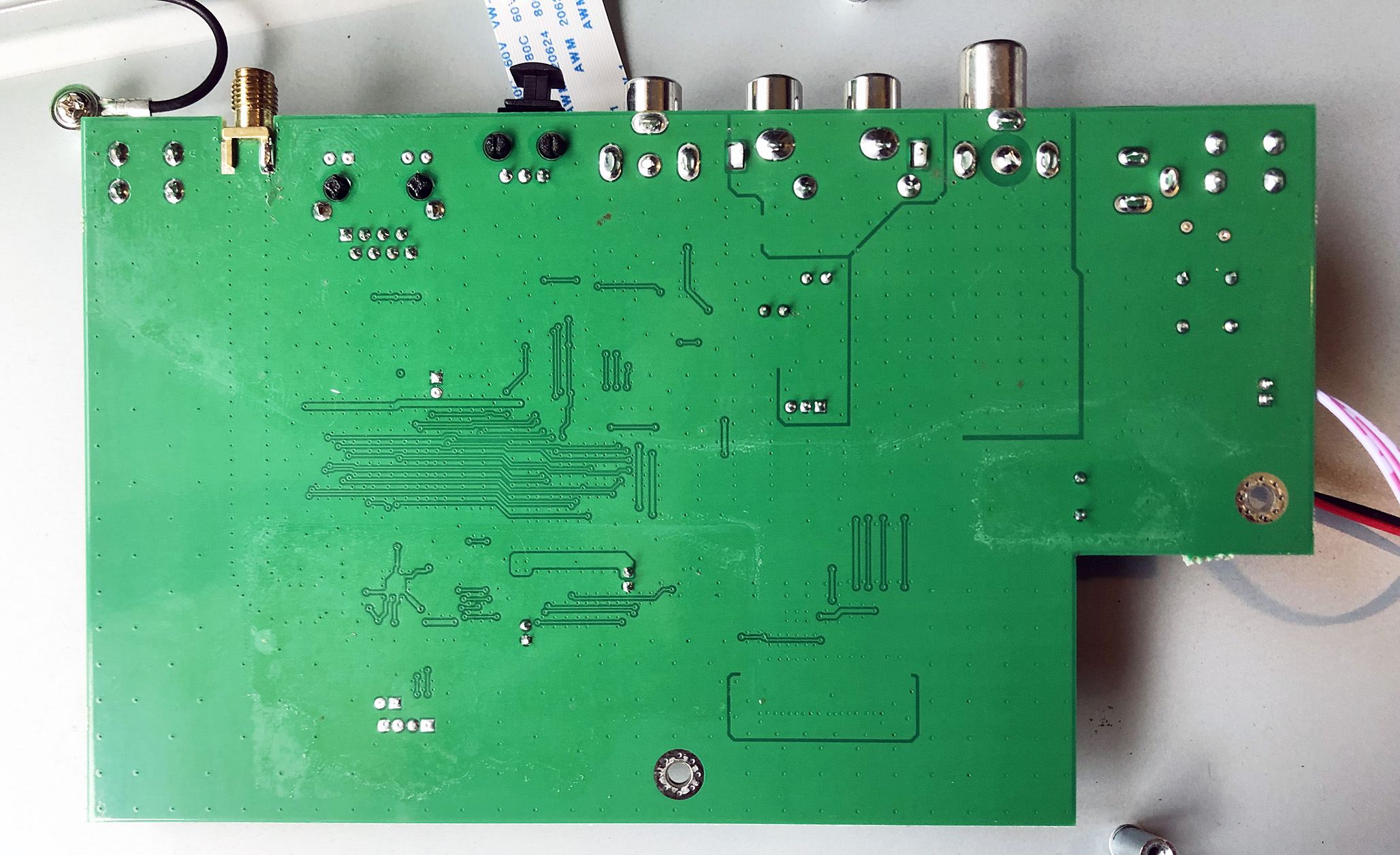

Quick postage! It arrived today.
Power is an external plug pack, so no transformer or SMPS inside the case.  Just the 2 PCBs, one behind the front panel and the other at the rear of the case.  Good to see plenty of breathing space between the various circuit segments on the main board.  Lots of spare real estate inside the case, but that's how the technology is these days.
Construction and soldering all looks very good.  Two tapped steel standoffs on the base for the main board plus 4 screws from the rear panel.  Two going into tapped metal brackets on the board and two self tappers into the plastic connector housings.  Very neat and solid design.  It's an all-metal case and weighs about the same as the WFT-1D, so doesn't slide around when you push a button.
DAC is a Nuvoton 24bit/192kHz device.  Nothing fancy, but probably appropriate for this product.
The chip includes the line output and headphone drivers and this is where I found a bit of a weakness.
Line output is fine, it's feeding the line input on a pair of Alesis powered mini-monitors.
But when I plugged my vintage Yamaha YH-2 headphones in, I had to set the volume to maximum to get a decent level from them.  The B&W P3s were better, but still needed a very high setting.
So any headphones used with this machine need to be very efficient.
It's a pity, because the Nuvoton chip also includes a 1W stereo amp which is unused in this product.  With the addition of a couple of series resistors these outputs could have provided a very capable headphone output.
Can't identify the RF module, but reception is very good and actually slightly more sensitive than the WFT-1D on both FM & DAB+.
