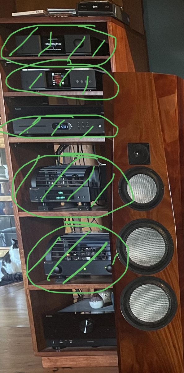

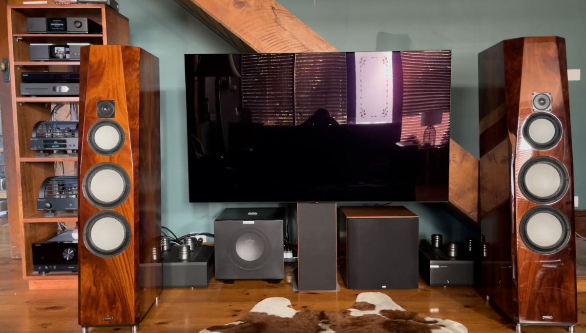

Thoughts please.
Looking at what I have, and where I am headed.
The rack has Auralic Aries G2.1, Auralic Sirius G2.1, PrimaLuna EVO 100 DAC, PrimaLuna EVO 400 preamp, and an Audiolab 6000CDT CD transport.
By the time I sell the DAC and buy either an Auralic Vega G2.1 DAC or the likes of a Mola Mola Tambaqui, and get quality interconnects and power cables, still a fair bit of coin to invest.
Or,
I could sell the lot and buy an Aurender A30
https://aurender.com/a30/
I suppose then I could get a dedicated quality audio rack instead of my home-made one.
Is there any reason why I should pursue either option, or is there a better option?
Amps currently Musical Fidelity M8-700M monoblocks but they’d be upgraded later.
Speakers are Tidal Contriva Diacera SE.
They are definitely staying.
Thanks.

Nice system! Anything wrong with it?

Nothing at all. Sounds wonderful. But there are improvements I could make. Bringing the rest of the hardware up to the quality of the speakers, including cables.
I figure if I start with the DAC, then cables and whatever else.
But, if looking at replacing the DAC, choosing what way to go from here. The Aurender is supposed to be a high end device, and would certainly tidy the room up with the massive reduction of equipment, removing the necessity to replace all the interconnects and expensive power cables too.
Or perhaps there is another way of proceeding that I haven’t considered.
I am all for simple and suggest either the Aurender A30 or start the simplification journey with the Auralic Vega 2.1 (streamer /DAC) or maybe Lumin X1/P1
It took me a while to realise how many boxes I had with a web of cables (see my About Me). I hope you will take this opportunity to simplify, sit back and enjoy the music...

That room that you have is beautiful, I love those hardwood floors. And from what I can see from the reflection on the TV, the view outside looks pretty stunning as well. However, that pretty bare listening room with all those hard surfaces is going to create a lot of reflections that will muddy the sound. "Room treatment" can come in the form of thick rugs and curtains, and choosing furniture that can absorb or diffuse the sound. I don't like the look of those studio foam panels either, at least not in a general purpose living room - so I can understand if your wife doesn't want them.
As for using room correction, there is definitely a learning curve. It took me at least a year before I understood what I was doing, and even now I am still learning better ways to do things. If anything, owning a mic is an important first step because it tells you immediately what is going on, provided you know how to interpret what you are measuring. Until you know how to interpret and act on the results, using DSP / room correction will likely take you backwards in terms of SQ. An obvious "free" way to get better sound is to start reading up on how to use your MiniDSP and putting in better filters.
Another "free" way to upgrade your sound is to reconsider the position of your subwoofers and how you are using them. You have two subs placed closely together, meaning one would excite the same peaks and nulls in your room as the other. Look around your room and see if there is somewhere you can place your second sub. Are you crossing over your subs to remove low bass frequencies from your main speakers?
