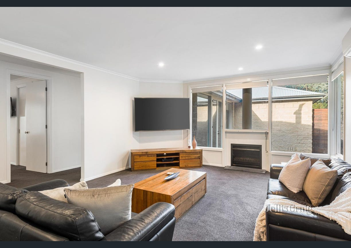

blybo Posted January 6, 2023 Share Posted January 6, 2023 So just before Christmas we sold our home, including all the home cinema equipment & furniture. It will be hard to leave a room (and the equipment) I put soo much hard work into but the purchaser went well above our reserve price and was keen to have it as is. The new home has a room we could convert to a HT room but the wife doesn't think we have used our current one enough in the last couple of years... This is the floorplan and the living room is the room I'd convert if going down that road, the "theatre" room is too small so will be the kids/secondary TV room. We also like the fact the living room is well away from the kids bedrooms as we wouldn't go over the top trying to stop sound leakage. The house is on 1.6 acres and the nearest neighbours home is some distance away Now the big question is do I go all out on renovations, a laser projector, acoustically transparent screen and hidden atmos speakers, or just go a large TV with a good sound system and save a whole lot of coin? How quickly do the new JVC laser projectors fire up? I admit that the delay of my current lamp projector warming up is a significant reason I often opted not to use our home theatre room in our current home. My other big issue is our puppy loved chewing on my acoustic treatments, so any new room would need to have treatments built in so we could invite him in with us. 1 Link to comment Share on other sites More sharing options...

SGS Posted January 6, 2023 Share Posted January 6, 2023 Mine is my lounge room so it's also for TV watching. As such I have just a TV, currently 65inch with hopes of going 85inch. With that I also have a good 7.2.4 which certainly makes watching TV more pleasurable and recliners. I find it a good compromise and one I won't change. Guess you need to decide. 1 Link to comment Share on other sites More sharing options...
blybo Posted January 7, 2023 Author Share Posted January 7, 2023 Yeah I’m leaning towards an 85” tv at this stage, but thinking about going krix in wall and in ceiling speakers for a neat finish. Still probably go with a processor and Elektra power amps. If I then decide to go projector down the track existing speakers would still work in with a Krix behind the screen speaker system 2ch system in the family room will also be awkward as the log fire is off set on the wall 2 Link to comment Share on other sites More sharing options...

betty boop Posted January 9, 2023 Share Posted January 9, 2023 7 hours ago, blybo said: Yes it is her dream property but she is also correct that we don't use the HT room nearly as much as we once did. I'm thinking a large TV and Atmos sound system to start with might be the best compromise till I discover if I really miss my HT room. I think have called it there. comes down to what want in the end. 85" is not large for a projector screen and its not small either for a TV. I love that we can easily shut a few blinds and watch a movie with a projector. but i get that isnt for everyone we havent done that much to our room. just taking a bit of care in setup, making best of it with furnishings. yes can spend about $250k on converting it to dedicated room as have seem some do with panelled walls hiding the treatments, AT screens etc etc but not everyone has that budget or inclination. it looks a lovely room and id personally keep it as living room as possible and make it as usable and capable as possible within your own needs and limitations. I've added a fair few speakers over the years to my room, planning to add more and a couple of more subs if thats possible in my non dedicated room i think its possible in any really hehe 4 Link to comment Share on other sites More sharing options...
Tweaky Posted January 9, 2023 Share Posted January 9, 2023 (edited) I just did a quick calculation given the room dimensions shown in the floor plan for the proposed new HT room. Given that I am presuming you'd want around 1m to 1.5m behind the seating to move around, seeing where the room entrance is, and where the windows start on the wall where you intend to mount either a PJ screen or a TV, it's very very close to the same sort of seat to screen ratio as I have at my place. A 83/85" TV would be ideal screen size, filling your field of view without having to move your eyes or head to see the side ends of the screen. Should you go a Large TV or Laser PJ ? Pro's and con's with both. PJ-Pro's Can go larger screen size easily if found you can get away with it in the room. A Laser PJ will probably have a longer life span without PQ degradation over time than any current TV. Far less chance of having screen nastiness like Banding, Dirty screen effect or Vignetting.....No Panel Lottery. A Laser PJ will probably stay in a calibrated state longer once done, than a Lamp based PJ or TV, although you will need to pay a pro with very high end equipment to do it {Tony O'Brien - Clarity Calibrations, told me his current metering gear is getting updated to better calibrate Laser PJ's and QD-OLED TV's....Although he's so not happy about having to fork out the big $$ for it ] CON's Possibly needing to have a darkened, if not totally darkened room at all times to get the best PQ. Having to run long HDMI 2.1 cables and mount the PJ above and behind the seating, adding complexity and cost to install. None of the current JVC PJ's do Dolby Vision as far as I can see from reading the spec's.....Dolby Vision is much better than HDR-10+ with content coded with it IMHO, especially once a separate calibration has been done for it Not as bright as the newest TV's. Large TV - Pro's Probably a brighter picture than the Laser PJ, depends which PJ and/or TV you get.....Newest WOLED and QD_OLED TV's are plenty bright, still not as quite as bright as the best LED/LCD but pretty close. No need for cabling behind the seating, or having a PJ hanging from the ceiling, overall much neater, less room invasive setup Probably can get away with not needing a darkened room at all times, again depends on what type of TV you get.....Watching 4K UHDR content on a calibrated QD-OLED TV in total darkness is the best PQ I've ever seen.....the extended colour gamut and colour saturation and infinite contrast is jaw droppingly good. Cons Limited choice of "Quality TV's" in 83/85" and above sizes and only LG and SONY TV's do Dolby Vision, not Samsung. Depending on type of Panel Tech used, possibility of screen nastiness like Banding, Dirty Screen effect and Vignetting [Panel Lottery] with WOLED type TV's, reports of these problems tend to happen on WOLED TV's 80+" size and above the most, and maybe QD-OLED TV's, which has only been available at Max 65" screen size until recent CES 2023 where largest screen size is now 77", they have had pristine panels as a rule so far.....so that's a unknown with this ATM. WOLED and QD-OLED have a half life of 35,000 hours before picture starts to dim like old CRT TV's. QLED - MINI LED/LCD TV's can't do true Black like WOLED /QD-OLED, although with the top 2022 models there is not really that much in it TBH from comparisons I've recently done with top WOLED/ QD-OLED 2022 model TV's. Some QLED-Mini LED/LCD can suffer from limited angle of view to some extent, if you are not sitting directly in front of the TV the sides can look washed out. QLED/MiniLED/LCD TV can still suffer from blooming, only really noticeable when subtitles are showing on the best 2022 model FALD TV's Edited January 9, 2023 by Tweaky 1 1 Link to comment Share on other sites More sharing options...
blybo Posted January 10, 2023 Author Share Posted January 10, 2023 3 hours ago, Tweaky said: Limited choice of "Quality TV's" in 83/85" and above sizes and only LG and SONY TV's do Dolby Vision, not Samsung. Yeah I think the Sony X95K is the way I'd go. We recently got my parents a lower spec 65" Sony and I'm very happy with the UI and how it faultlessly controls his Marantz AVR for family ease of use. We lived there for several weeks while the sales campaign on our house took place, so got quite comfortable with it's smart features too. An 85" TV is roughly 1900mm wide so it should leave just enough room for Krix SX Megaphonix in walls as my LCR combo, but I'll have to wait till we are in to get exact measurements of how much wall real-estate is lost with windows and diagonals. 3 hours ago, Tweaky said: Given that I am presuming you'd want around 1m to 1.5m behind the seating to move around, seeing where the room entrance is, and where the windows start on the wall where you intend to mount either a PJ screen or a TV, it's very very close to the same sort of seat to screen ratio as I have at my place. We sit 3.8m from a 130" cinema scope screen in our current HT room, which equates to 103" for 16:9 material, so we will be losing some "seat to screen ratio" immersion for movie viewing but suspect will be a good sweet spot for everyday use. I will also make the entrance to the room a single doorway along with a solid door with proper acoustic seals all round. Again this door seal was a weakness with my current room. 18 hours ago, betty boop said: I've added a fair few speakers over the years to my room, planning to add more and a couple of more subs if thats possible in my non dedicated room i think its possible in any really hehe Hehe, yes I know. Finally I'll also have under floor and in ceiling space to run cables. Because I've sold all my existing gear, I have a clean slate equipment wise to choose from. I'm leaning towards a Marantz Cinema 40 and a 7ch Elecktra power amp to run everything. From what I've read the pre section of the new Cinema series is a big step up from existing Marantz AVRs and the reason there is no 2nd tier processor in the new range. THe possibility of 4 subs and Dirac live to play with is certainly tempting. I always felt it was my subs in my existing system that was the weak point. That will not happen again. 1 Link to comment Share on other sites More sharing options...
