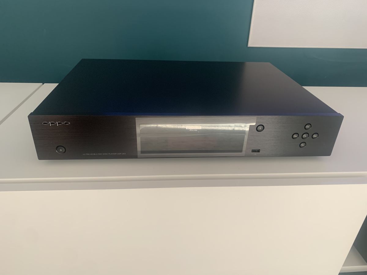

Received the Oppo UDP-203 a couple of days ago. Will set it up today while the interstate visitors are away for a cpl of days and I have my music / spare room to myself again.ย

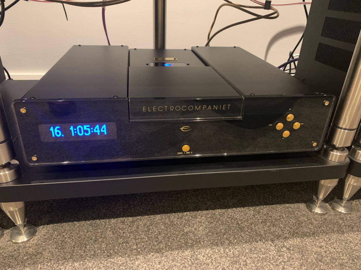

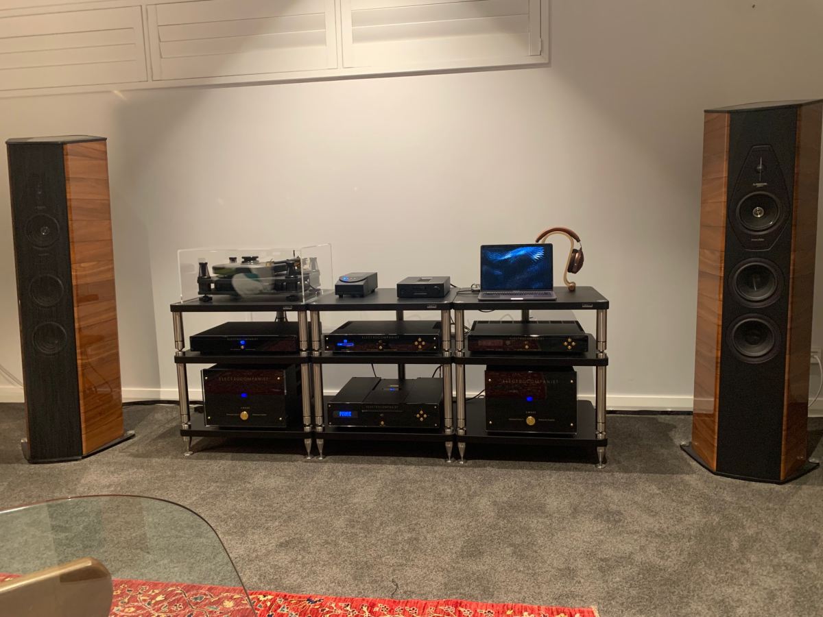

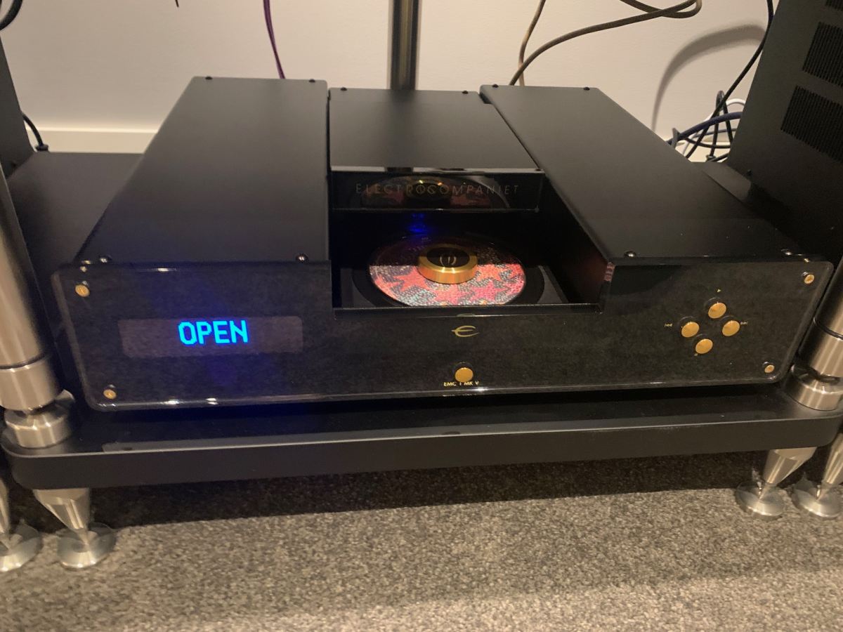

Santa brought me the final piece of my HiFi puzzle. Integrates very nicely with the rest of the system and sounds superb. Last gift under the tree. Our cats of course were more interested in playing in the empty boxes.
Please excuse the dangling wires!! I am playing around with different cable options and will tidy them when I get the right combination.
Wow very tidy system (and no doubt sounding system)appeals to my ocd - Out of interest what racks are you using?ย
  • Author
That ec gear is beautiful. Great systemย
ย
Theyre SolidSteel racks
ย
