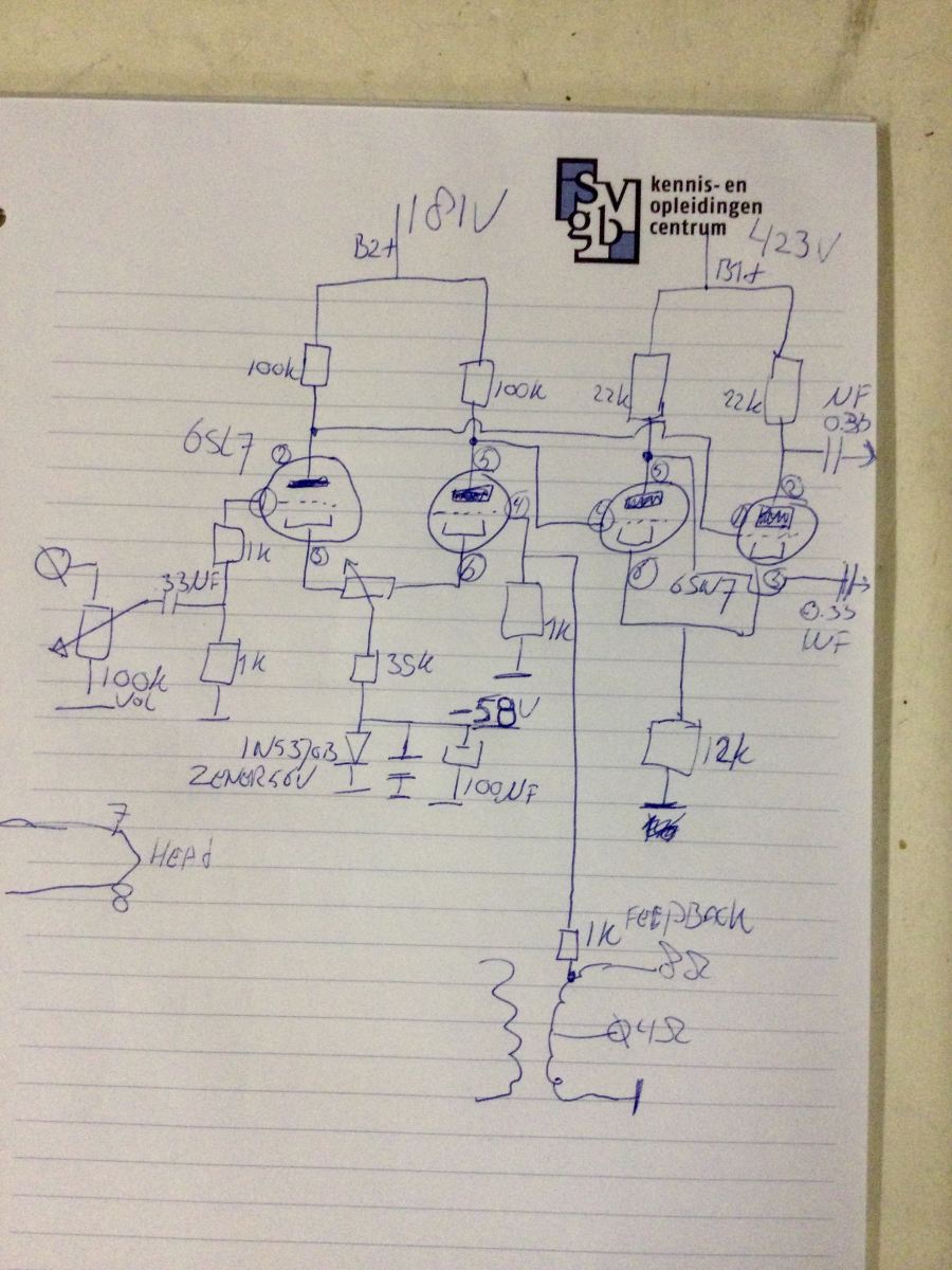

I know now that the schema of the amp is not original anymore.
The company Hay-End in the Netherlands modified The pre-amp of this Cayin. I draw the schema. He put two long tailed pairs one after the other. In the first long tailed pair he put a DC offset adjustment.
I must check if all the values of the resistors are correct.
