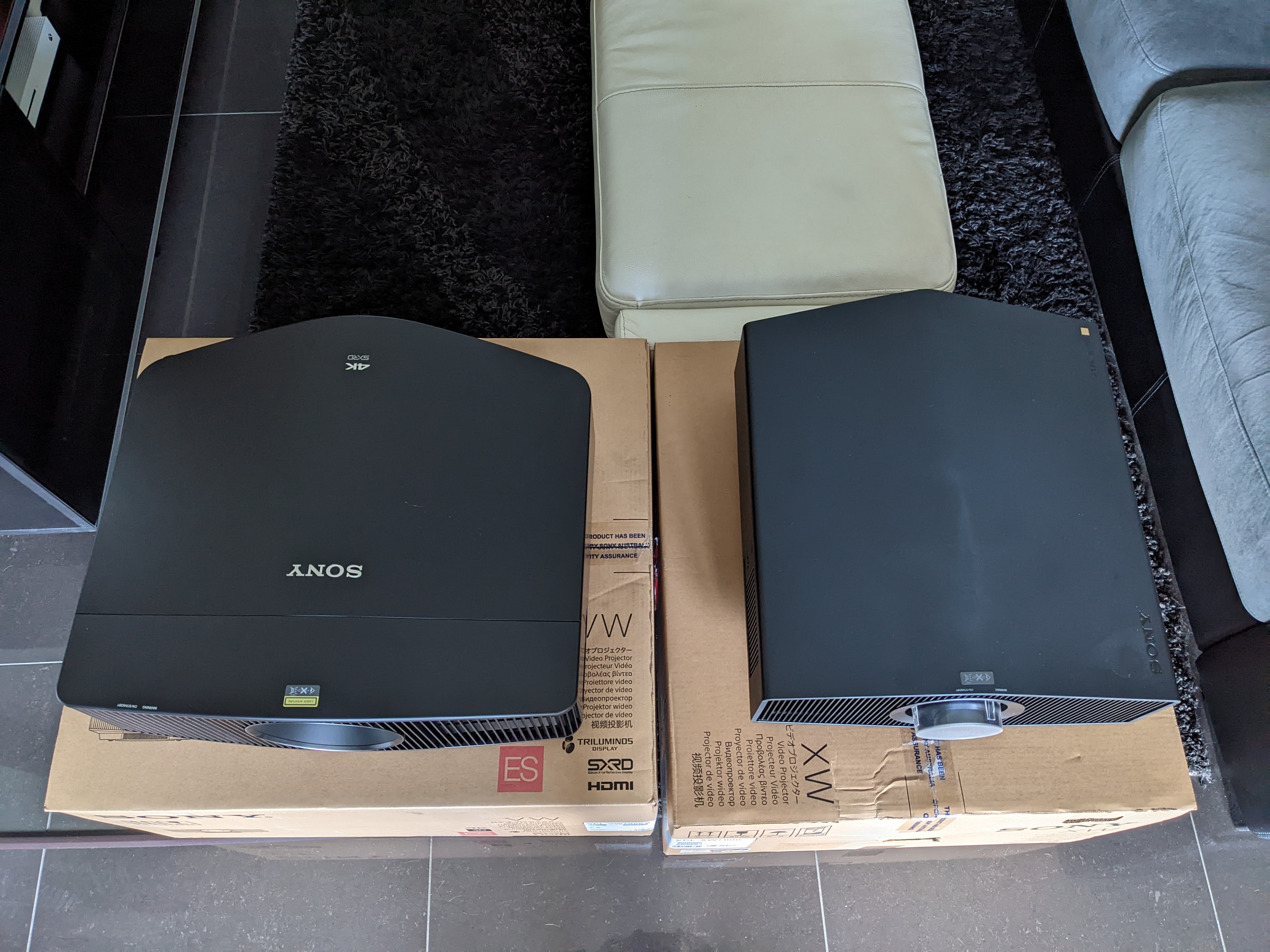

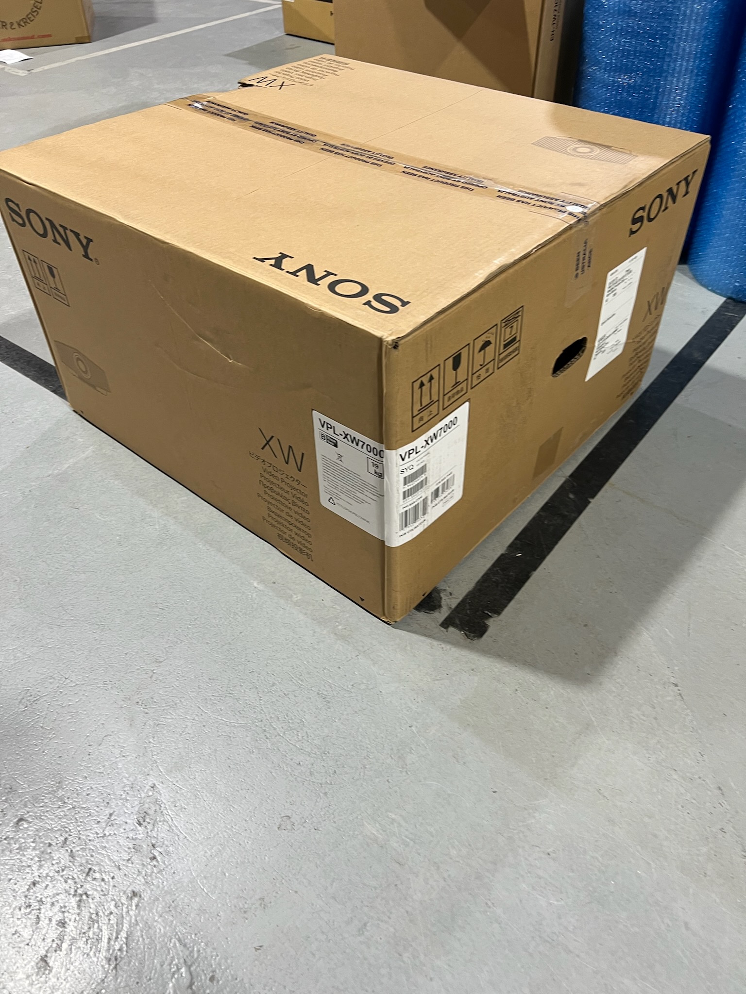

Out with old, in with the new.  Installed the XW7000 today.
The new XW is significantly lighter (and narrower) than the VW790ES. I knew this going in but actually seeing and holding them surprised me how much the XW has slimmed down.  Another surprise was the XW looks much prettier in person than in photos. In most images I thought the XW series looked a little 'cheap', no so in the flesh.
Random fact - the mounting holes are identical between the VW and XW series... who knew.
I have  only just started dialing in picture settings so will report back with some viewing impressions over the coming days/weeks as I get some screen time.
  • Like 4

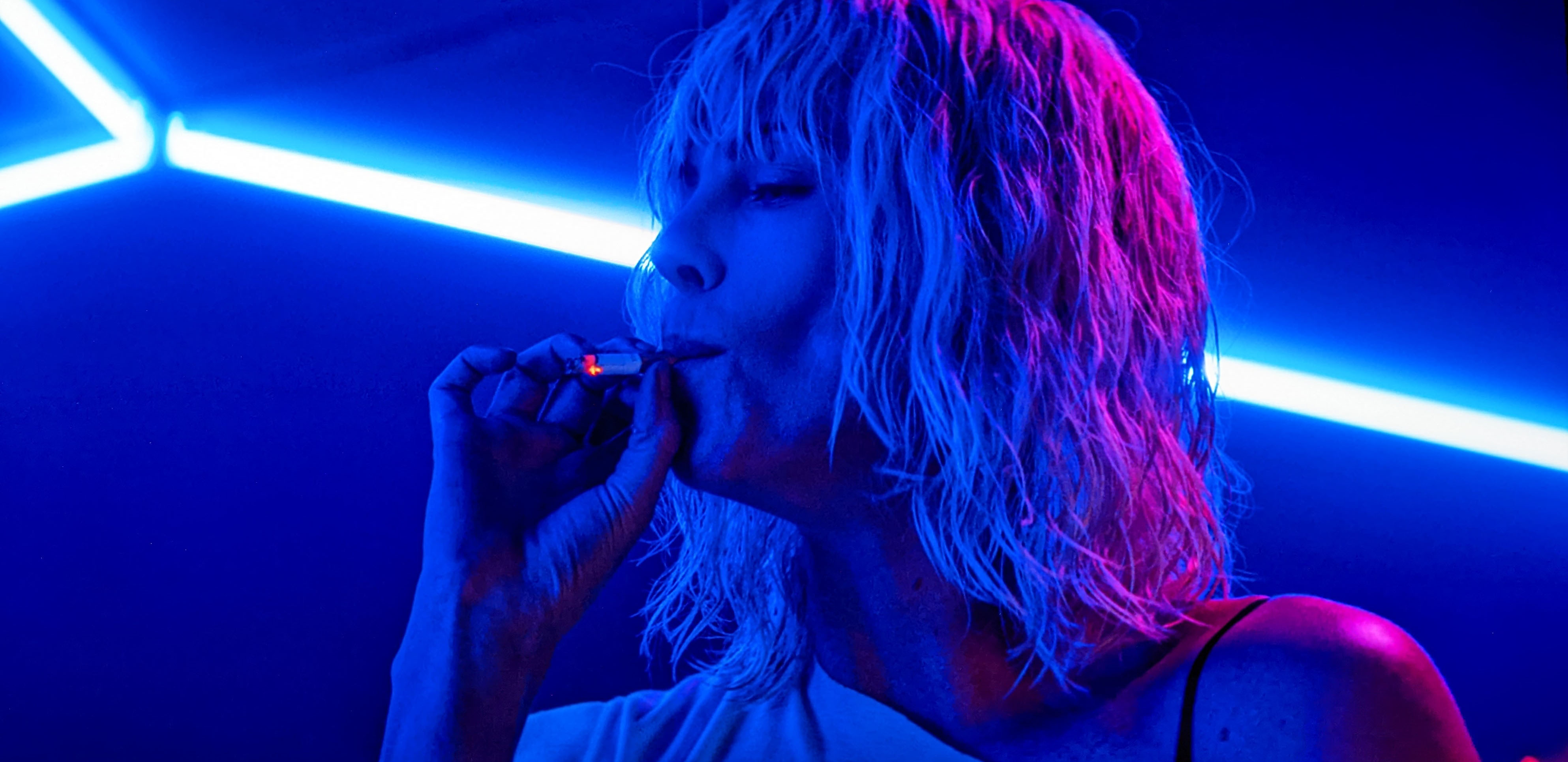

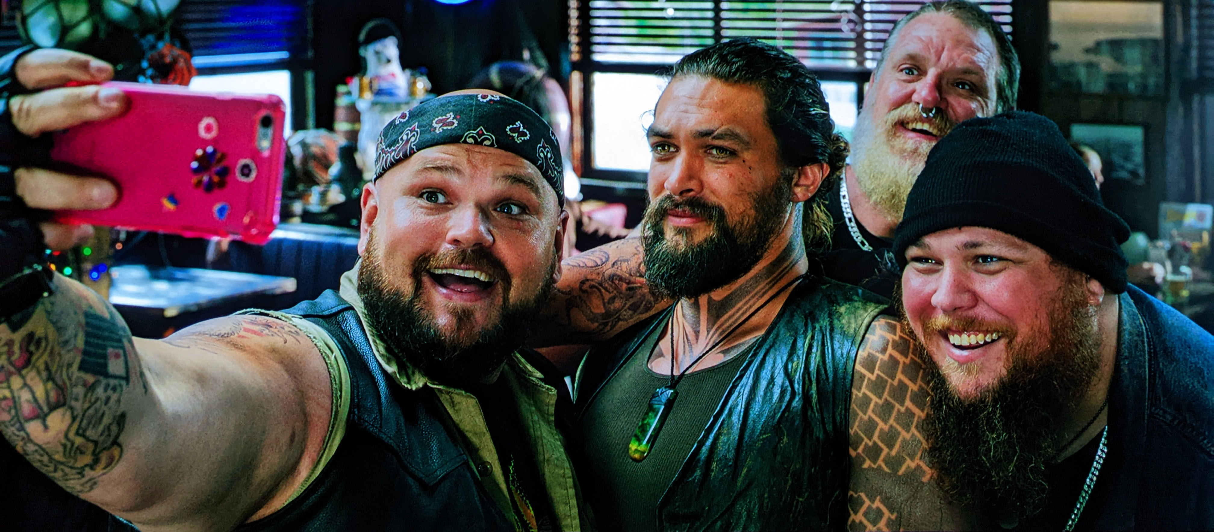

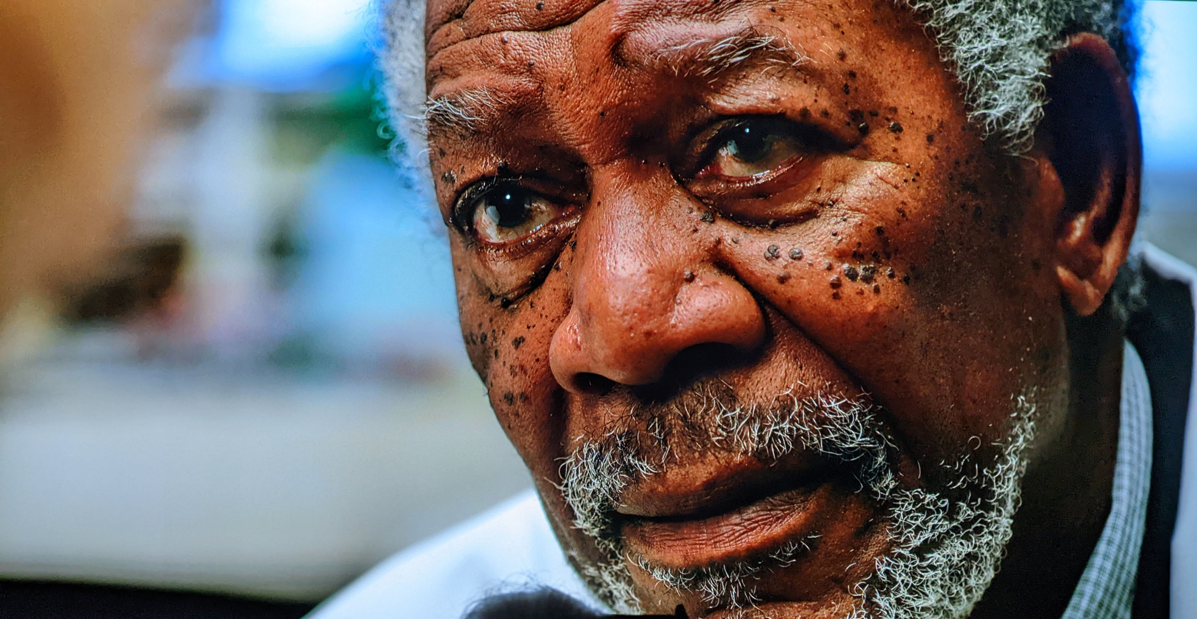

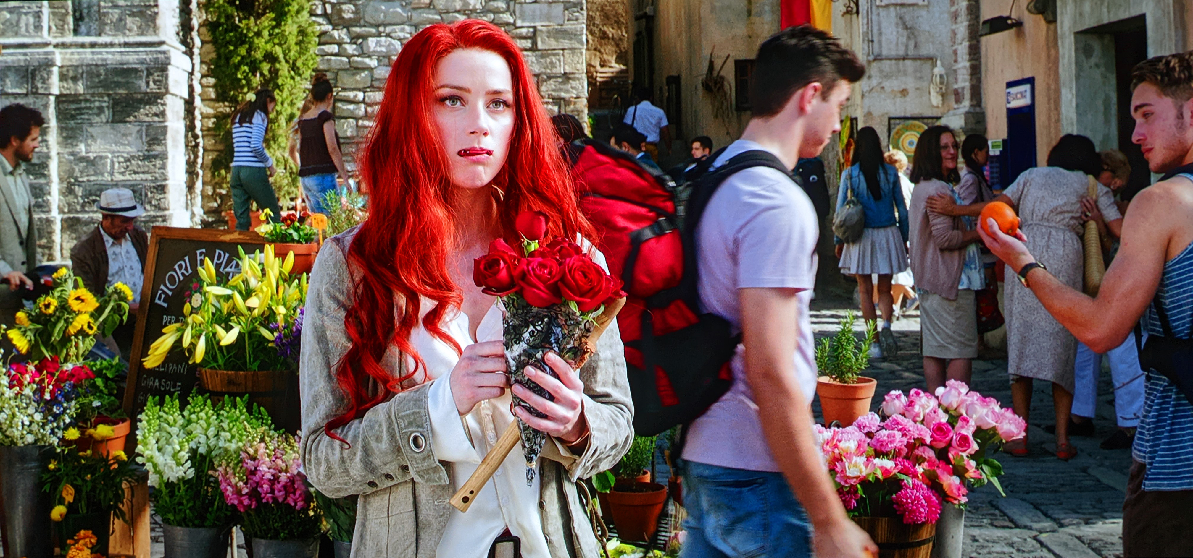

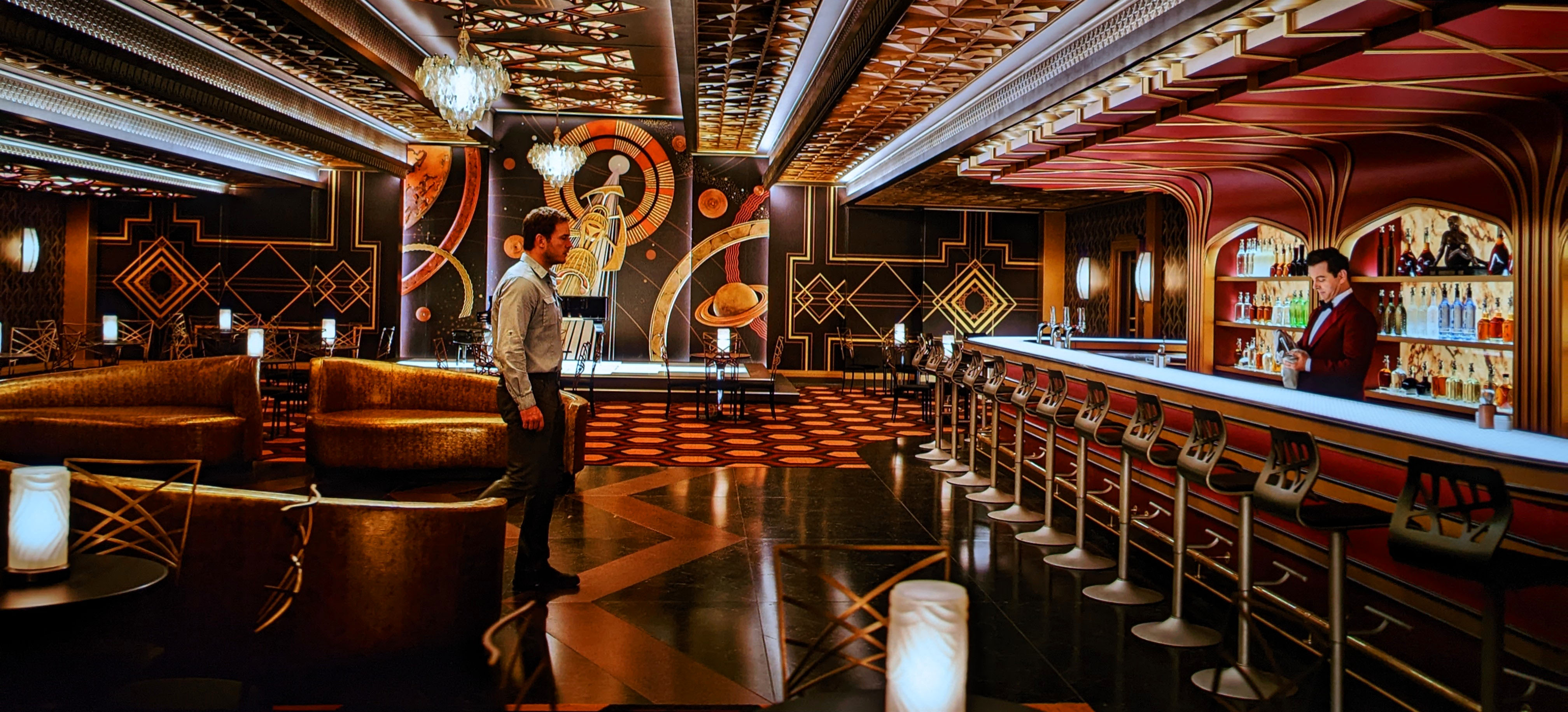

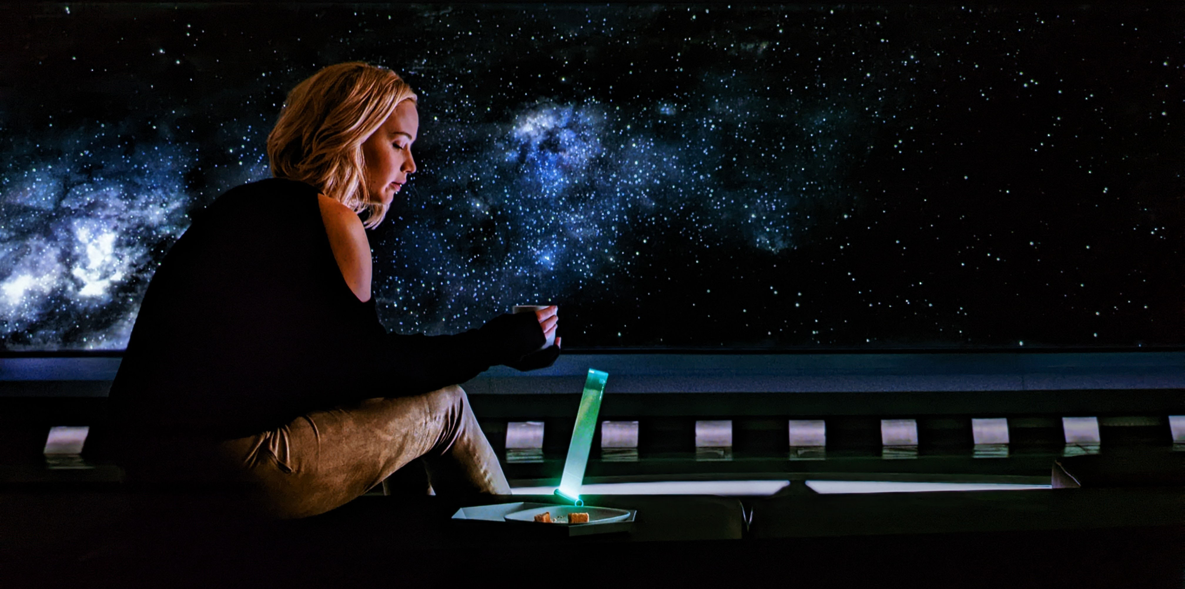

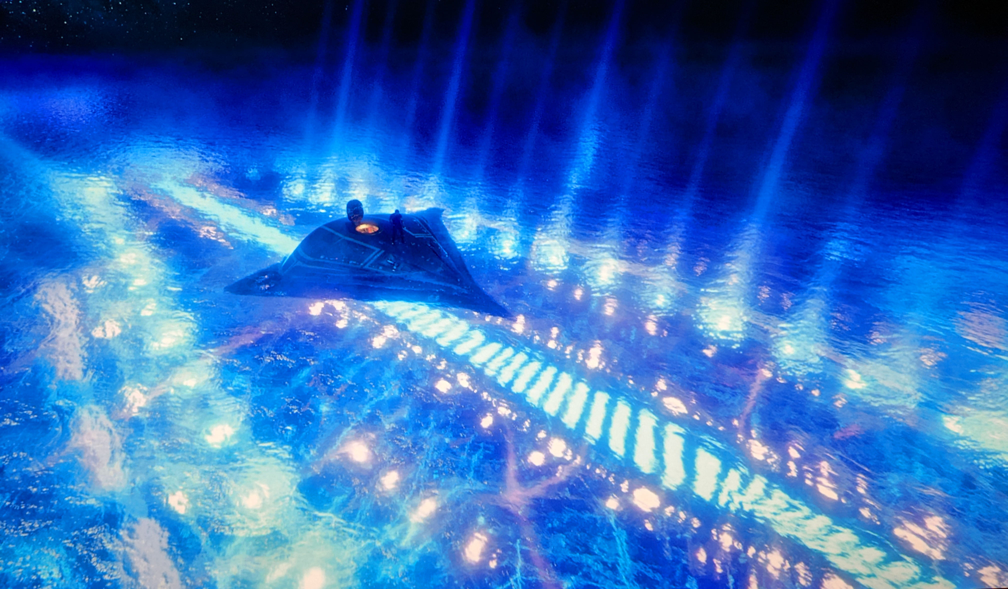

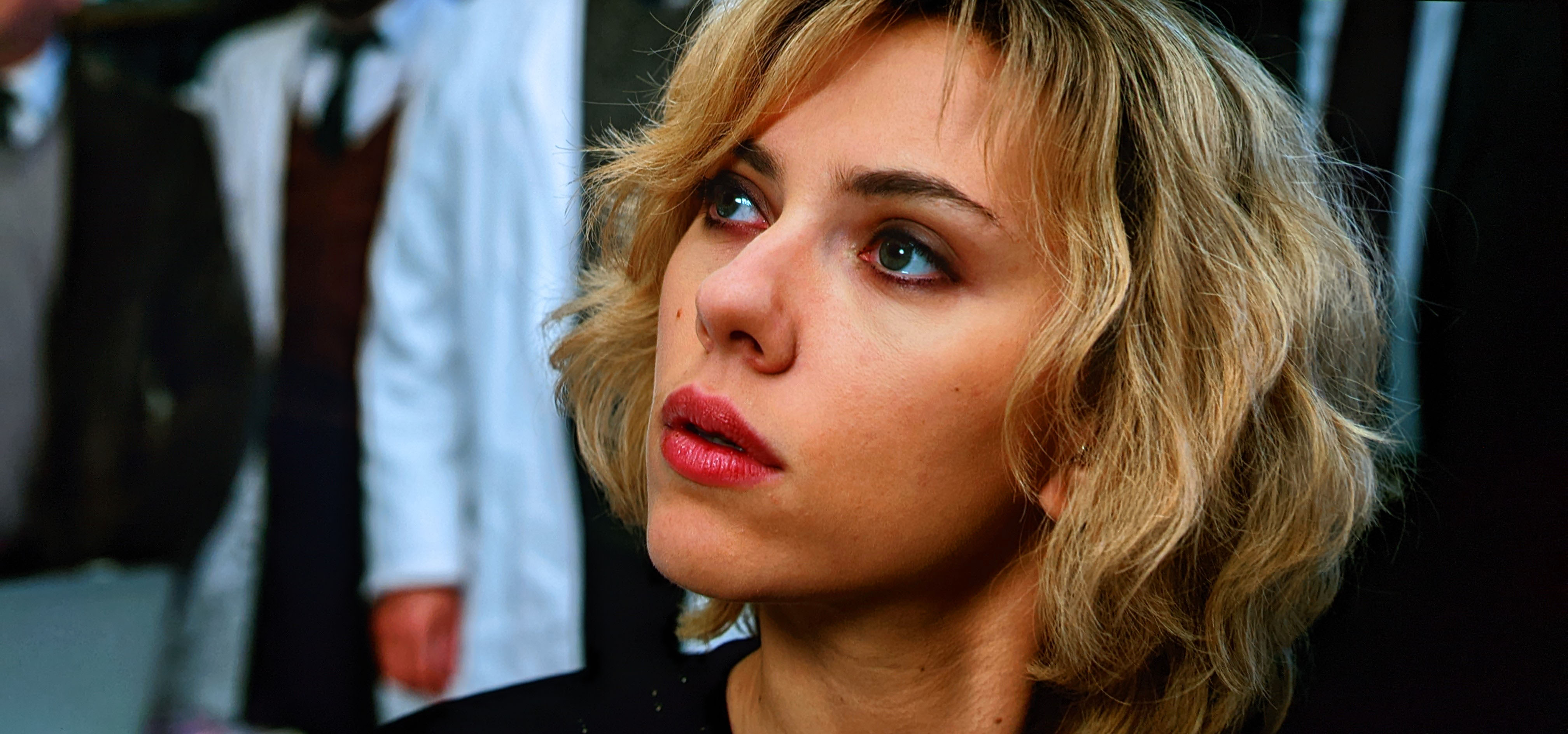

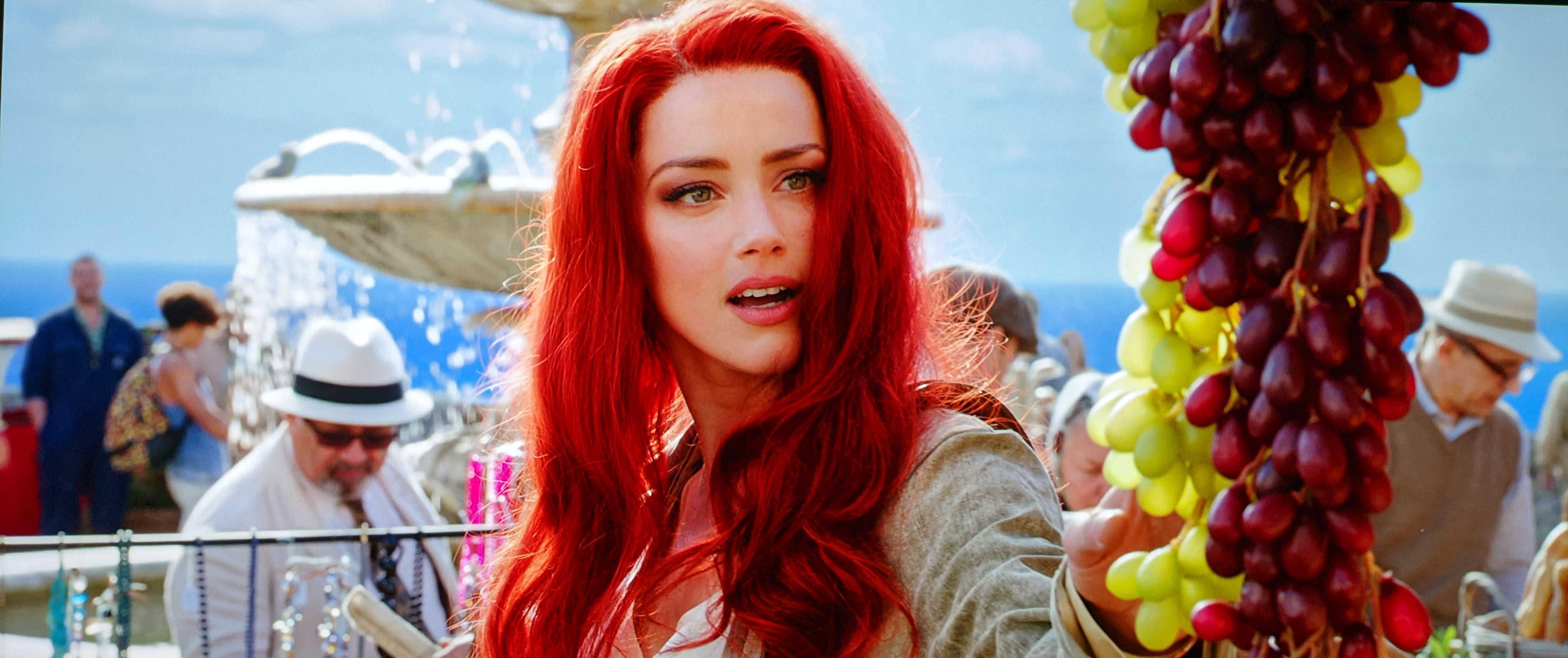

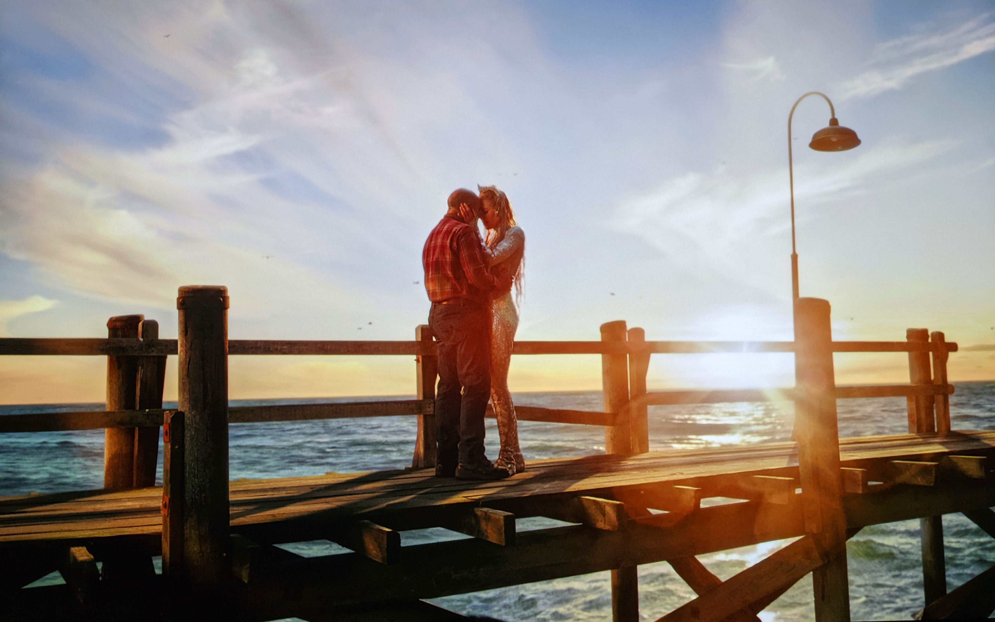

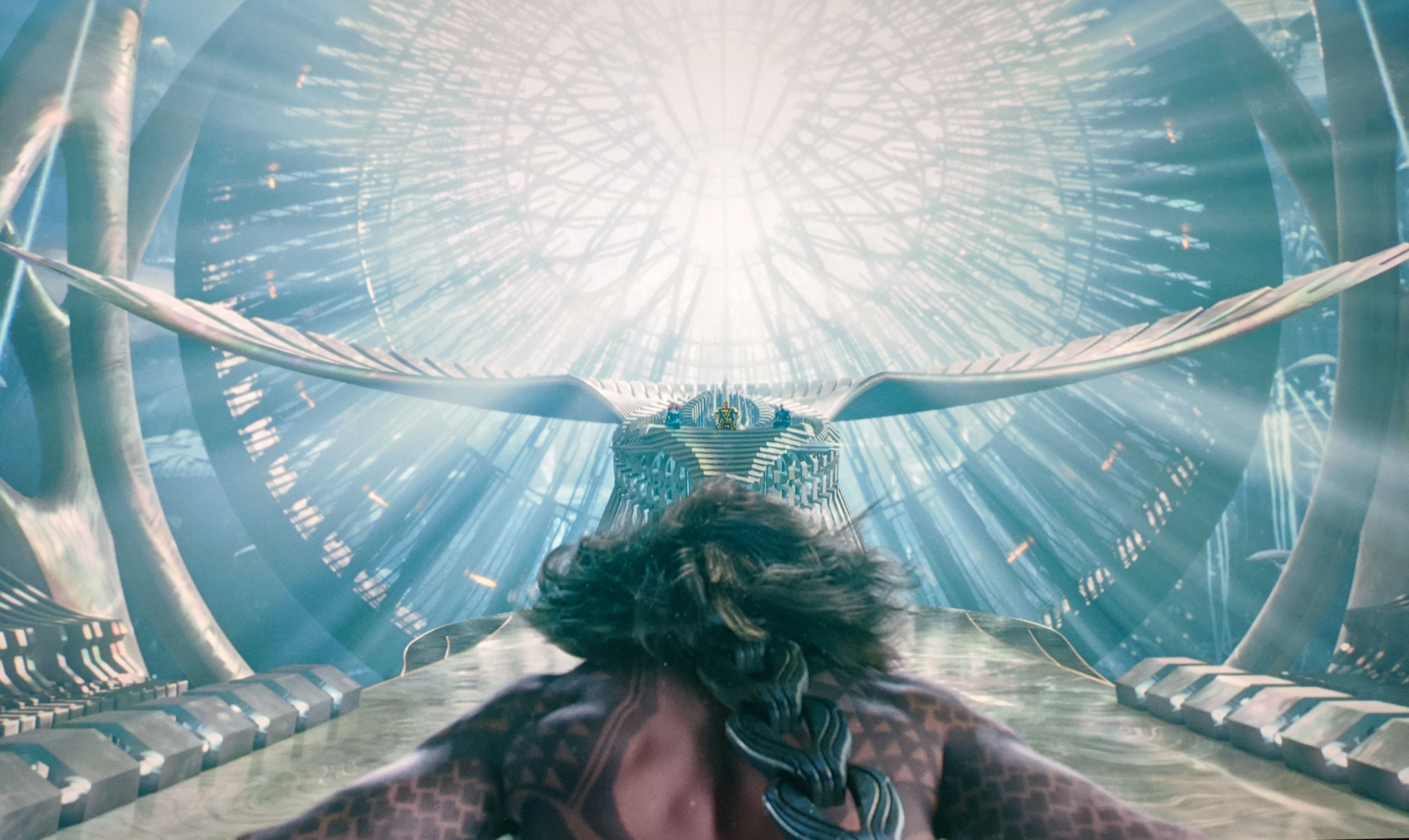

OK, I'm a few days in to XW7000 ownership now, so how's it going?  Yeah.... not bad :)
Let me preface my impressions and experience with some context regarding my setup. The XW7000 is feed by a Lumagen 5244, so because of this I am deliberately not using many of the new XW features, specifically around HDR (and before you ask, sorry I won't be doing any testing without the LRP in place) Also, much of the comments are based on comparisons to the previous VW790.  Not too many surprises here -
What I like
  • Brighter - 2000 vs 3200 lumens - not as dramatic difference as I though it would make but a nice bump.
  • Sharper lens - Better edge to edge sharpness than the 790, although I find DFO on the XW adds too much noise.
  • Improved blacks - Not by much.
  • Reduced input lag - I spend a good amount of time gaming so this is nice.
  • Web UI & network controls - Love the new web UI, controls and the ability to network monitor (SNMP)
Not so much
  • Fan noise - Noticeably louder compared to the 790.  For reference, the projector if ceiling mounted  behind and to the right of me approx 2-3M away.
  • Heat - Pushes out more heat into the room. (I do like the ability to now see air intake temp info)
A few pics taken with phone of some of the usual suspects.  Settings provided -
Sony XW7000ES
Calib. preset: Reference
Reality Creation: Off
Cinema Black Pro > Laser light setting: 75
Cinema Black Pro > Dynamic HDR Enhancer: Mid
Cinema Black Pro > Laser light setting: Dynamic control: Off
Contrast: Max
Brightness: 51
Colour: 50
Hue: 50
Color temp: D65
Sharpness: 55
Expert setting > Smooth gradation: Off
Expert setting > Gamma correction: 2.4
Expert setting > Color correction: Off
Expert setting > Live Color Enhancer: Low
Expert setting > Color space: BT.2020
Expert setting > Input lag reduction: On
Lumagen 5244
LowRatio: 31
DynPad: 1
DeSat: Auto
Global Maxlight: 600
Sharp V:4 H:4
Black: -1.75
White: 1
Source: Zidoo Z1000 Pro
File format: BDMV
Photos: Google Pixel 5 (handheld) Auto
*Note - the pics appear a little bit of an odd tint compared to IRL.  Suspect WB is off on camera but you get the idea.
Edited by xPLAYRZx
  • Like 9
