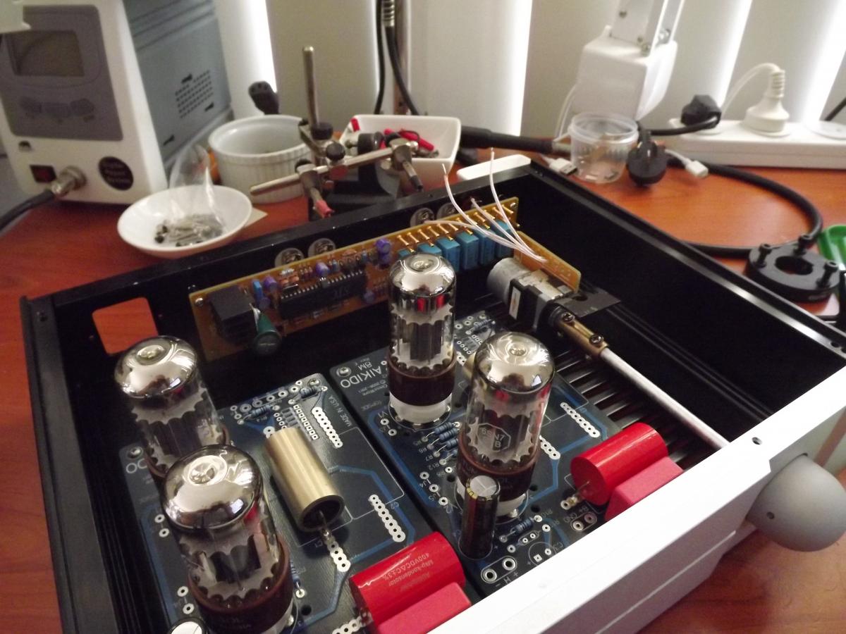

Gordon Macfarlane Posted August 30, 2013 Posted August 30, 2013 Hi guy's now that I have completed construction of the boards I thought I would post some pics of my new line-stage : The chassis and volume control/switch matrix are on their way. I still have to get the power plugs and sockets to go between the psu and linestage and I realised last night that I have run out of Neotech occ hook up wire. The next stage is to test all the boards via a variac etc b4 moving onto building everything into the cases. I have to admit that this kit is a bit beyond my electronics understanding but I was able to follow enough to build the boards and Alan (Monkeyboi) has very kindly offered to help me with the difficult stuff and saftey considerations. Cheers, Gordon 4

Gordon Macfarlane Posted December 1, 2013 Author Posted December 1, 2013 (edited) Hi guys , yet another update to the not quite finished pre. I have finally finished wiring up the line stage : Back plane with inputs , ouputs and control circuitry. Edited December 1, 2013 by Ozcall
Gordon Macfarlane Posted December 2, 2013 Author Posted December 2, 2013 Whats the 2 atomic bomb on the center? Ampohm caps wrapped in heatshrink to prevent the metal cannister shorting against the pcb board.
