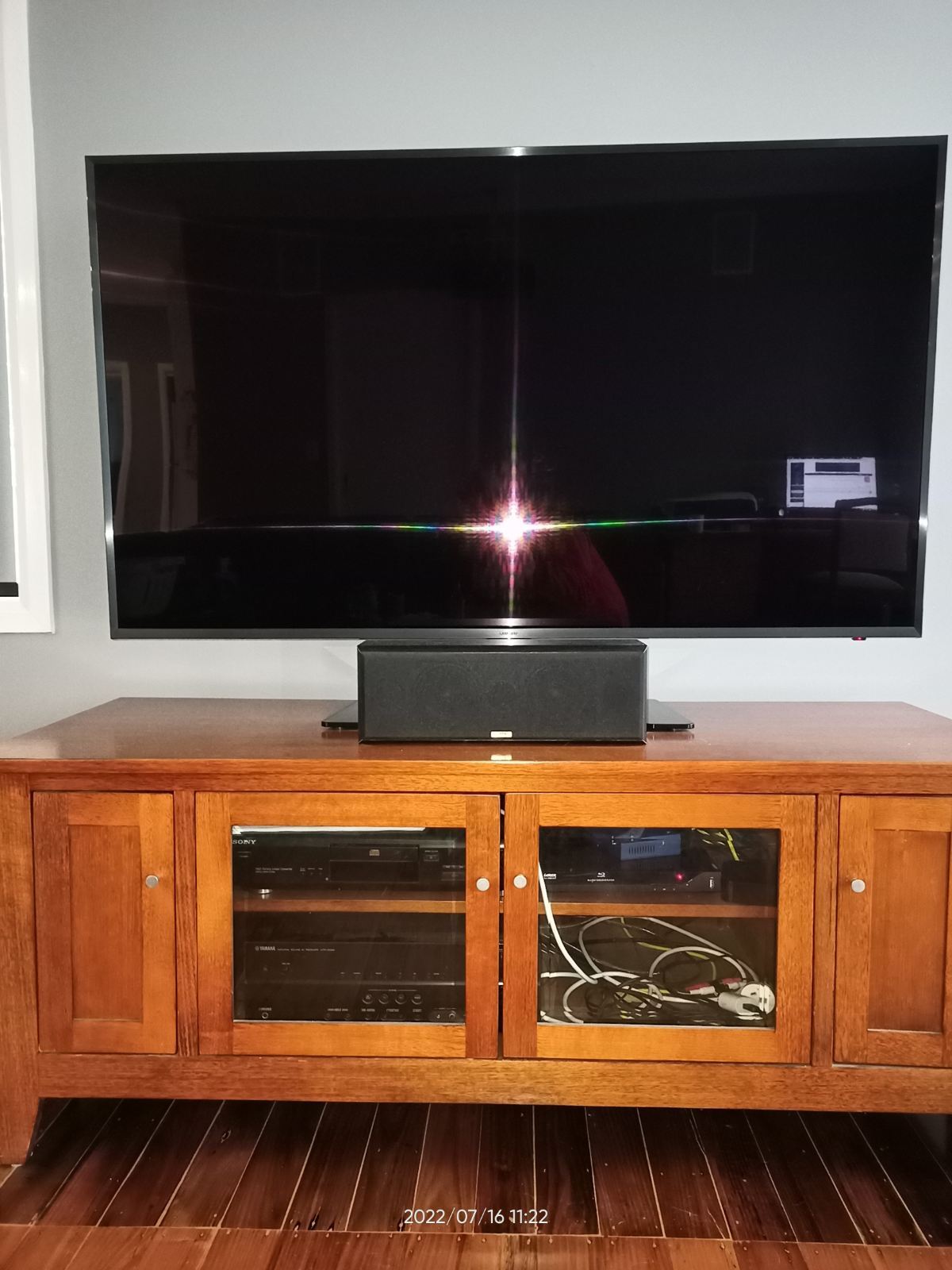

Did exactly the same thing that you are contemplating with a FITUEYES tv stand as well.
Picture says a thousand words, this is with a large Focal CC800VW speaker...
  • Like 1

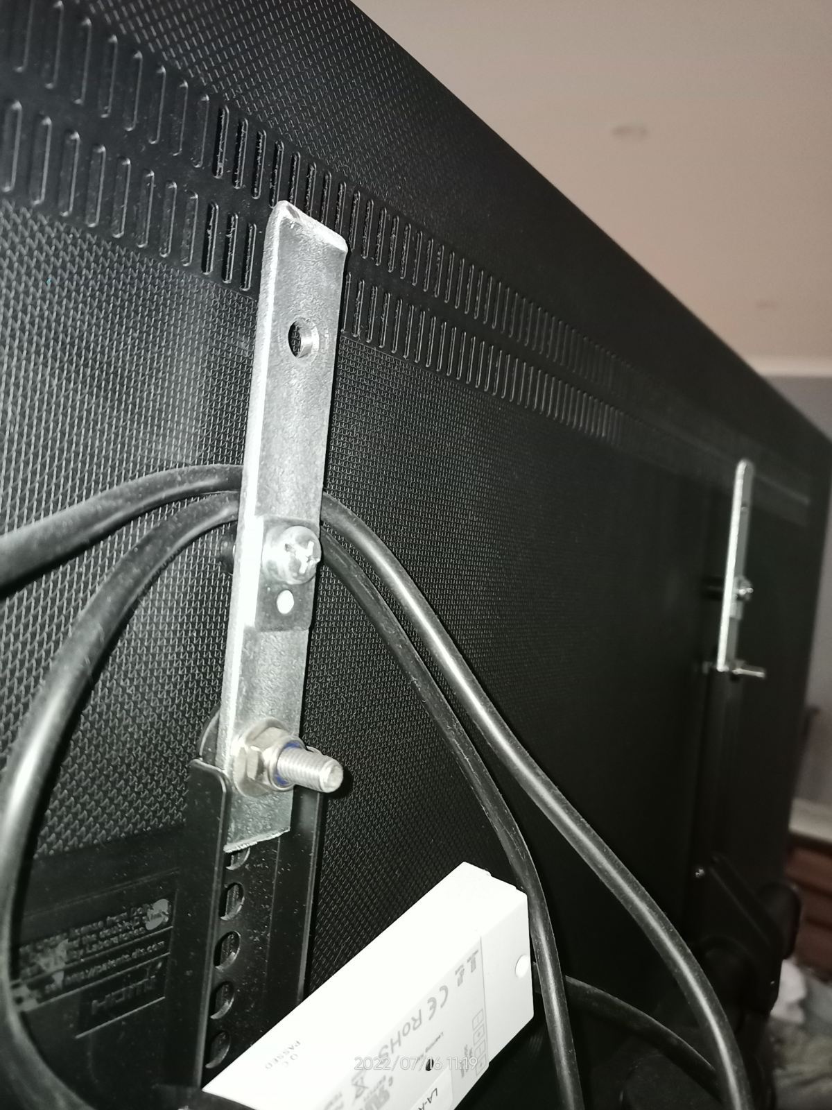

See the extra height i gained by adding to the Selby bracket height. I just grabbed a couple of angle brackets from bunnings, cut them at the bend and added the flats as shown. There is still another 50mm or so available at the bottom fixings on the bracket itself, but I could have done the same thing there if needed. Easy Peasy.
  • Like 2

13 hours ago, Mr_Gadget said:
is that as high as the stand can go? I think my centre speaker is a little taller than yours (21cm)
Sorry for late reply, my centre speaker is 20cm tall and that is the highest point on the vesa mount which worked out fine in my case.
@Colbunko has a great solution to fix your problem, hope this helps.

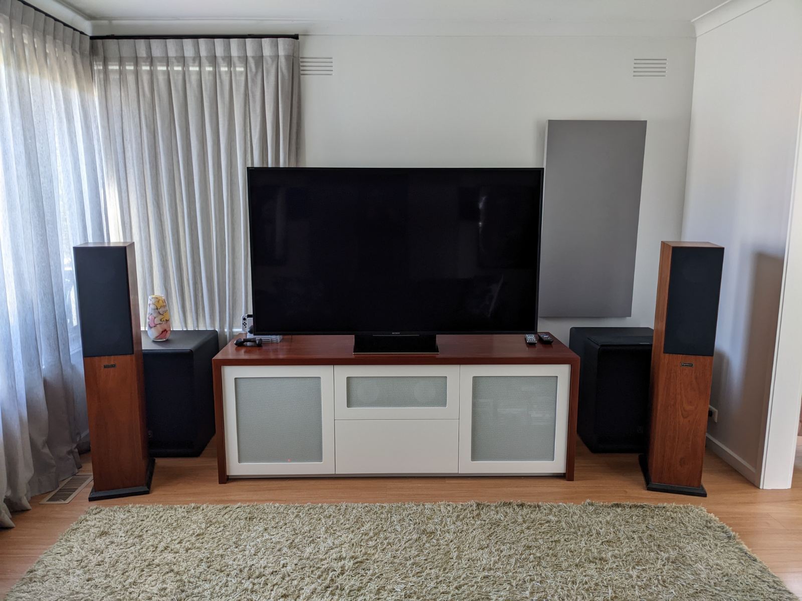

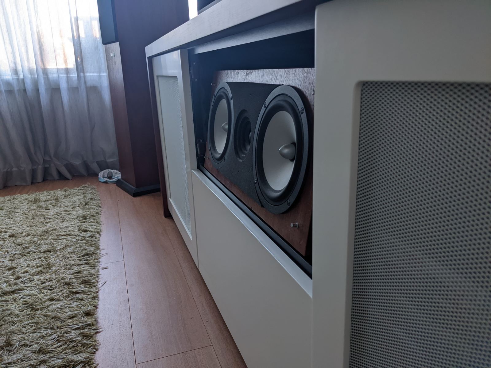

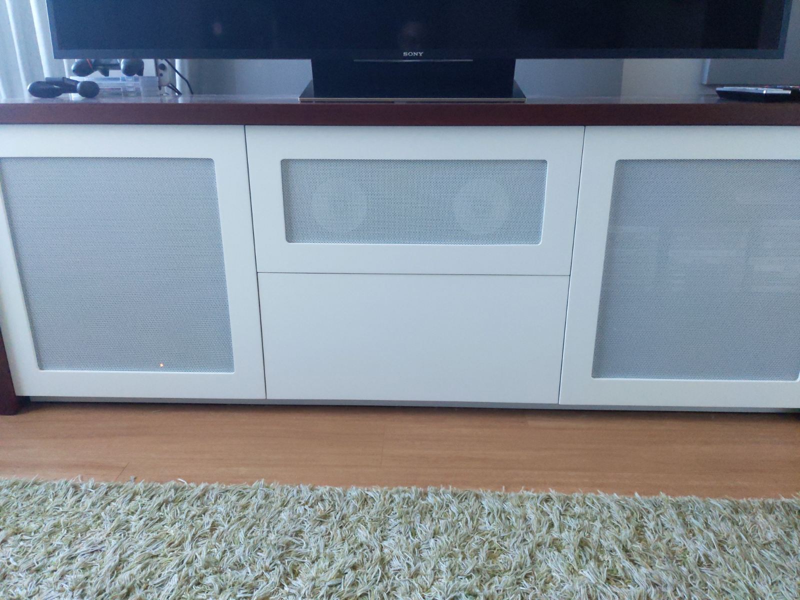

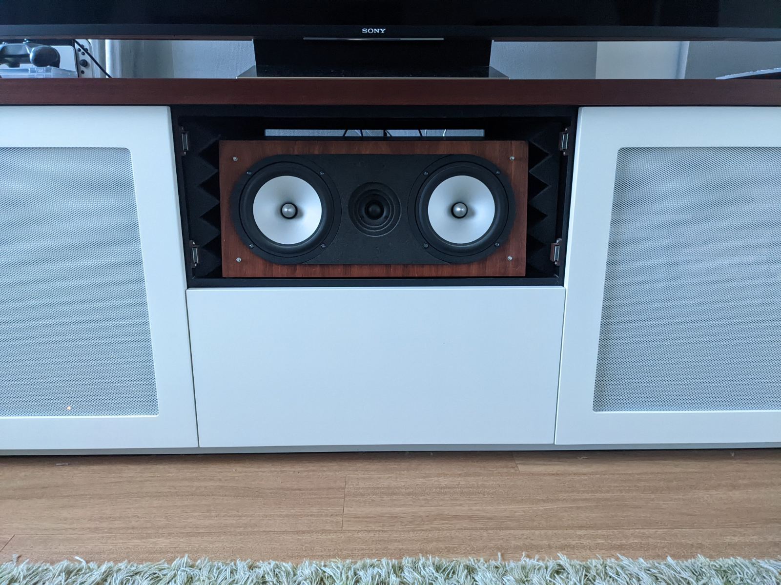

Posted (edited)
1658271682494653914360477990371.thumb.jpg.1c59844a085dd31914fbb3f6730c4ef9.jpgI may just leave it, I think the tv will look silly on-top of the speaker.
Only issue is one day if I change centre speaker it'll be limited in size by my cabinet space.PXL_20220719_225143172.thumb.jpg.a3f81fc6bf60e6961d4659628876d227.jpgPXL_20220719_225157943.thumb.jpg.54fd3a063ae69aaf84aeb308d3fc69ba.jpg

Thats a high centre speaker! You almost certainly will have to add some extra height to the bracket you buy. If you call in or ring Selby and tell them the clearance you need and the size of your TV, they should be able to recommend a bracket with the highest setting. That way you will be able to use the smallest extra bracket, if needed.
And as mentioned by others, I would consider tethering the TV to the wall or the cabinet, just so it cant topple forwards.
