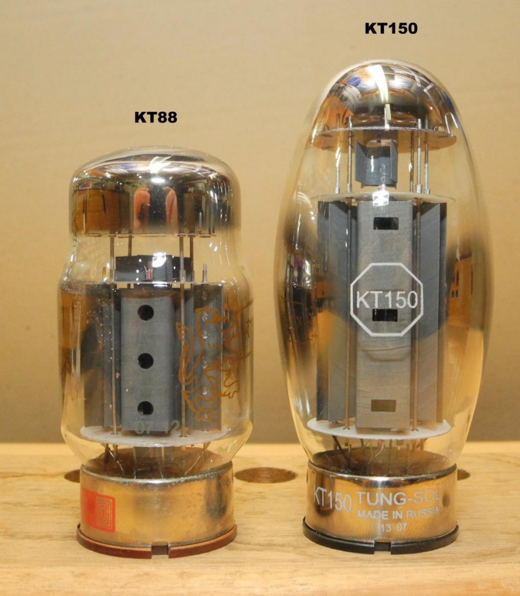

everyones_shadow Posted July 30, 2013 Posted July 30, 2013 Hi All Has anyone heard amps with the new KT150 power tubes? I know Icon Audio have changed over to them. Tung Sol haven't updated their site so I don't know if they're a drop-in replacement for the KT120 by size or not. I haven't seen that envelope shape before - you won't mistake the kt150 for anything else. Cheers Jeremy 2

ehtcom Posted September 26, 2013 Posted September 26, 2013 A small shipment of KT150 valves are on their way. Should have them early next week. Can't wait I'll have a pair of KT150 class A Monoblocks running at the HiFi show and most likely the Topaz Artisan 150 on display. I'll post some pictures of the tubes when they arrive. Cheers, Earle.
ehtcom Posted October 7, 2013 Posted October 7, 2013 KT150's arrived this morning. They look even better in the flesh. Better get a couple of amps built for the show. 1
