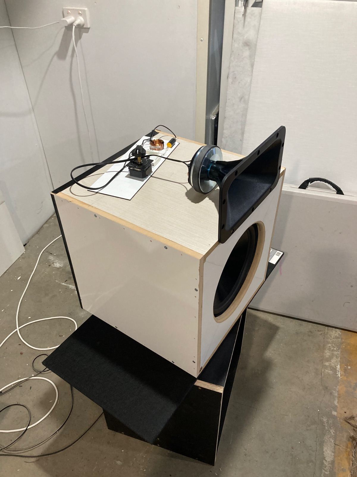

RePete Posted June 26 Share Posted June 26 (edited) I recently built the standard Econowave outlined here https://techtalk.parts-express.com/forum/tech-talk-forum/34467-flex-your-pcd-mettle With the Dayton woofer in a 65litre cabinet tuned to 30hz it’s a true full range speaker getting 30hz in room. Sourcing the waveguides here in Oz from Wagner or WES and the drivers from parts express will cost you about $600 plus cabinet costs. I’ve built a few speakers for about that sort of money and I think these offer the best sound and can by built to have the vintage look Ive enjoyed open baffle full range drivers for the past year but these have much smoother frequency response and most of the dynamics I enjoyed about them I’m living with the test cabinets for a while before I spend time building nicer ones, in the past I’ve rushed into the cabinets only to move on to something else Edited June 26 by RePete 1 Link to comment Share on other sites More sharing options...
