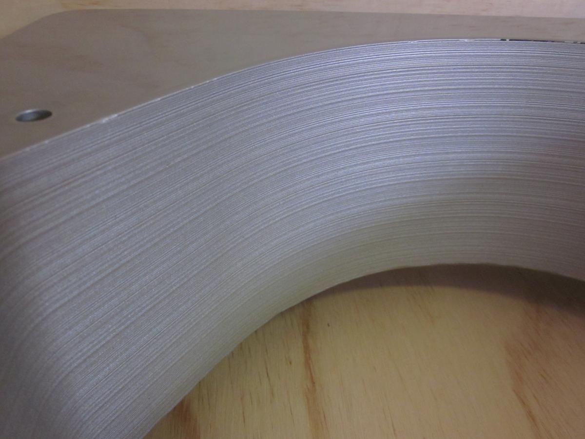

didier Posted July 20, 2013 Posted July 20, 2013 I love my white Garrard 301 but had always had a hammertone hankering... A couple of months ago I bought a series1 grease-bearing unit in great nick and have been sorting through the servicing issues - motor bearing lube, new motor springs, stripping the toxic linkages, new idler wheel and bushes, some bearing experimentation. While that's happening I had a friend make me a slate plinth, coated in epoxy and painted. This will house the turntable (obviously), with a separate armpod to sit off the one side. here's the 40kg result 4

aertex Posted July 20, 2013 Posted July 20, 2013 nice slate plinth. Is that a solid piece or is it thinner layers of slate faced off and glued together. Either way, where did you source such slate? Alan

didier Posted July 20, 2013 Author Posted July 20, 2013 Thank you all. In response to a couple of questions, the armpod is a solid piece of raw bronze, fluted at the top and drilled through its core to accept arm pillar and cable (another 20kg). It will match the raw bronze platter and the bearing will be swapped out for a much heavier duty unit. The tonearm will be a 12" Schick or Ortofon at this stage. The slate is a solid piece rather than layers, it came from Italy. Cheers for the encouragement!

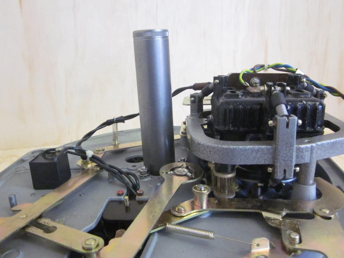

didier Posted August 8, 2013 Author Posted August 8, 2013 The Garrard is taking shape. Grease bearing removed and BIG bearing installed. I'll need it coz the platter's a beast. 1
didier Posted August 8, 2013 Author Posted August 8, 2013 Looks great, where is the bearing from? Thanks, a friend made the bearing. It's extremely quiet, i'll have to compare it with the Lithuanian bearing at some point. Very nice work mate! Thanks, coming along!
didier Posted August 8, 2013 Author Posted August 8, 2013 Which platter are you using? It's a bespoke solid bronze platter. About 14kg.
