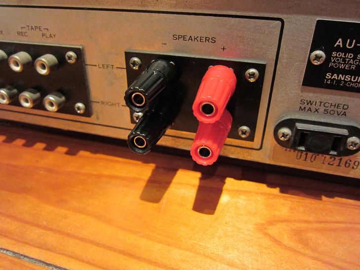

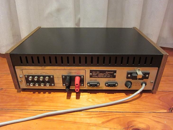

pete_mac Posted July 15, 2013 Posted July 15, 2013 (edited) Hi, The TA-1055 can most likely be fitted with modern binding posts in a 100% reversible way, provided that the original screw can be fully screwed-out from the original fittings. I've used binding posts with a 0.7mm pitch and 5mm diameter on a Sansui AU-101 as a direct fit, which is a ver similar situation to yours: These allow the use of bare wire, spades or bananas. Of course, you can definitely use cables with spades on your existing screw-style binding posts, or even ring terminals if you can completely unscrew the fittings. Some of the fairly standard crimp-style ring terminals are actually prett decent, being solid copper in construction rather than brass like many spades. The speakers can certainly be converted to binding posts, but it all depends on the design of the current speaker connections. Some of the spring-fit connections actually work quite well with standard fine-strand copper, but IMHO you always get a better connection with 5-way binding posts where you can apply more pressure onto the wire, or by using a firm-fitting BFA or locking-style banana plug, or spades. Edited July 15, 2013 by pete_mac

pete_mac Posted July 15, 2013 Posted July 15, 2013 The binding posts that I have used are these ones: http://www.ebay.com.au/itm/1pair-Binding-Post-5A-600V-Copper-Alloy-Nickel-plated-all-Red-Black-Soldering-/130749615442?pt=LH_DefaultDomain_0&hash=item1e7148cd52 On your amp, I seem to recall that the standard speaker binding posts have raised plastic in a grid-pattern to separate each of the binding posts. This might make it tricky to fit binding posts, so it would be worth taking a quick measurement from side to side of these raised plastic sections. I can then measure the binding posts to verify whether they'd fit between the raised sections and will fit flush with the mounting panel (if you get my drift).
Dcf1 Posted July 15, 2013 Author Posted July 15, 2013 Wow nice memory on that one, I own it and I had to go out and check what it looked like. A quick measurement showed about 14mm and I checked the specs on those plugs and it said they were 13.8 so it'd be tight I'd think. Internally the screws are flattened at the ends to stop them coming right out so it'd be a bit of tinkering to get them out. Might be worth going with spades and keeping these untested hands out of where they don't belong......for now.
pete_mac Posted July 15, 2013 Posted July 15, 2013 Yep, in that case, go with spades. You'll need to find ones that suit smaller diameter binding posts, as the openings on some will be too large for the factory binding posts.
