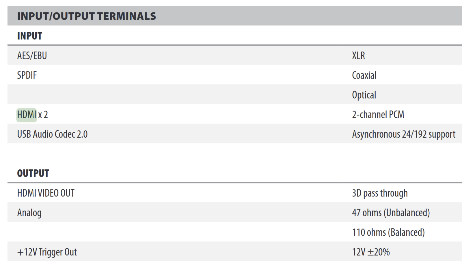

Snoopy 8 It's a Nad c510 digital preamp dac I use it to run Jriver media centre for my audio which works really well  I purchased it new about 2 years ago. It says in the owners manual it can pull the stereo channels off the hdmi and pass the rest to a surround reciever so it must be able to do it
Link to comment
Share on other sites
I am afraid you have misunderstood its capabilities.  From the manual
There are 2 HDMI inputs, with 2 channel PCM (not multi channel).   There is a HDMI video out, which passes HDMI video to a TV/projector.  Sorry, there is no pass through of audio.
If you are still keen to do a centre channel, you should be using an AVR with preouts.  For music, use your stereo as it is.  For movies, feed the hdmi signal to the AVR.  The AVR will output the left and right signals to your stereo setup via the preouts.  The AVR will drive the centre speaker.
