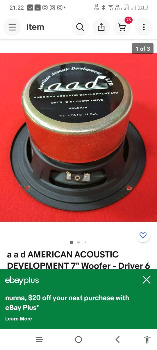

Boston ...or first addition c800i..
Bullet proof/big ass magnets...Screenshot_2022-09-03-21-22-14-822.thumb.jpg.d9d71358d416bbc04344501cc5ebc439.jpgand will wipe the floor with most out there....
