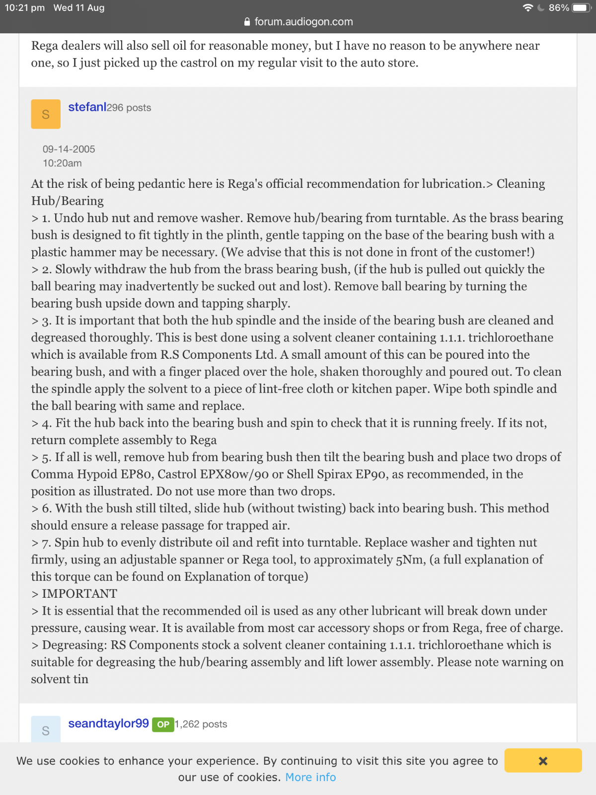

Decky Posted May 24, 2013 Posted May 24, 2013 I used Mobile gearbox synthetic oil for Rega Planar 3 some time ago. Excellent performance.

PKay Posted August 31, 2021 Posted August 31, 2021 I'm rehashing an old thread as I have recently bought a Lenco GL75 which is enroute from Tasmania. What oil/brand would people recommend for the bearings and motor? Lenco Heaven recommend a 3-in-1 oil or similar for the motor and for the bearing (straight copy from Lenco Heaven). Any suggestions on a particular type of special turntable bearing oil? Thanks. The type of oil is open for experimentation. Thick or thin, it's really up to you and the mechanical state of your bearing. Some use standard 10W/40, others Mobil 1 or special turntable bearing oil. Bottom line is: find out what suits you. Cleaning agent: Lighter fuel, isopropyl alcohol, methylated spirits, acetone and probably lots of others. Caution! Please be aware that these fluids are potentially dangerous to your health and highly flammable!
audiofeline Posted August 31, 2021 Posted August 31, 2021 There are two versions of "3-in-1 oil" - one comes in a blue tin, the other in a red tin. Unfortunately, the one Bunnings stocks is not the right one for turntables. From what I've read, compressor oil is OK to use, but better to avoid normal car motor oil because of the additives in it.
PKay Posted August 31, 2021 Posted August 31, 2021 17 minutes ago, audiofeline said: There are two versions of "3-in-1 oil" - one comes in a blue tin, the other in a red tin. Unfortunately, the one Bunnings stocks is not the right one for turntables. From what I've read, compressor oil is OK to use, but better to avoid normal car motor oil because of the additives in it. Do you know if this would be okay? https://www.supercheapauto.com.au/p/3-in-one-3-in-one-handy-oil-88.7ml/1124.html?gclid=Cj0KCQjwg7KJBhDyARIsAHrAXaE9X75HcnL1Pkc1-LdIY16zWeT13dHhQbksIjy9ZlzxaM0493VYGnoaAjj_EALw_wcB&gclsrc=aw.ds
