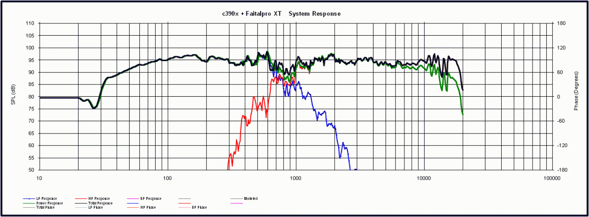

hi Zog,
here is my first attempt for the xo, your measurements are hard to work with as no gating applied so im seeing too many reflections :).
please use this on your miniDSP
W : LR2 @ 400hz
Tw : 1st order BW 6db @ 3500hz,
EQ on Tw
-6db @250hz Q:1
INVERTED
the rest of freq shaping should be based on your taste, i hope this helps :)
cheers
Henry

hi Zog,
W : LR2 @ 400hz
EQ on Tw
-6db @250hz Q:1
INVERTED
cheers
Henry
Wow thanks! I'll run these up shortly!

the sim was based on LR4 acoustic TF, there are rooms for improvement, but unfortunately with current data, i dont know which one to correct.
if you can, pls do a fresh settings, ignore all EQ in the mean time so you can hear whats going on.
