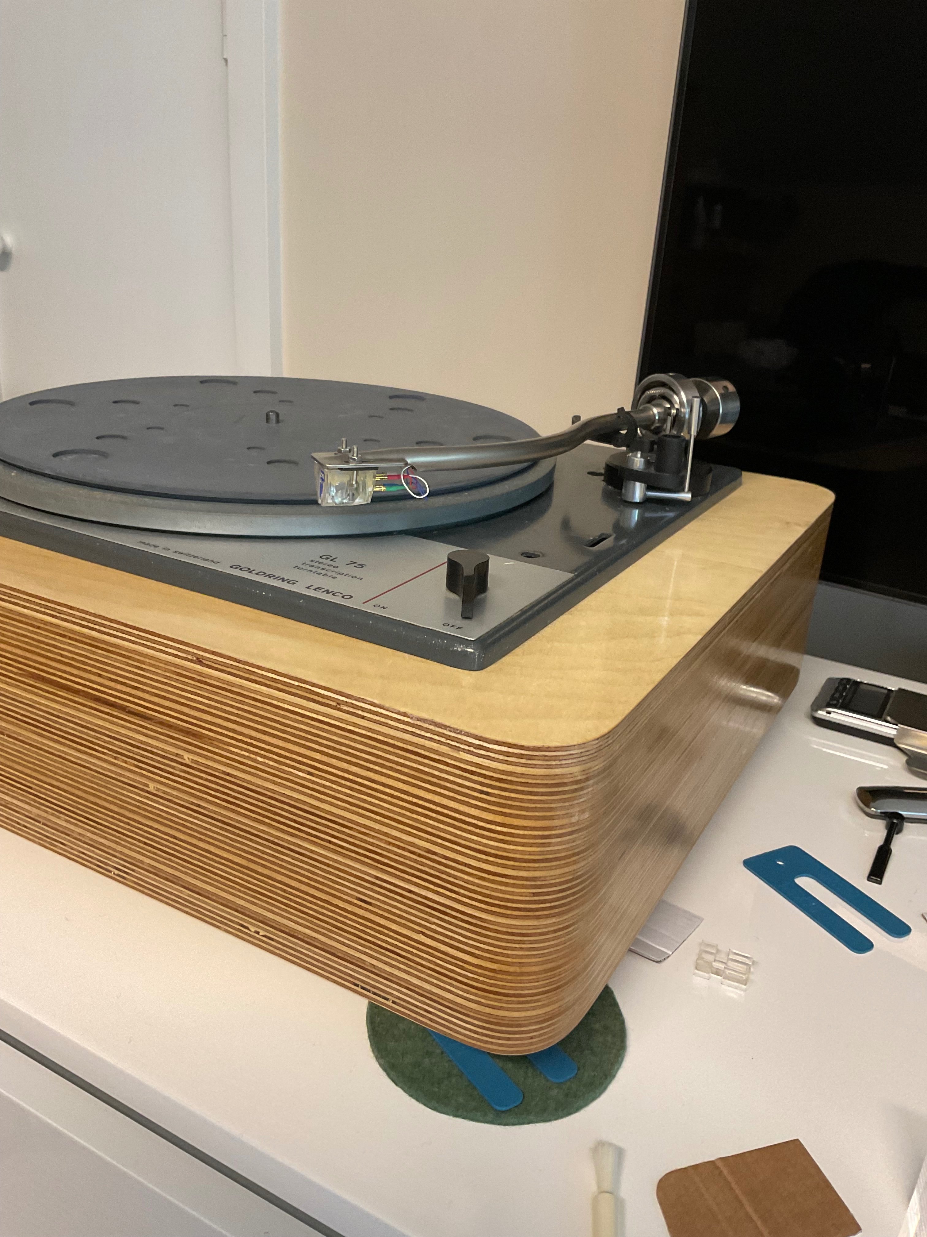

PKay Posted August 3, 2024 Author Posted August 3, 2024 On 21/6/2023 at 4:18 PM, PKay said: This plinth came up on Lenco Heaven in Adelaide and I couldnt resist grabbing it. It looks excellent made from Birch ply. @SonicArt and others looking for feet ideas. Currently using some Nordost footers which aren’t really designed for a heavy turntable. The Lenco screws down into the two little posts in the photo.
PKay Posted August 3, 2024 Author Posted August 3, 2024 I need better feet for levelling and support. 2
marcusD Posted August 3, 2024 Posted August 3, 2024 4 hours ago, PKay said: I need better feet for levelling and support. Gaia 111 are really great feet for BB plinths and good value 1
e83cc Posted August 8, 2024 Posted August 8, 2024 (edited) I recommend you change to 3 feet rather than 4 - much more stable and should sound better. In my experience you are better to level the stand rather than using levelling feet. You want to keep everything under the TT rigid. The Gaia work well under TT's - I have used them to elminate feedback on a Garrard 401 with no loss of energy. Edited August 8, 2024 by e83cc 1
PKay Posted August 8, 2024 Author Posted August 8, 2024 1 minute ago, e83cc said: I recommend you change to 3 feet rather than 4 - much more stable and should sound better. In my experience you are better to level the stand rather than using levelling feet. You want to keep everything under the TT rigid. The Gaia work well under TT's - I have used them to elminate feedback on a Garrard 401 with no loss of energy. That's actually a very good idea - save some money as well (I was going for 4 feet because the plinth has been set up that way). I am looking at some machined feet by @SonicArtthat look really nice. Machined alloy with Delrin inserts. The plinth has been drilled for 4 feet so I would need to find a drill press to make sure the hole I drill is straight. It should be okay in the middle of the back section. One of the guys on Lenco Heaven thought a heavy plinth wouldn't suit the Gais as too much rubber kills the dynamics and to only use it to damp problem areas.
e83cc Posted August 9, 2024 Posted August 9, 2024 22 hours ago, PKay said: That's actually a very good idea - save some money as well (I was going for 4 feet because the plinth has been set up that way). I am looking at some machined feet by @SonicArtthat look really nice. Machined alloy with Delrin inserts. The plinth has been drilled for 4 feet so I would need to find a drill press to make sure the hole I drill is straight. It should be okay in the middle of the back section. One of the guys on Lenco Heaven thought a heavy plinth wouldn't suit the Gais as too much rubber kills the dynamics and to only use it to damp problem areas. Here is what I did on my Garrard 301. I made sure the centre of gravity was within the triangle and nearest to the centre of the triangle as possible for stability and even weight distribution. Rather than drill the plinth I made 3 "pads" that I used the drill press to insert stainless steel inserts ( 8mm ) and then screwed the "pads" to the underside of the plinth. This way it is very easy to get the studs for your feet dead vertical without having to manhandle the plinth under a drill press. 3

PKay Posted August 10, 2024 Author Posted August 10, 2024 On 9/8/2024 at 1:58 PM, e83cc said: Here is what I did on my Garrard 301. I made sure the centre of gravity was within the triangle and nearest to the centre of the triangle as possible for stability and even weight distribution. Rather than drill the plinth I made 3 "pads" that I used the drill press to insert stainless steel inserts ( 8mm ) and then screwed the "pads" to the underside of the plinth. This way it is very easy to get the studs for your feet dead vertical without having to manhandle the plinth under a drill press. That’s great but mine has been sorted with 4 holes and bolt inserts installed. It will be a lot easier just to grab 4 feet from Mark. I was tempted to go with 3 legs but that requires a lot more mucking around. Plus as well as supporting local Mark’s feet look great. They should be really stable.
