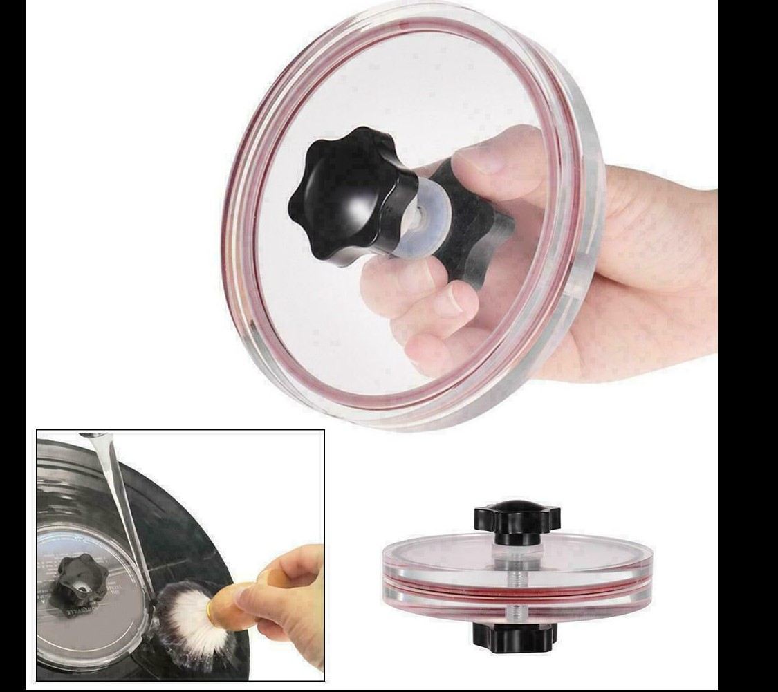

Hi Guys,
I am looking for some guidance from members who have had success with ultrasonic cleaners.
I have bought a kit from Vevor ( https://vevor.com.au/products/vevor-ultrasonic-vinyl-record-cleaner-vinyl-ultrasonic-cleaning-machine-6l-kno?_pos=1&_sid=5ee200840&_ss=r  ) and so far, I have cleaned about ten albums.
This is my cleaning process, any thoughts of how I can improve the end result would be appreciated.
The tank has been filled with 4 litres of distilled water, to which was added 15 – 20 drops of
Tergi-kleen. I chose this particular detergent/surfactant as it is endorsed by the American Library of Congress, who clean all the nations historical records and audio tapes.
In the Vevor advert it states that the motor for rotating the vinyl records rotates at 720 degrees per min, which as we know is 2 revolutions per minute. I had read that this was the best speed, or thereabouts, as any faster and the speed creates a wake in front of the record, pushing the cleaning bubbles away from the leading edge. Using a stopwatch, I discovered that the 24-volt transformer actually span the record at 11.5 revs per minute. I tried various other power packs of various voltages to reduce the speed. I only got it down to 8 revs by this method. Purchasing some components from Jaycar and Altronics, I made a speed controller and got the revs to exactly 2.
I also read that a temperature of 20C with a time of 15 minutes was best practice.
Before starting the first clean I degassed the mixture by running the ultrasonics for 30 minutes, I have read that you only do this once per fresh tank of fluid mixture.
Once the cleaning cycle has finished the record looks immaculate and obviously wet.
I am cleaning two records at a time with at least 30mm between each disc.
I remove the records and stand them vertically in a rack. Then I attach the record label protectors.
After they are attached, I use a pressure pack filled with clean distilled water to spray rinse both sides of the record. The sleek clean surface now has water beads all over it. I give this a shake and then using clean microfiber cloths remove the excess water. Then I let them air dry before placing them in new pvc sleeves.
I find when I play the record for the first time, the cleanliness is obvious, any slight pops are removed using a Zerostat gun. However, within a few minutes of play, the cartridge is clumped with, for want of a better word, fluff; which quickly degrades the sound, until removed. Then it repeats for every track.
If I use a carbon fibre brush on the record first, nothing is removed, implying the ‘fluff’ maybe still at the bottom of the groove?
I have not read in forums of anyone else experiencing this build up of gunk after cleaning.
Could this be detergent remnants or something else?
Thanks in advance.
Andy

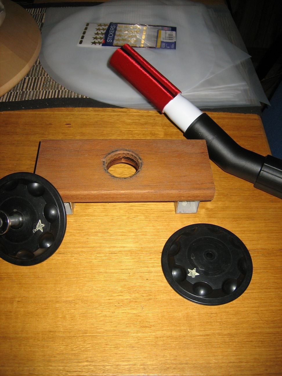

I have none of those issues, so here's how I use mine and the gear used.
Along with the surfactant I use 250 ml lab-grade isopropyl alcohol/6 litres lab-grade water.
I never clean more than one record per cycle—8 minutes at 30°C.
No rinse.
Suck the water off with an wet/dry vacuum via a special nozzle. (Imagine a cylinder that fits the vacuum hose, and is as long as the grooves are wide. The far end is sealed, there is a slit along the length 1 cm wide. The whole cylinder, both inside and outside is covered with very thin (1 mm), firm foam, and that covered with a velvet-like cloth—that is continuous around through the slit.)
The record with label protectors on is placed horizontally on a small stand with a hole for the knob and rotated twice around with the slot on the nozzle on the radius of the grooves and sucking like mad. Turn the record over and repeat for side 2. The record is dry in about 30-40 seconds total.
Pic of the extras:1187066690_USextras.thumb.jpg.6cc0fa2061c4824fc54d0b19cfd5bda1.jpg

I forgot to add that he made up the drying nozzle and was clear that the high suction quick dry eliminated the need for water filtration. The loosening of the dirt was the job of the cleaner and the effective removal of the dirty water/solution stopped it drying back on the record.
