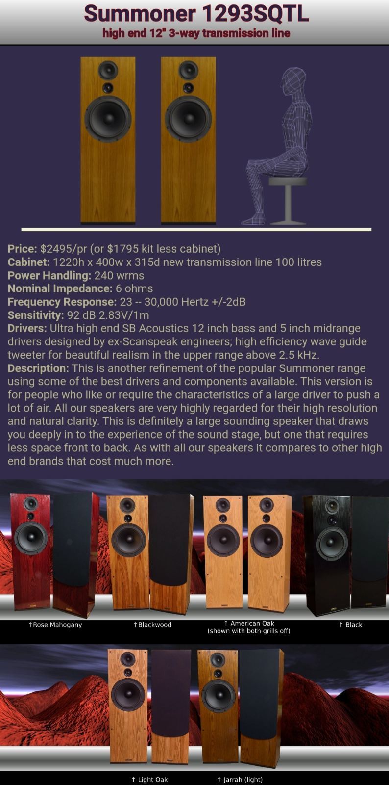

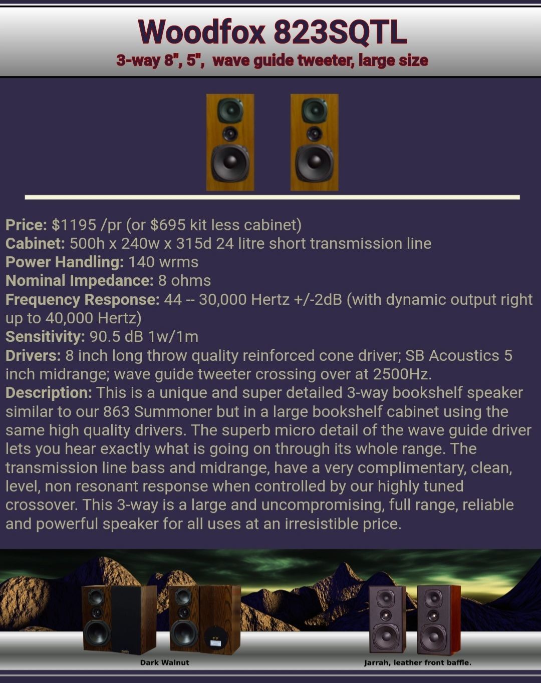

Speakers will be the Ascension/Adelaide Speakers Summoner 1293SQTL x9 and likely the Woodfox 823SQTL x6 for Atmos. (Was looking at the Monitor M823SQ, but will likely go the Woodfox instead for the Atmos speakers) Specs in screenshots below.

Sounds exciting, interested to know how you settled on "9x Adelaide Speakers Summoner 1293SQTL" for all low level speakers given they are full range.
Are you planning to crossover at 80hz as this would have a big bearing on how much power you would need.

Because they are so capable down low, I'll likely crossover at 50hz or 40hz depending how they perform. Will also see if I can send say 80hz and below or around that too ALL the floor standing speakers instead of just the channels it's "supposed" to be sent to, that way it'll be a much more even response of bass coming from 9 towers. Unsure if this can actually be done or not though..
I came to settle on the ground plane to be all full range and large towers "because"... But seriously, the reason is they are an excellent price and I WOULD have spend more on 5 speakers probably than the WHOLE setup of ground plane + Atmos speakers if I didn't discover Adelaide Speakers. Soo, I wanted all full range, deep bass capabilities and to be able to be loud, while sounding excellent. These ticked all those boxes and come at an excellent price! Factor in "bulk" discount, it's an even better price.
I'm even considering going with this design from the Artisan series for the 12" Summoners and Bookshelves if Edward is able to do so. Came across this looking through his site again the other day and instantly felt it's perfect for my home theatre! (Will add up in cost, but it just looks so good, even without the leather baffle I quite like the Artisan Series!)

I listened to one of Edwards dual 10" woofer Transcender models no longer sold, he said that it'd sound very similar to that one, probably slightly more bass though. It sounded great to my ears, even enjoying music I wouldn't normally listen to on it. (To me that says something). The main problem is that he doesn't keep stock, so you can only demo what he has made for a customer at the time. Unfortunately as I'm in Ceduna, that's about 8.5 hours from Adelaide. I missed a Summoner 12" just before I auditioned. (Unsure the ones I'm looking at or the cheaper 12" Summoner).
I did listen to Krix MEGAPHONIX also while I was in Adelaide, while they sounded clear and defined etc, I am a bit of a bass head, and they didn't quite have the characteristics I'm looking for.
