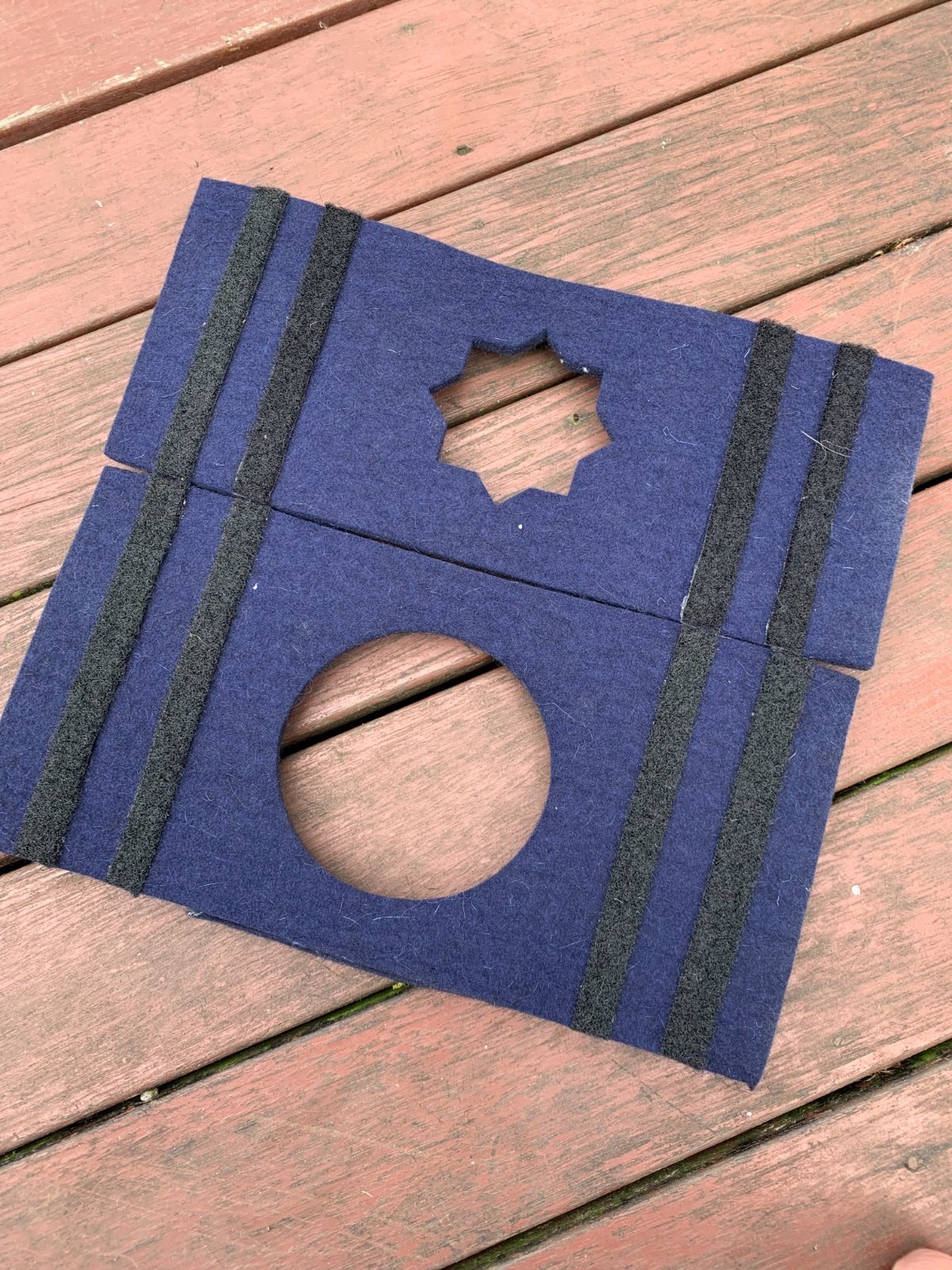

shovel Posted September 21, 2021 Share Posted September 21, 2021 I love a good plywood but havent come across one with an American Oak Veneer. Iron on veneer has been challenging in the past to get right. Maybe I need to do a course. If anyone knows a supplier of veneered plywood in Australia I would like to know. Also does any one know where to get the acoustic felt around the drivers. and was it glued on or velcroed? Thanks Link to comment Share on other sites More sharing options...
Jakeyb77_Redux Posted September 22, 2021 Author Share Posted September 22, 2021 The felt is velcroed on the Princess. Two small pieces are glued Link to comment Share on other sites More sharing options...

shovel Posted September 22, 2021 Share Posted September 22, 2021 Any chance later of a few photos of the removed felt...front and back? 1 Link to comment Share on other sites More sharing options...
Jakeyb77_Redux Posted September 22, 2021 Author Share Posted September 22, 2021 Sure. Will do when I’m home sometime soon Link to comment Share on other sites More sharing options...

Jakeyb77_Redux Posted September 22, 2021 Author Share Posted September 22, 2021 38 minutes ago, Sub Sonic said: Which parts are you looking for, is it to replace the existing on a Duntech speaker? I think @tubularbells would be keen on new felt for his Sovs and I’d also be keen if we can get a bulk order done. Here is the felt pics as requested 1 Link to comment Share on other sites More sharing options...

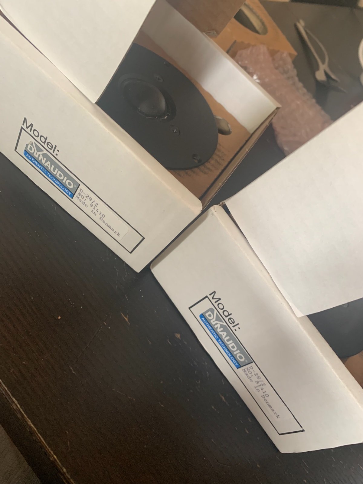

Jakeyb77_Redux Posted September 22, 2021 Author Share Posted September 22, 2021 These just arrived! NOS never been used. I am one happy camper 7 Link to comment Share on other sites More sharing options...

Sub Sonic Posted September 22, 2021 Share Posted September 22, 2021 (edited) Nice work on the tweeters Felt can be laser cut. I tried it with my little diode laser and it works, but leaves a slightly burnt surface, and also leaves a lasting smell of burnt hair Perhaps a CO2 laser would work better, but I don’t have one of those… yet! The cheapest Chinese CO2 laser cutter is around $500, and only has a 200mm x 300mm cut area. One day… Edited September 22, 2021 by Sub Sonic 3 Link to comment Share on other sites More sharing options...
frednork Posted September 22, 2021 Share Posted September 22, 2021 (edited) I think the biggest issue with the felt is matching the density of the original from previous investigations. How much difference that makes is difficult to determine though. Excellent score on the tweets!! Edited September 22, 2021 by frednork 1 Link to comment Share on other sites More sharing options...
