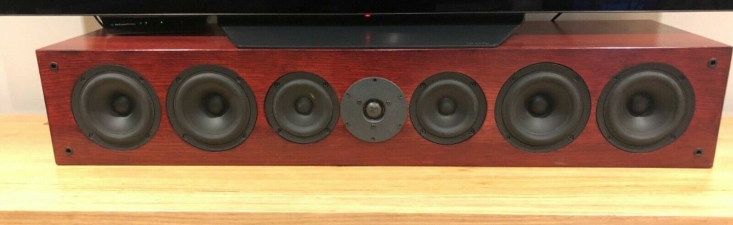

letu84 Posted September 10, 2021 Share Posted September 10, 2021 Hello all, I am looking to upgrade my centre speaker and come across this full 3 ways custom make centre. According the seller, the tweeter is Dynaudio Contour which cost alone over $500. Would it be a great centre? As it is not connectted to the system so I cannot try it. I never experience with custom speaker so would it worth to pay $650 for this centre? Many thanks, Tu Link to comment Share on other sites More sharing options...
Dean Gale Posted September 10, 2021 Share Posted September 10, 2021 You need to see further photos of the build process the tweeter does look authentic , but yeah be good to know if there are separate chambers for the mids and woofers . Is it an off the shelf crossover was it built from a plan it does look like a hivi plan I saw once. A list of the drivers anything you can get . There is no reason why it can't be hooked it up on one side of a stereo pair briefly . Also are they wired in series or parallel ? Try and get some info 1 Link to comment Share on other sites More sharing options...
SlawMan Posted September 21, 2021 Share Posted September 21, 2021 There is a lot more to a speaker design than using great components (although it is a good start). Any specifications? Were any performance measurements taken in the design process? If not, I would steer clear. Link to comment Share on other sites More sharing options...
