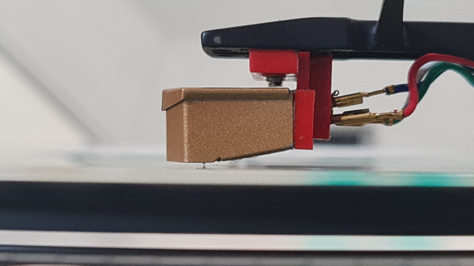

Yep, here is my modded sl1210mk2 with one of my Decca I just retipped today. Had it ages just not got round to it. This was a Decca gold, retip with nude Mico ridge makes it a super gold. Listen to this you hear how amazing a Techincs can sound.
