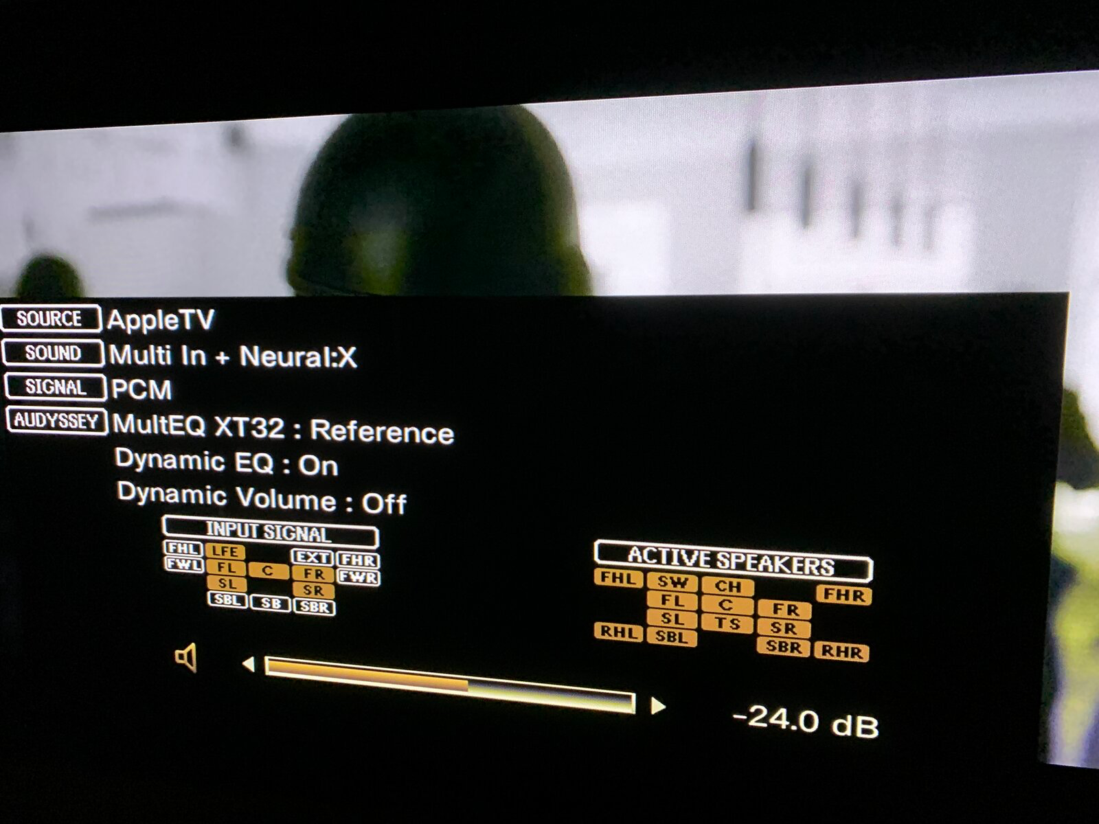

betty boop Posted August 19, 2021 Share Posted August 19, 2021 48 minutes ago, Eli said: Yes but you are pulling the Atmos mix down to Dolby TrueHD 7.1 then re-upmixing with Neural:X. So in doing so you're losing your overhead discretion. Technically it's not upmixing an immersive format (which can't be done currently). You're downmixing (or just not pulling out the height metadata) then applying an upmix. It's not upmixing Atmos. yeah absolutely its what it says... but if see original post I made ...i added the clarification... if want ... ie to upmix... but yes 100% it is truehd whcih is the base of atmos. I dont watch atmos that way just watch it as it is ... but keeping in mind what was talking about was really with regard top middles where they have to phantom for Ts and Ch.... just as with 7.1.4 for atmos ... i have to phantom anyways so nothing to be gained for me there... but do appreciate as i said where have multiple rows... where top middles do play a part. 1 Link to comment Share on other sites More sharing options...

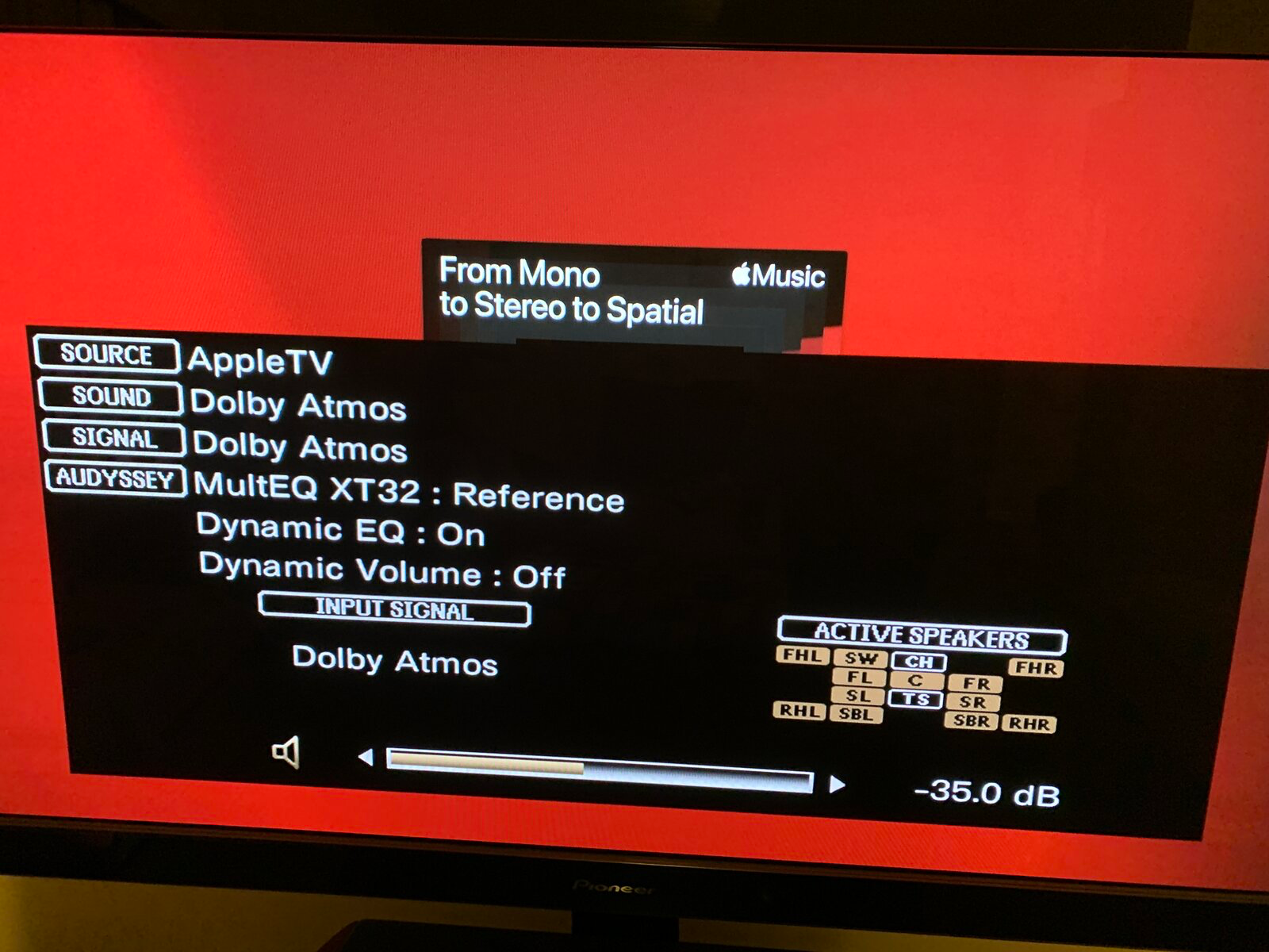

betty boop Posted August 19, 2021 Share Posted August 19, 2021 (edited) ok auro 3D ... yes rare as heck in movies.... but where it is ..its actually very good ! but am finding its actually very good as an up mixer 7.1.6 and for music ... what i thought was a game changer for music ...apple music bringing out atmos... turned instead to disappointment ... even their demo a marvin gaye song... "whats going on" yep what is going on .. marvin gaye is hanging like a bat from the ceiling singing from up there some where there are some good tracks though... but still atmos and done well ie intended from the beginning.... is rare ...unless impressed with fake... which a lot of it does sound very fake... auro3D on other hand does a far more believable rendition in upmixing music to 7.1.6 as example below.... Edited August 19, 2021 by betty boop 1 Link to comment Share on other sites More sharing options...
