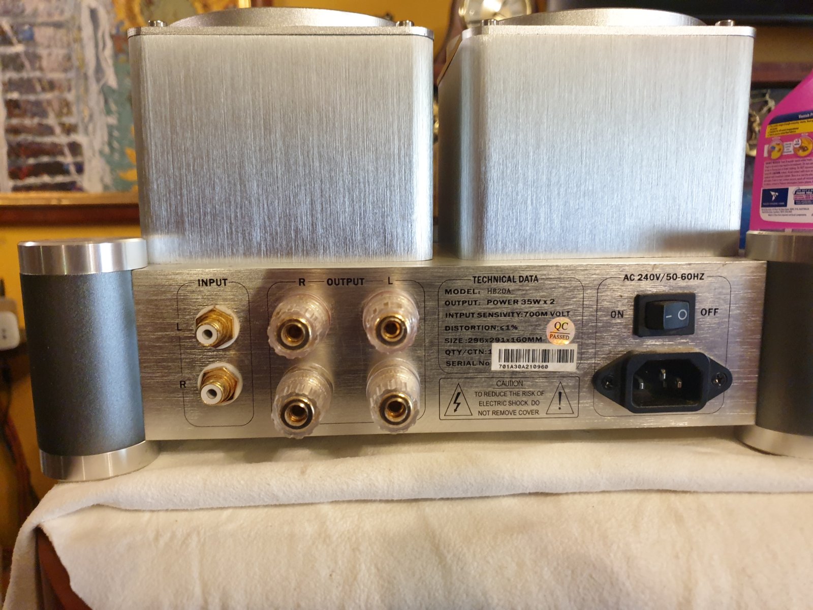

Humpty Posted August 14, 2021 Posted August 14, 2021 Wotcher peoples, about 14 years ago I bought a Simmons Audio Research tube amplifier.
Humpty Posted August 14, 2021 Author Posted August 14, 2021 Wotcher peoples, about 14 years ago I bought a Simmons Audio Research tube amplifier. 35W per channel AB amp. The tubes I just cannot identify are marked M01A. I've been able to replace the quad WY3P. Much hunting lead to 2 posts on sale sites suggesting 6sl7 and 6sn7 which have been unsuccessful. A recent example went for auction on ebay for $456 but the seller knew less than me. Does anyone recognise the amp or tubes, have a link or a suggestion. It does sound lovely and still works but I'd hate to think it ends when the tubes die.

Martykt Posted August 14, 2021 Posted August 14, 2021 3 hours ago, muon* said: I think are Chinese reproductions of the 01A a single higher power triode. https://www.radiomuseum.org/tubes/tube_m01a.html https://www.radiomuseum.org/tubes/tube_01a.html Could well be a copy of sorts. The only issue is the original 01A and M01A tubes are 4 pin tubes and looking at the Simmons M01A it appears they've used a different base using only 4 of the pins. It may be possible to use the original M01A/01A tubes which could well be worth doing however the tube sockets would have to be changed. 2
Martykt Posted August 14, 2021 Posted August 14, 2021 3 minutes ago, Humpty said: It does doesn't it. I think I've gotten myself confused by the 8 pins on the M01A Just finished typing a reply on this !! It appears that they have used different bases most likely due to not being able to get a similar base and only soldered 4 of the 8 pins with the rest being dummy pins. 2
muon* Posted August 14, 2021 Posted August 14, 2021 (edited) Yeah, would need to change the sockets to use an original 01A. Edit: I really would want to see the data sheet of the thing they used so I could compare it to an original, even if I planed on changing sockets. 4 pin bases are not hard to get, they are used in any power Triode (211 ect'), sockets are easy too, it appears they are faking a 01A by modifying the connections of a different tube that is 8 pin, is my guess. My guess is this tube they have used has different electrical parameters to a real 01A or M01A tube. Unless you can get the original tubes you might have to get a tech' to redesign for a different tube, one that matches the output transformers in the amp, and plate voltages ect' provided by the amp's power transformer. Without a data sheet of that tube they have used, It's all guessing. I'd look for the specific tubes it came with. Edited August 14, 2021 by muon* 2
