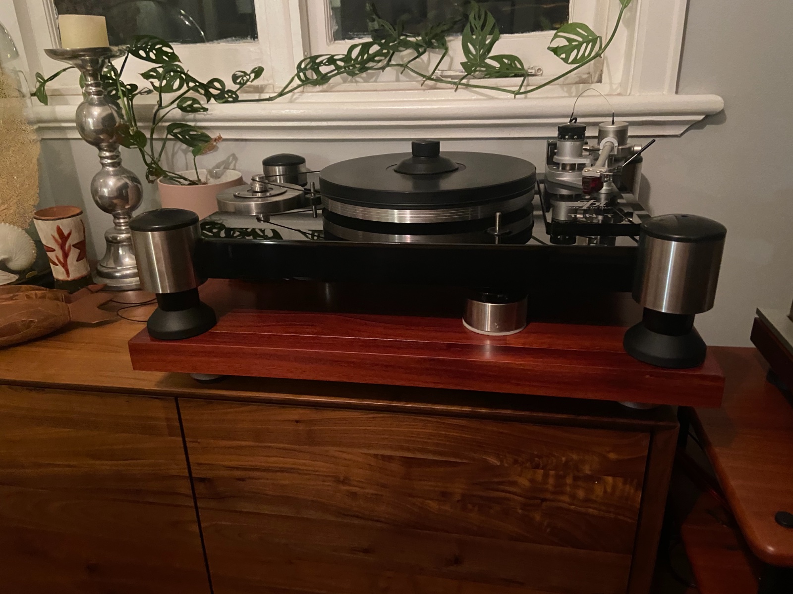

Pops110 Posted August 9, 2021 Posted August 9, 2021 I laminated mdf to a layer of wavebar and then jarrah floorboards. Then used Isoacoustics stage 1 underneath. Would be pushing 60kgs all up with turntable on top. 12 1

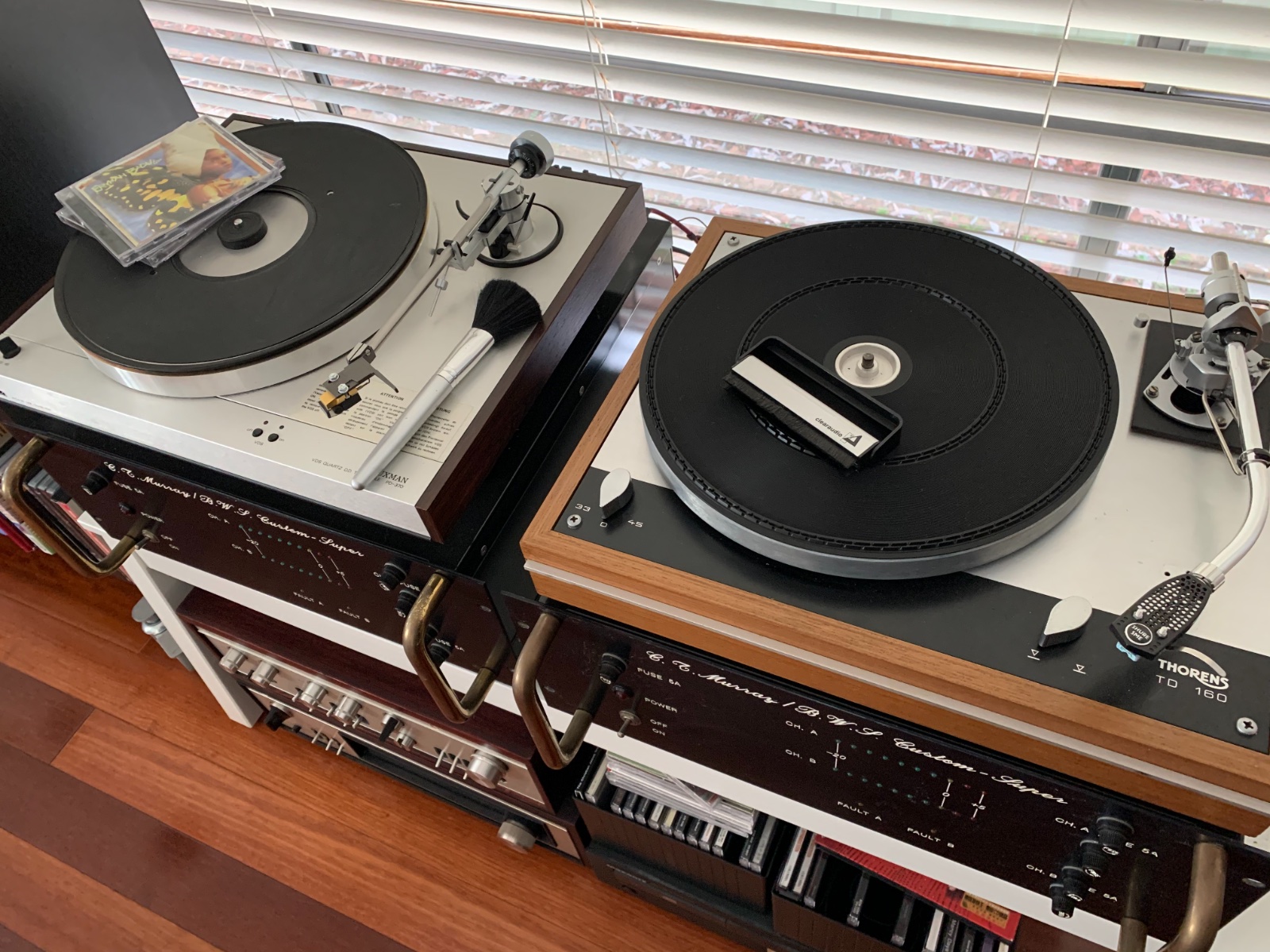

Tax Posted August 11, 2021 Posted August 11, 2021 Depending on budget, the Minus K and Vibraplane are really good isolation platforms I used the 60kg Vibraplane under my Micro Seiki TT. The TT and platform weighed approx 130kgs. I use Isoacoustic Gaia's under my Garrard 401. Initially I had the Gaia 111's but the change to Gaia 11's was a significant improvement. So when using Gaia's probably best to go the next weight category up. For the Commonwealth TT build I had the feet custom made in 316SS in 60mm which will sit atop the pneumatically isolated Vibraplane. At the budget end things like Herbies work well under smaller TT's. I have used those under my Thorens TD160 and Luxman TT's. Experimentation is key. Good luck! 4 2
