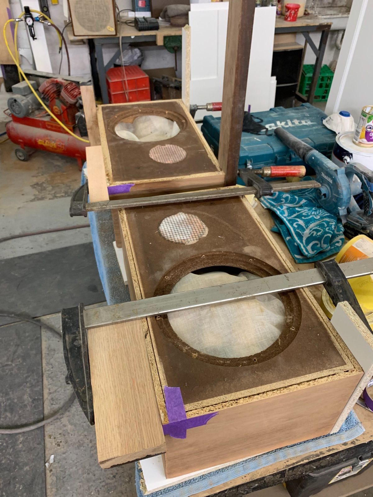

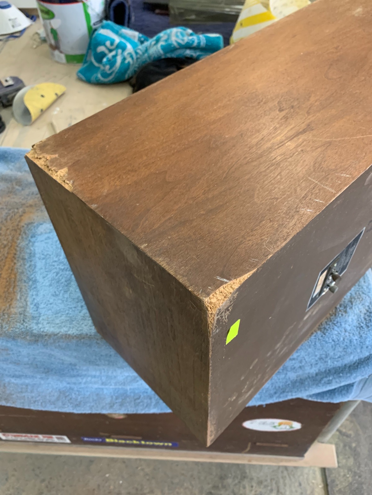

The cabinets had a few issues
sanded of the old lacquer
front edges were veneered, the particle board beneath had swollen and burst the edges so I cut them back to the baffles
picked out the swollen board behind the veneer, backfilled with glue and clamped back straight
Sanded back the baffles and added solid walnut beading
light stain and a few coats of clear
