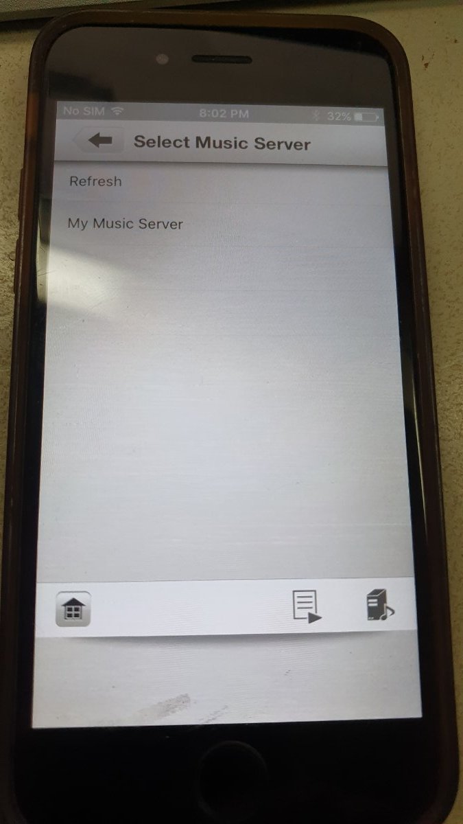

Just got a friend to download Marantz Dac App.
Following photos attached.
The Na11sa device appear as follows.
He is as equally "good" as I am.
Last pic after choosing ALBUM  Song 1 etc appear.
How to go from here?
Any help appreciated . Thanks.

Is your friend on the same wifi network as your NA11 - yes, the NA 11 is using LAN, but it also needs to be linked to your wifi system.
You cannot control it without wifi.

As far as I can see, your Marantz isn't connected to the same network as the mobile phone.
(Audio)
Friend kind enough to come over .
Just switch on Marantz Dac.
First 3 pictures appeared.
When I chose Music Server
this 4th picture below appear below . It shows NO Connection on the Display.
My Marantz Dac is connected to Router by LAN cable.
Before I plug in the USB Thumbdrive I chose Music Server and this is what showed up.

Just guessing here but it may be worth a try... I was thinking the same thing as Audio actually...
I suspect your iPhone is simply not connected via wifi to the same network that your Marantz NA11S1 is connected to. That's why you can't see the NA11S1 on the Marantz app on the iPhone.
1. Which router is the NA11S1 physically plugged into? Is it the RT-66 in your Family Room or the RT-1200 in the Living Room?
2. Do you know the Network Name for this router? If you're not sure, first turn off the router that the NA11S1 is not connected to.
3. (I'm not familiar with iPhones as I use Android but I will try...) On your iPhone, disconnect from its current wifi network. Then go to your wifi settings to choose the same network name that your NA11S1 is connected to.
4. Launch the Marantz app on your iPhone and try again. I hope it can detect the NA11S1 this time.
I will presume you already have your NA11S1 and the connected router powered up as you try all this, of course :).
Also, I think you should probably select USB on the Marantz app, not the Music Server.
HTH.

Do this
You have not answer if the iPhone, NA 11 and PC are all on the same network bro..

So your PC and your NA 11 are on Different networks as suspected
Connect your NA 11 with a LAN cable to the RT 1200. Turn OFF the RT 66. Get a LAN cable from the RT 1200 to your PC.
Use the iPhone to join whatever network the RT 1200 is on.

You can try the following too if it's not convenient to turn off the RT-66 in the Family Room at the moment:
1. On your iPhone, look for the name of the wifi network that it's currently connected to. This may possibly look something like "M1-A123" etc. This is the network name of the RT-66. Note down this name.
2. On your iPhone, disconnect from this wifi network.
3. Bring your iPhone physically close to the RT-1200 in your Living Room. On your iPhone, look for the wifi network that shows the strongest signal, that is not the same as the network name in Step 1 above.
4. Connect to this network. This should be the network name for the RT-1200 in your Living Room.
5. Close and open the Marantz app. See if the app detects the NA11S1.
6. If it does, select the USB option and see if it reads the files in your thumbdrive.
Thank you very Bro.
Will try.
HENG AH !!!!!!!
Thank you very much Bro. headfiman.
My neighbour was able to connect after following your instructions. The success means a lot to me going forward will certainly bring so much convenience instead of scrolling till kingdom come with the Marantz dedicated remote.
My thanks also to the following Bros. who made every effort to assist and advise.
Petetherock, BoxerFan88, jonlee, Audio and other Bros. who I have inadvertantly left out.
Will take not of BoxerFan88 on holding off purchase of used iphone. So will try FLING to see if my Android phone can be used as a remote.
Thanks again to all !
