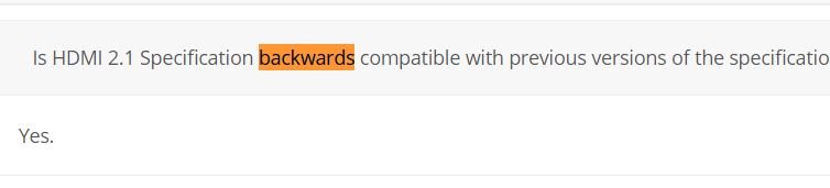

econav Posted June 4, 2021 Posted June 4, 2021 (edited) On 6/2/2021 at 4:03 PM, jkcs said: sorry for being so shameless. haha Technically HDMI is backward compatible as I done my studies on the internet. Are you that sure eARC is backward compatible to ARC .... 2 total dif chipset you know .... Go HDMI.org to discover yourself . Edited June 4, 2021 by econav

jkcs Posted June 5, 2021 Author Posted June 5, 2021 20 hours ago, econav said: Are you that sure eARC is backward compatible to ARC .... 2 total dif chipset you know .... Go HDMI.org to discover yourself . Relax brudder, no need to be so aggressive (unless I mis-interpreted your meaning... peace) to be frank, I am a noob to AV. I thought forums are meant to be sharing of info, ideas and etc? sometimes whilst doing own research, I read the contents and might misunderstood them, but for this case, I believe I am correct so I went to the url u provided and read, it also said it is backwards compatible https://www.hdmi.org/spec/hdmi2_1 I screenshot for your reference. 9 hours ago, Boxerfan88 said: maybe i can suggest to try another way, out of band method. if your tv got optical out, use an optical cable to connect from tv to avr. configure tv to send raw audio via optical. configure avr to receive audio via optical. if it works, this could be your workaround… 6 hours ago, petetherock said: Yeah if optical works it may not be the encoding and the fault may lie in the HDMI part Hi Bro Boxerfan and Petetherock, thanks for your replies and guidance. unfortunately my existing 1.5m toslink optical cables are too short to connect to my TV and AVR. I also don't want to try anymore, just output the audio via TV speakers can already

econav Posted June 5, 2021 Posted June 5, 2021 (edited) 3 hours ago, jkcs said: Relax brudder, no need to be so aggressive (unless I mis-interpreted your meaning... peace) to be frank, I am a noob to AV. I thought forums are meant to be sharing of info, ideas and etc? sometimes whilst doing own research, I read the contents and might misunderstood them, but for this case, I believe I am correct so I went to the url u provided and read, it also said it is backwards compatible https://www.hdmi.org/spec/hdmi2_1 I screenshot for your reference. The issue you are facing is not HDMI 2 vs 2.1 port or chip compatible , that is why you connected your New Tv to the older Denon is still will work. But the problem you face is eARC vs ARC , take a look on the Question and Answer , there are more inside the chip and cable , like network/ CEC etc....Lor Edited June 5, 2021 by econav
Raylim76 Posted June 6, 2021 Posted June 6, 2021 Allow me to make this clearer. Correct me if I'm wrong with my understanding. I think what jkcs is trying to say is regardless whether HDMI 2.0 or HDMI 2.1, all HDMI connection is "backward compatible". This is NOT wrong. For eARC (HDMI 2.1 specs) vs normal ARC (HDMI 2.0 specs), this may be a little tricky as it really depends on the manufacturer's intent to make their products to work with both eARC and ARC seamlessly. With all intents and purposes, I'm pretty sure jkcs is fully aware that HD lossless audio like Dolby Atmos and DTS-X cannot be output to his old AVR (which only support ARC) since he emphasize in getting normal 5.1 sound output and never once did he ever mention about lossless HD audio in the likes of Dolby Atmos or DTS-X. So he is NOT wrong to say that it should be able to get at the very least, Dolby Digital + or normal DTS Core format to work since HDMI 2.0 and HDMI 2.1 specs (with ARC as a subset) are backward compatible. The AV device (equipment) we use - i.e. TV/display and Amp/AVR should be able to "auto-negotiate" among each other while still using one medium - i.e. HDMI cable. I have no answer as to why jkcs is experiencing "distorted" sound on his system while connecting using a typical HDMI cable while he have no issue with Youtube playback (sound is fine) while connection remain the same in both scenario. @jkcs - Can you use other HDMI port on your Samsung TV which has no eARC label on them or are all the HDMI ports eARC-compliant?
