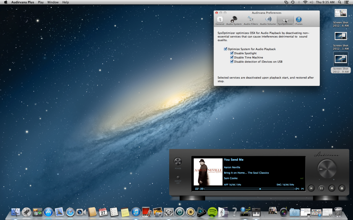

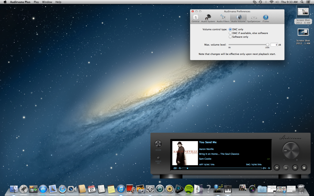

a.dent Posted December 27, 2012 Posted December 27, 2012 Hi Frank As I said in my first post, have you checked the LED diagnostic lights on the AP2? They will diagnose your problem. I have attached my screen shot as I am playing now. The major differences could be the A+ set-up and the Audio Midi set-up. Let's know how you go.
