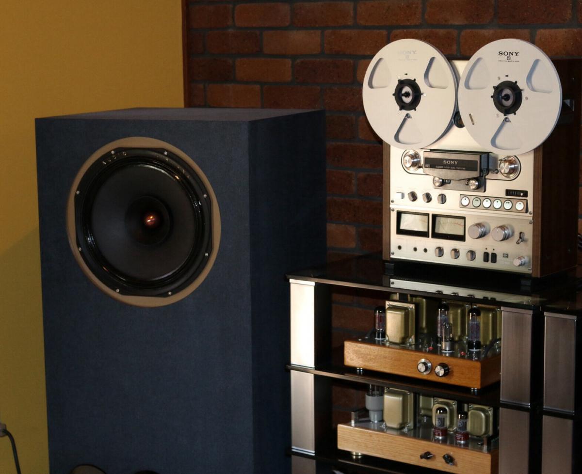

Here are some updated photos The Sony TC765 is now in its new position and 10.5" reels fitted ( doing a room revamp on spouses orders )
Here is a photo ( A sneak peak ) with the new horn speakers set up

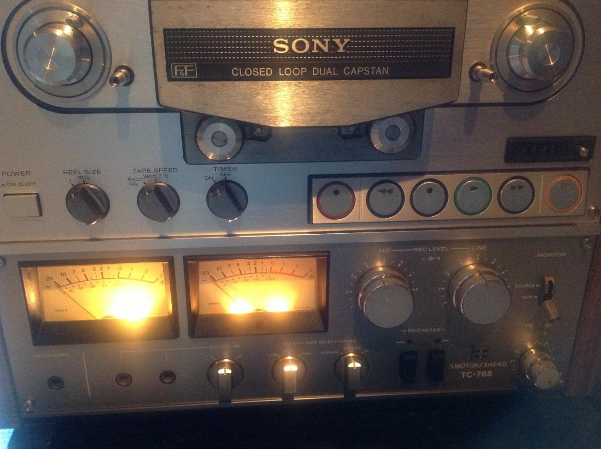

Posting a few of pictures as promised
Front View
Runs 7 inch Reels
post-112724-0-28331900-1344914229_thumb.
Closeup of front panel and buttons
post-112724-0-26282300-1344914284_thumb.
post-112724-0-42481500-1344914296_thumb.
A View of the back
post-112724-0-90168100-1344914472_thumb.

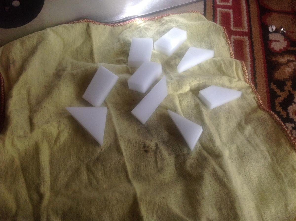

This beautiful Sony TC765 Reel2Reel tape deck is now all fully serviced
All the knobs are polished to look there best
And it plays superbly
Knobs before a polish
post-112724-0-62536600-1371538712_thumb.
A look at the heads
post-112724-0-55911100-1371538776_thumb.
To polish the pitted and tarnished knobs I used a combination of white magic sponge and brasso
post-112724-0-49243900-1371538840_thumb.
All polished and lit up ready to go
post-112724-0-81648200-1371539003_thumb.
post-112724-0-93777500-1371539063_thumb.

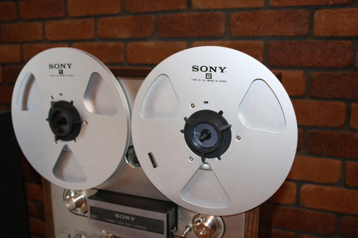

Today I just happened to be on business just a block away from Totally Technical in Bowen Hills Brisbane
They are stockists of RMGI audio tape and also repair equipment
I called in and purchased 2 pancakes of 1/4" tape to suit 10 1/2 " reels - Pancakes are tape without the reel and is the most economical way to purchase audio tape
All that's needed is to fit it to the nab and wind it on an empty reel
And you ask what was the price for brand new tape ?
Two pancakes cost $92.20 inc GST ( That's a lot better than 30 year old tape from eBay )
Let the recording begin :)

First find a thin mouse mat
Remove the top plastic cover carefully
And the foam that's used on the underside of the mouse mat is then cut to the size of the motor drive hub
The spacer must be removed when using the plastic reels as they lock in with the spring star lock on the shaft
Cant help with the after market hubs
However I do have one set left of the original NOS Sony NAB hubs

@Full Range. Nice machine there and love the horns! I'm just about to start giving my TEAC rtr a clean. Cant seem to remove the knobs so I'll just have to give them a wipe down. What can I use to give the heads a clean? I assume just an alcohol based cleaner> Same with the rollers/guides?
I'm new to this so I don't want to use the wrong stuff...
Cheers
M
Best I have found for cleaning heads is Isopropyl alcohol with some white magic foam
Same for the rollers
To rejuvenate the rollers you can use alcohol with very fine wet & dry sanding paper, brings them up like new, but only to be done while the rollers are spinning
The white magic foam with mild detergent is also fantastic on the rest of the unit as well
The knobs in these machines are generally secured in 3 ways and sometimes all methods are used on the same machine - depends on the size of the knob
1) An Allen key grub screw
2) Push in interference
3) D key push - sometimes with a spring steel holding key
Edited by Full Range
  • Like 1
