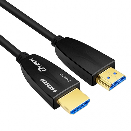

Gday, I use a Dtech Fibre optic caable between my Oppo 205 and LG Oled for picture. I use a HDMI cable for the sound.
For some reason, after start up, the tv displays a message, No Signal.
I have to swith the 205 off, and then back on, to re-establish a signal.
Has anyone had a similar issue?
Any help would be appreciated.
Cheers Andrew

if the below is the Dtech cable...
DTECH Fiber Optic HDMI Cable 4K At 60Hz 18Gbps 5M
https://www.dtechelectronics.com/dtech-fiber-optic-hdmi-cable-4k-at-60hz-18gbps-5m_p191.html
you will see how the display ends and source ends are labelled... this is how you know its an active cable.
Also it shows the construction of it
and as you can say while they call it fibre optic...it is infact a hybrid cable with fibre and copper....
Link to post

Denon AVR4500
LG OLED C9
Fibreoptic directional yes
In the 205 manual, Oppo do say one cable for audio and one for display, is a good choice.
Under a certain length, cables dont have to be active.

Gday everyone, well I took some advice, and simplified my setup.
One copper hdmi cable from Oppo to Denon, and a fibre optic hdmi cable from Denon to TV.
Everything was fine, and then, the dreaded loss of signal notification.
I have the fibre optic connected in the correct direction.
The cable is only 5m long, so it cant be a loss of transmission strength??
Am I missing something in the setup menu of either the Oppo or the Denon??
Could it be a dodgy cable??
Getting Frustrated..... 😡
Cheers Andrew
Link to post
Share on other sites
Cheers Andrew
Simples ... replace the fibre optic hdmi cable from Denon to TV with a copper hdmi cable.  :)
Andy
Cheers Andrew
quite possible .... why i said below :)
On 21/06/2021 at 11:58 AM, betty boop said:
its also possible the cable is faulty ...these do fail, or can fail during installation as they are delicate things
it does happen. also neither cable are certified... what is the copper cable ? we have yet to hear anything on it.... type or length ?
if only 5m or less the only way to eliminate cable is to really replace.... I would personally replace both with premium certified mono price as pointed to on amazon au already... both likely very affordable and will give some peace of mind with being premium certified cable wise you have nothing else going on there....
with oppo if on factory setting it should work fine ...as wiht the denon :) nothing else needed...
Link to post
20 minutes ago, falcongtho1968 said:
The copper hdmi is a Selby cable. Certified. 5m in length.
i cant find any premium certified cable on the selby site....
see below the certification required and QR code..... to confirm verification :)
https://www.hdmi.org/spec/premiumcable
and yes still  possible what have has also failed...though if copper its more unlikely vs an active cable that have chip built in, are more delicate and can go kerplunk... :)
without changing out these cables not gong to be able to remove them as possibility ...
Link to post
30 minutes ago, falcongtho1968 said:
I really thought they were certified.
The Dtech isnt either, upon inspection.
not end of the world. I have one cable thats not certified other thats certified... both work just fine...when i bought the non certified one...there were just no other options... but i did know it worked in my equipment combination and has worked faultlessly since. passing every test etc.  just not being certified ...theres no guarantee will work in all setups and i know it doesnt in some combinations (eg wiht yamaha AVRs) for sure.
perhaps pushing it with your 5m copper... or your DTech active cable is playing up...both are possibilities...
any off the shelf 5m premium certified is going to be expensive... if can wait... the 15ft(5m) monoprice premium certified is in stock at amazon au, free shipping if have a prime amount and $20.33 a pop. and should get to you by july 2 if can wait...
https://www.amazon.com.au/Monoprice-115430-Certified-Premium-18Gbps/dp/B01GCGKFBY/ref=sr_1_1?
I can't see how else to eliminate the cable apart from trying another thats more of a surety...
if cable doesnt work... and both bits of gear are at factory setting ... i would then be at a loss...
I dont know your display well enough but i also hope that is to factory and not on setting thats interfering somehow :)
if none of above helps then its coming down to fault in one of the pieces of gear with a dodgy hdmi port... but hopefully that is not what issue is....
