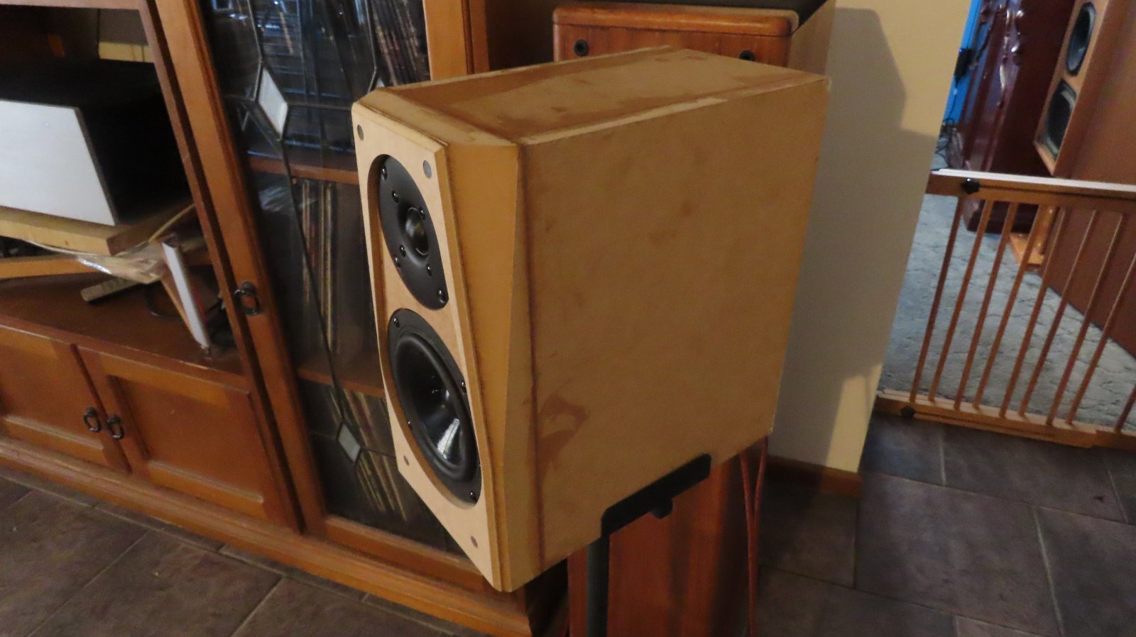

1090208628_SpeakerBuild(5).thumb.JPG.5bb8dec94a21ffa7d55049d1570aa7aa.JPG1562957345_SpeakerBuild(10).thumb.JPG.44610210f7990f624f640815d7987af3.JPGIMG_0106.thumb.JPG.b4b004b4ba3e395a68b06c2fca54e36f.JPGSave up a bit longer and contact Mike Lenehan (a member here and speaker maker) he has a kit bookshelf LK1 at around $1k.
I built a pair and they are awesome.
