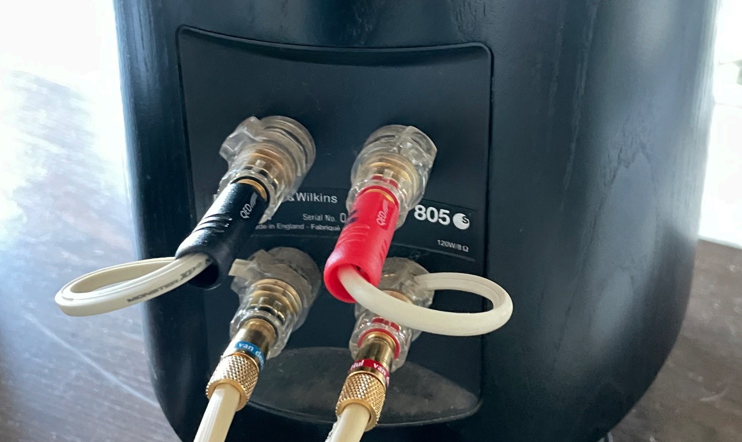

So, had been using Monster Bi Wire cable: L and R plus into front channel on amp, L "High Pass" plug to top L terminal on 805s, R HP plug to upper R terminal on 805s, L "Low Pass" speaker cable plus to lower L terminal on 805s and R HP plug to R lower terminal.  Thought problems with sound due to challenging room acoustics. Finally frustrated enough to removed one of the upper terminal speaker plugs: no difference to sound at all.
Then changed amps and cables. Ran cables in bi amped fashion using same amp: FL amp output to lower left terminal, FR to lower R,  FL amp 2nd output to upper Left terminal and 2nd FR to upper R. Sounded much better new amp, even better with a day of running in Van Den Hul cables. Then, tried removing plug at upper L terminal: no difference or loss of sound coming from speaker. Then plugged back in upper and removed a lower plug: no sound at all. Reveres amp outputs, i.e main amp outputs to upper speaker terminals, 2nd amp to lower terminals: similar sound and same issues: unplugging top terminals , no change in sound, unplugging bottom terminals : no sound.
Then change amp configuration back to single amp output: only sound output if connected to lower terminal.  Then added jumpers from lower terminals to top, as per B&W, and again nil change in sound when top plugs removed.
Now back to single amp configuration to lower terminals, I've left top plugs attached to 2nd amp output but not using . Photo attached.
Thanks.

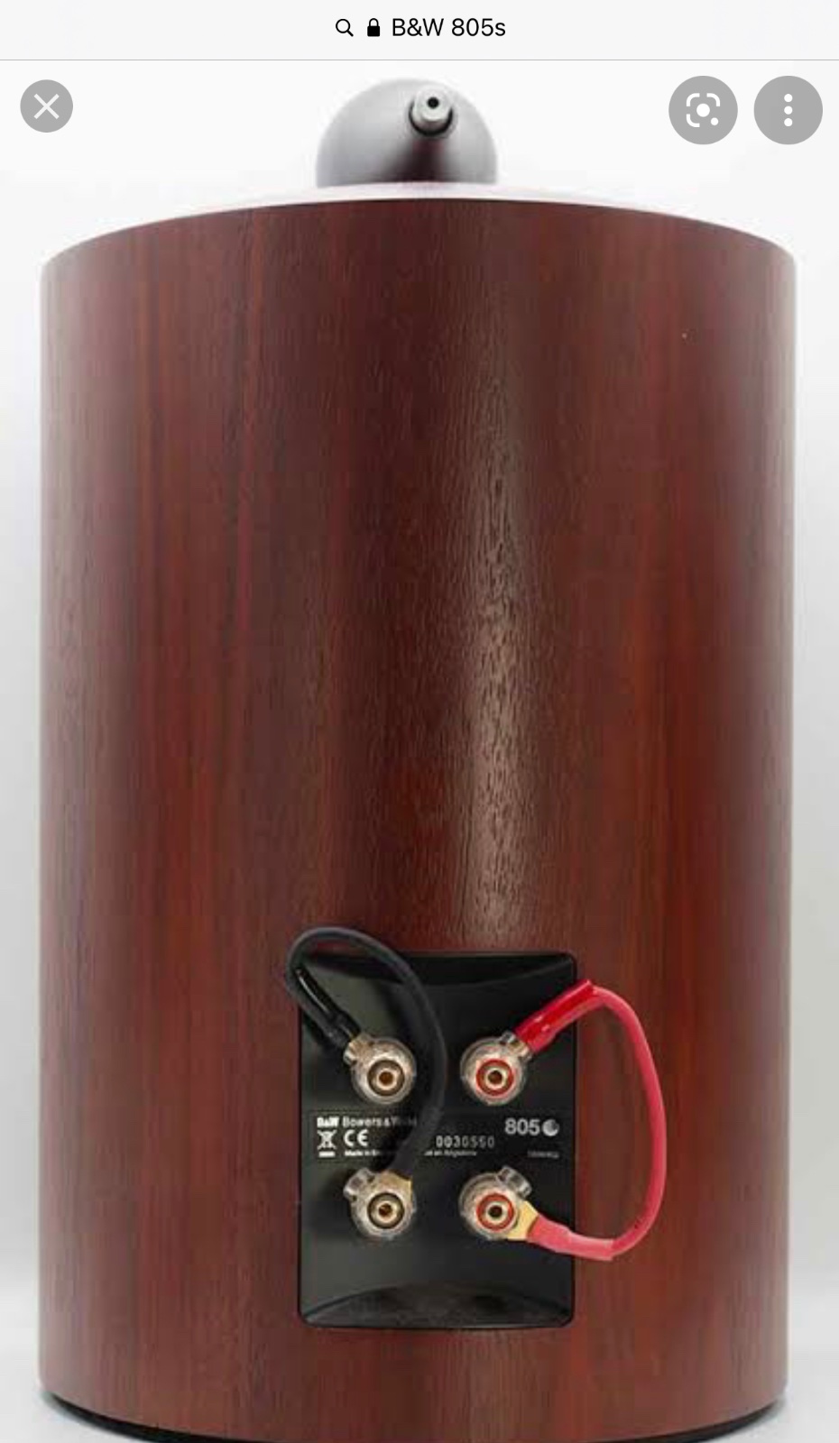

Photos would really helping and not just the speakers terminals. Something like this and how you connect to the amplifier with perhaps the front as well showing the settings since you using an Av receiver.

Thanks. Had trouble attaching previously.
Now driving through front L an R on receiver with my temporary jumpers ( original jumpers doing service with 685 speakers in man cave).
Updated receiver in our HT system, 9.1.2, and since started process have refound my joy for my music, so an enjoyable  step wise progression with a dedicated 2 ch amp down the line. I did want to try bi-amping with 4 Chanels off the Marantz first: 2 Chanels available and step wise progression as stated.805s.pdf
