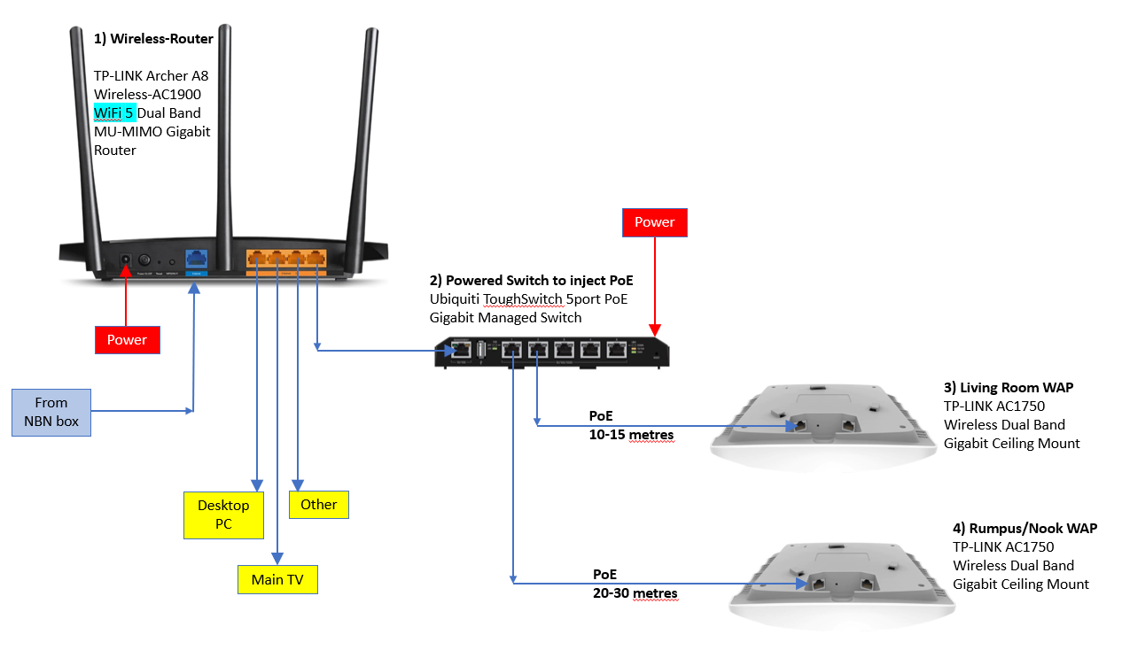

I'm thinking/needing to upgrade the wired and wireless aspects off my abode.  Could peeps with hands on experience in this area have captain at my sketch below and let me know if i'm on the right track?  or have i made some schoolboy errors?  I've illustrated specific components to make my thinking really visible but if any of these look like poor choice let me know why.
Btw I'm not super tecchie...they don't call me 2 bricks for nuthin...it's taken me quite a while to research this far...and unsure if the config/setup on multiple WAPs is tricky for a non-IT person?  I want to be able to set a few time/usage based rules for the WAP broadcasting but unsure if that will work with a switch between the router and the WAP units?
The house is single storey, and single brick for the interior walls.  NBN is FTTP and 100/40.  As i'm planning to hard wire one of the heavier users (streaming tv) and have no WiFi 6 devices for the foreseeable i'm thinking just to go with Wifi 5 for reasonable economy.  But open to pre-investing in Wifi 6 components if there are really distinct advantages...reliability? ...enhanced multi-tasking even with Wifi 5 devices? ...better wall penetration?
Ethernet cabling Cat 5e should do the job but probably better to use Cat 6 i guess.

I'm a bit short on hands on experience yet because I'm at a similar stage to you,  ie., planning.       Here more out of interest than offering any advice sorry, but nevertheless have some comments/questions.   .
Is any of the hardware you've listed existing.?
The TP Link AC1750 you mention are  wifi range extenders.   I'm pretty sure that's not what you want.  .    https://www.tp-link.com/au/home-networking/range-extender/re450/
probably one of these?
https://www.tp-link.com/au/home-networking/access-point/
I've been leaning toward the Ubiquit gear.      Apparently great perfromance from their WAPs and good user interface.       I got the impression they're very capable and configurable,  but also OK reasonably easy for non-IT people.     I'll be changing from Apple Airport Extremes, which are dead simple,  so I need something good for dummies.
My current plan is the start with a Dream Machine  (router + WAP) in central location and see if the better wifi signal from this one unit is good enough, then add more WAPs only if necessary.        Or,  the Dream machine Pro out of sight and a separate WAP (for higher WAF).
With  the right bits  I think you could do away with the switch.       Some ubiquiti WAPs have a secondary ethernet port which you might be able to connect one of your wired devices (TV,PC) ,   or to another WAP.   Passthough of POE may be an issue so best not take my word for it.   .

None of the hardware i listed/sketched has been purchased as yet. Presently i have only the generic "free included" wireless router than came when i connected to NBN two years ago.
Regarding the WAP's I should have labelled them as TP-Link EAP245 which are a ceiling mount clamshell type as sketched.  But i am also considering the Ubiquiti ones.
I could do away with a switch if i go to a router with 8 LAN ports.  But i would still need PoE injectors or a local power point (with wall wart) for each WAP i believe.
And I want individual control of each WAP so i'm thinking to not have any connected in series (pass through) unless i can still manage/place usage rules on individual WAPs e.g. the ones broadcasting signals to XBox and the like.

On 20/05/2021 at 8:26 PM, 2Brix said:
I need to learn some more about managed vs unmanaged switches..
1. You don't need a managed switch.
2. You don't need the AC1750's.
3. Disable the wifi in your router.
4. Buy a used Pakedge W6 access point (maybe $20 on eBay), put it in the middle of the house, run a Cat5e to the router, configure it and you're done. Unless you live in a sprawling mansion this single AP will cover the whole house.

You can forget wired, I did, and never looked back.  Used a wifi mesh system,  and I get at nbn FTTC 100/40 everywhere in the house.  Best thing I ever did, even though I have run 300mtrs of cat 5 in the house to every room that we roughed in during the build but never used.  And yes we run wifi to the smart TV with Netflix 1080

Many thanks for the replies @brodricj and @Addicted to music
Actually yesterday while out at the shops i just grabbed a new AC modem (ASUS RT-AC68U) and hooked it up this morning.  Setting it to broadcast Wifi at 2.4GHz only seems to be providing enough range and bandwidth.  I realised i had previously some users at the far end of the house connected on 5 GHz and that had been p*** poor.  But connecting those same users on 2.4 GHz it's pretty good.
I'll live with this for a few weeks and then probably get an unmanaged switch to give me extra LAN ports and run cabling to the heavier users (XBox and streaming TV) and also to the far end of the house for connecting a 'hard wired' mesh node.

You don't need a 2nd router. You should only have one router on the network. If you have a dead spot, crank up the output power of your AP, or change its physical position. If that doesn't cover the whole house, get a better access point. Or buy a meshed WiFi infrastructure, but that will be the more expensive option. You don't want to have multiple access points each with different SSID because you won't have the convenience of seamless roaming.

If you want a mesh solution with decent radio management and inbuilt security to control your kids access, this is well worth a look: https://www.plume.com/homepass
I would still wire each one to the wall from a central switch but the ease of deployment and radio smarts in these is fantastic.

OK, to wrap this up unless I'm missing something. When you say you're buying another router I take it you mean you're buying another access point, and your new router has a WiFi management agent function whereby you can mesh a number of access points connected to it.
However if you really mean you are buying another router, I'm not sure how you'd go about meshing access points connected to different routers. There really is no purpose in doing it that way, if it can be done.
