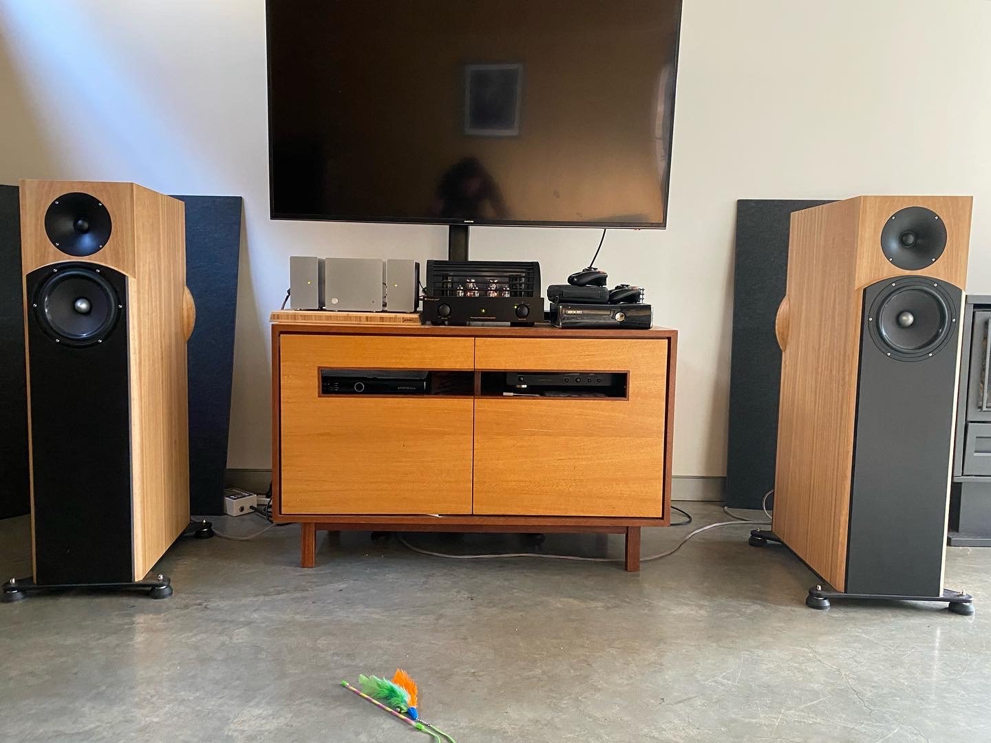

I am after amp suggestions to run my Troels Gravesen DTQWT mkQlll . http://www.troelsgravesen.dk/DTQWT-mkIII.htm
These are listed at 94db and 4ohm so power should not be an issue. I am thinking solid state with a budget somewhere around 5 - 8k. I am presently running chord cutest to PrimaLuna Prologue pre and Cawsey 15 class mono blocks. I have also had a PrimaLuna Prologue power amp in the setup.
- General listing volume around 70db
- Room size 6m x 10m
CameronB40F1E33-E849-4639-B2AC-06048C9F28F3.thumb.jpeg.206e7efd64125c6872dd3360ac13f75f.jpeg

OK so I finally picked up The Pass Labs XA 25 I am absolutely loving it. Sound getting better as it burns in I have around 25 hours on it at the moment. Amazing detail and tone the bass seems to be getting better after every listening session, tighter deeper and less flabby. I am noticing low bass rhythms  that I have never heard before. It may be the lack of any distortion but I seem to be playing louder to get the fullness in the mid range. It is so open and airy  that I am getting no complaints from my partner that I would usually get playing at these levels.
Waiting far a few more weeks then I will start playing with the different chords I have to see what improvements I cam make.
